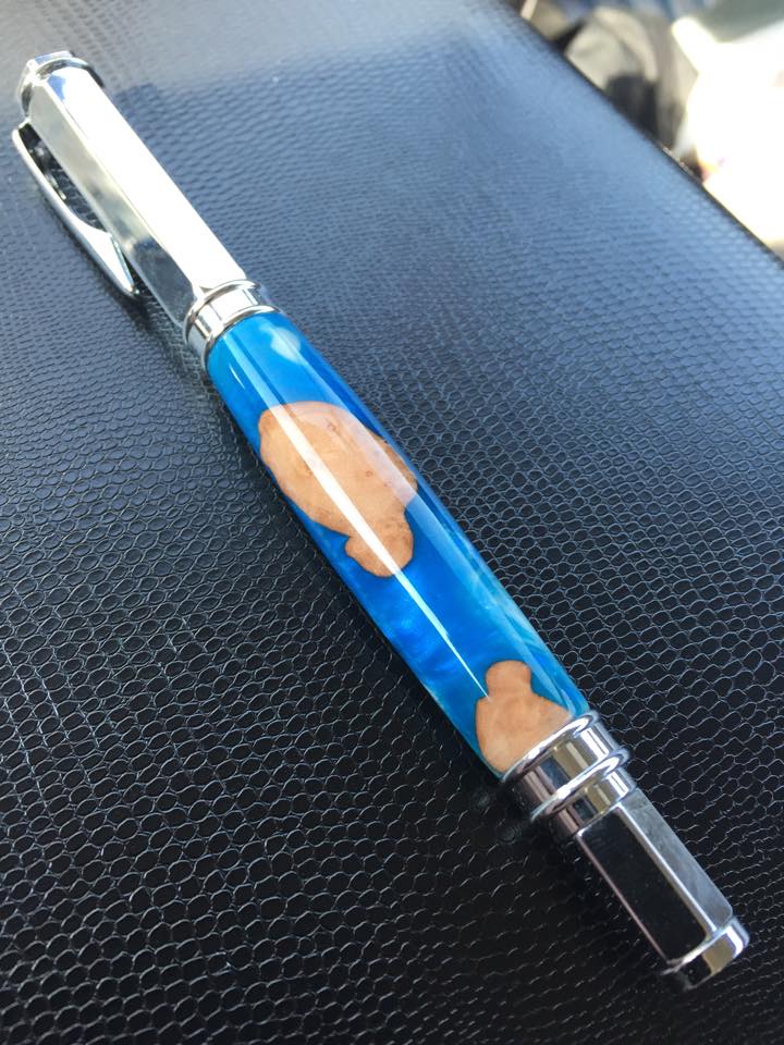

Beautiful pen!! It would be great if you posted more!! So... Since your promoting the finish, would you share more details? What CA, do you use accelator, etc?

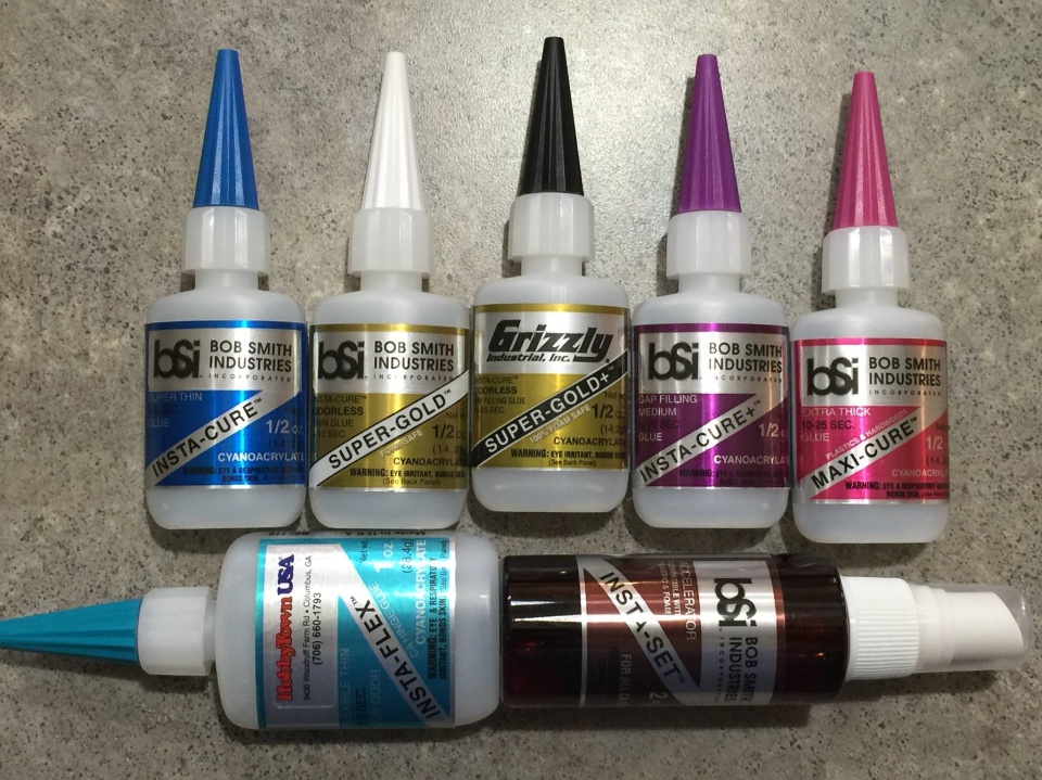

Personally I use Bob Smith Industries Super Gold+ Medium. I found if you sand smooth (typically with #600 then with #800 Abranet followed with #2400 or so auto sandpaper (wet) then polished with Novus #3 and #2 it is extremely easy to get the glass looking finish. That is my method, happy to share because we all want to better the industry and help each other out.
Here is a link to the CA I use:http://www.amazon.com/Super-gold-ga...F8&qid=1435464829&sr=1-1&keywords=super-gold+

Here is a link to the CA I use:Amazon.com : Super-gold gap filling 2oz Bob Smith Ind. : General Purpose Glues : Office Products[/QUOTE]
And this is the accellerator I use: http://www.amazon.com/Bob-Smith-151...sim_229_1?ie=UTF8&refRID=1HMCTJSGPQ7GDYFJEF30
The Ca is pricey, honestly I find it to be worth it because of the quality of finish it provides. Everyone I have showed it to in person has switched to it, no questions asked. If someone hasn't tried it I challenge you to give it a try. What's the worst that can happen? You find out you dont like it and you have some great medical grade super glue to seal up wounds with for the family... I have closed up several scrapes with it. It doesn't sting like other glues or even the liquid skin stuff. It doesn't melt styrofoam either. It is a much less abrasive glue. Great stuff!

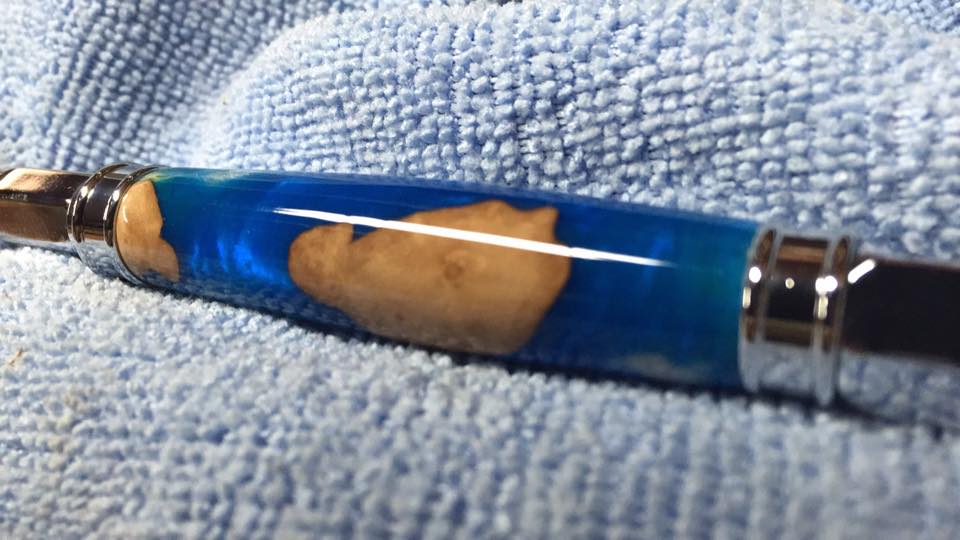

I use Hyperbond thin flex CA and accelerator through various layers.The finish on this pen is about 3-4 thousands thick,wet sanded 2000g buffed with Dico PBC.
It works beautifully for a finish.

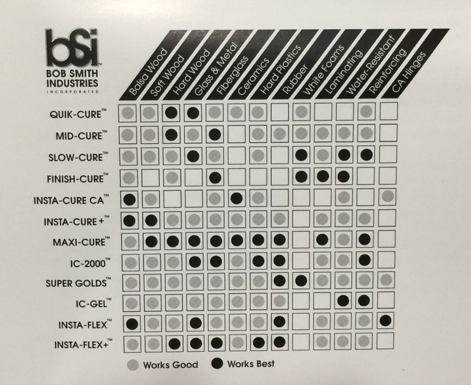

Jeremieh - I'm not doubting your results, just trying to figure out how to know its a "flex" product.
Dean, I'm not sure and I could be wrong but the chart shows the Supergold best for rubber and good for hinge. I would guess that's a flex CA

It is listed as a flex. Super gold is odorless because it is methoxyethyl. Look at it as insta-flex with additional stuff in it. Super-gold is the flagship product. Nor is it cheap bu I can show you, in person, the benefits of it's use.
I know it's a flex because of 2 reasons. A) I have used it and verified it myself and B) I called and spoke numerous times with the company about their products. Also with their help and locktite's help I have a good write up on several topics: Shattered glass effect, accelerators, CA cure process, etc.. Also if you look on their gallery page guess who's work you will find there under the 'art' section. BSI Adhesive's Photo Gallery
