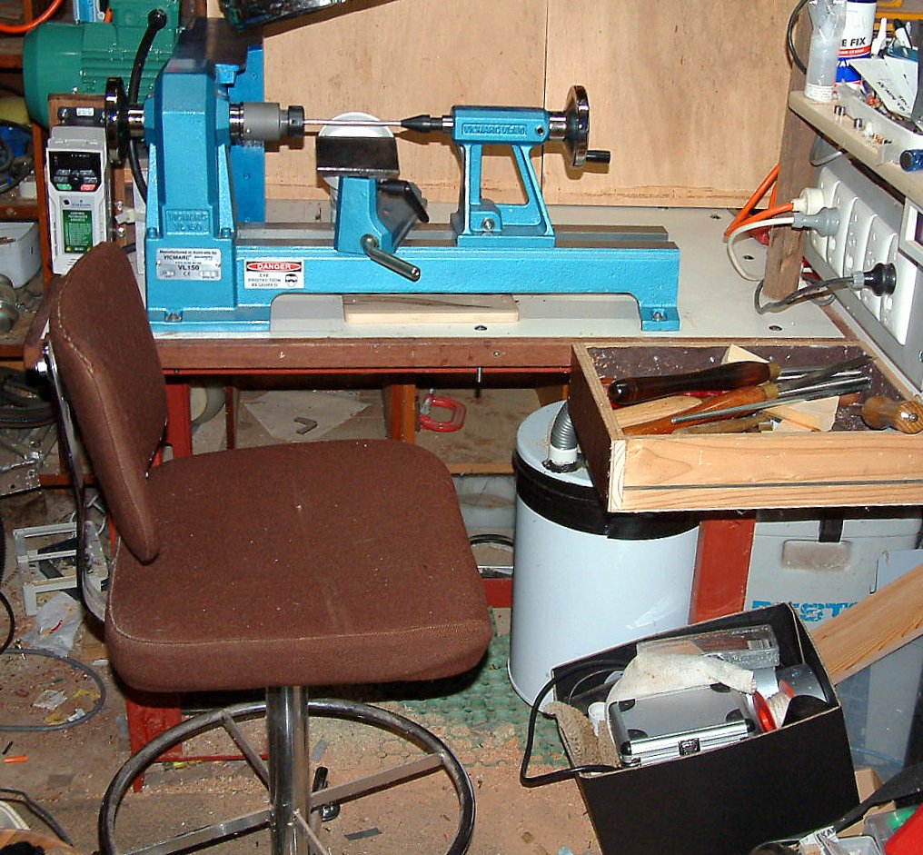

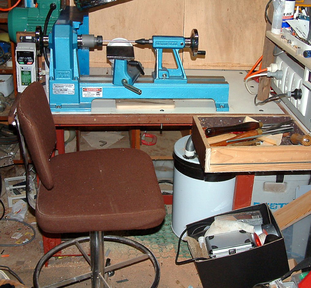

I sit from choice for perhaps 30 yrs. I only turn pens these days am 6foot 2 inches. I welded the desk to enable the lathe to be driven through the headstock to a Variable Speed controller in other words nothing under the bench to bite,maim etc I sit on an old draughtsmans swivel at a height above the lathe,comfort means I can turn all day in comfort using the circular footrest. A rough old pic when I installed my Vicmarc VL150 lathe to give you an idea. Now 86 this yr with poor foot circulation it still is great for me.
Kind regards Peter.
