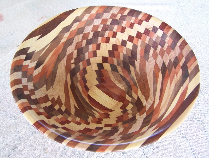

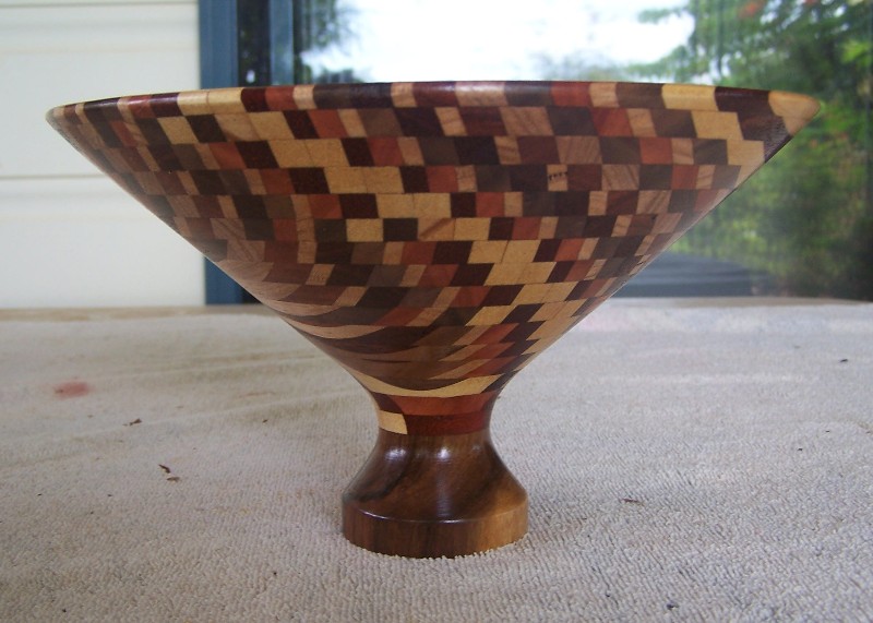

This is my second attempt at one of these dizzy bowls.
A lot of fun but still not quite right. Better luck next time they say.:smile:
It is 8 1/2 inches wide x 5 inches tall. Sanded to 420 and finished with Shellawax Glow friction polish.
There are lots of pieces in this ?????????
Timbers used are;-
Jarrah, Pine, Queensland Maple, Tasmanian Oak, Padauk, Walnut and the base is Snakewood (Acacia ???)
Hope you like it and thanks for looking.
C & C welcome.
Bob.:smile:

OK Bob I give up. Are you willing to share with us the problem that is not so obvious. You can PM me if you would like not to post it here. But I am curious:smile:

John, my bandsaw is not big enough to cut through 8 1/2 = inches so I made the block in two halves, sliced them and then joined the rings together.
The problem was that one part of the block was about 1/8 in wider than the other, so the pattern doesn't line up properly. One side is really good and the other side is not staggered evenly. The photo shows the good "stagger", so if you look closely at the front side (inside) you'll see that the stagger is uneven.
LESSON, both halves of the block have to be identical.:redface:
Hope this puts your mind at rest. :smile:

Thanks Bob. I think because of the pattern being so wild the eye is tricked to overlook these things. You know where the problem is being you put it together. But sometimes we are our own worst critics. Still very nice work. Thanks for showing.

Never tell anyone your design flaw... you intended to do it that way. :cool::cool::biggrin:

I agree Chuck, but that's the trouble with making stuff, you know what is hidden. Worst part is most people would never see the fault, but you know it's there, and in your eyes it sticks out like dog's *****.
