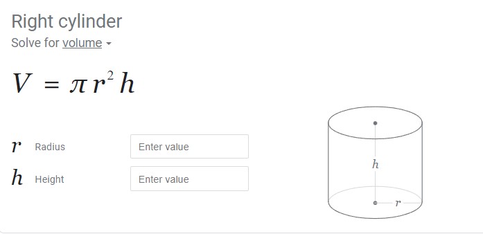

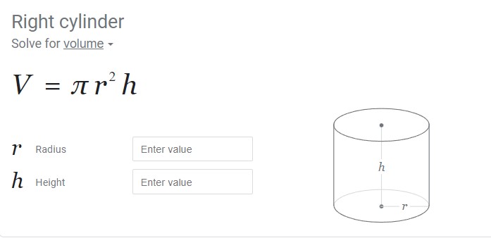

I would suggest calculating the volume of a cylinder
Volume = Pi x Radius Squared x Height) - do this for both vacuum chamber designs - for the height, you can plug in the height you plan to use (example 7" for pen blank with liquid covering), not the height of the vessel.
I did this to compare my 4" diameter Cactus Juice vacuum chamber and a 6" diameter chamber I picked up at an estate sale. To cover eight 6" blanks with cactus juice (so 7" of liquid) in the 4" chamber would require 88 cubic inches (1442ml). To cover eight 6" blanks in the 6" chamber would require 198 cubic inches (3245ml), or more than double. Of course, you can fit more blanks in a 6" chamber, but I don't generally stabilize large quantities at a time, so I opt to use the smaller chamber. I got a really good deal on the larger chamber, but it's expensive to operate.
