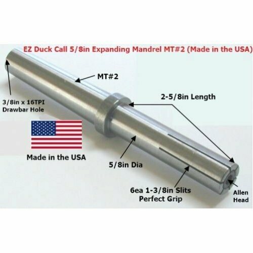

I like the one from chef ware kits below. It is the one I use when doing demos or just making calls. It does not require anything extra to use other than hex key for screw. The mandrel holds very well and the body of the mandrel is smooth so it will not scratch up or damage the blank. You can tap it into place tightly with a mallet, compression from tail stock or even use a threaded rod if you really wanted too. I will use the tail stock to tighten it all down when rounding the blank but pull it away when shaping.
Chefware sells different sized mandrels for different calls and I find their design to be better overall. Over tightening on any of them can crack the blank though, it is really frustrating to say the least when that happens. Great mandrel, I get the duck call inserts from Echo Calls.

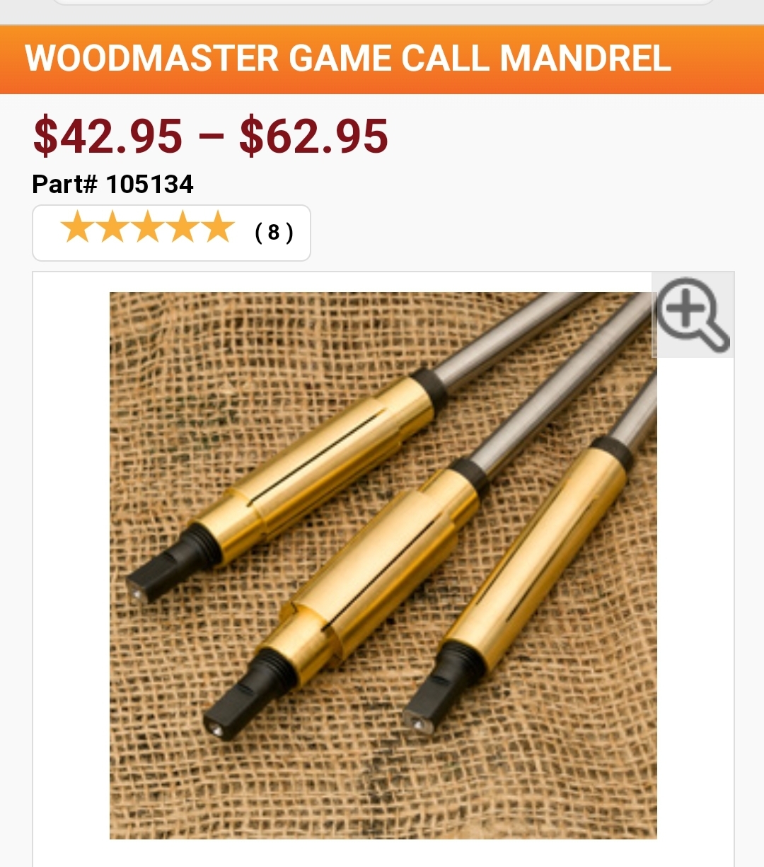

Well it looks like everything I've searched, including the links above, all are sold out. I went ahead and just ordered one of the woodmasters from craft supplies that I pictured above. I like that Brookside that dogcatcher showed and may keep checking back for those to get in stock again. The woodmaster should do me for a little while anyway. Thanks for the help y'all!

So just an update. I got one of those woodmaster mandrels from craftsupplies. It works good but it has one major con for me. I want to be able to loosen the mandrel so I can bring the end of my work out and be able to detail the ends. With this needing to use a wrench to tighten, it makes it unable to work the ends. Gonna have to find some thin flat pliers or a flat tool of some kind to be able to reach in and tighten.
To add, tried a small pair of needle nose pliers that will work.
