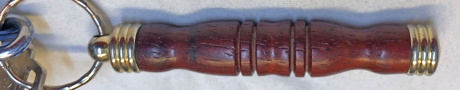

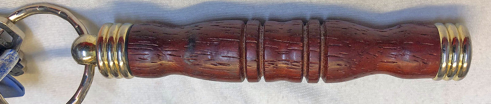

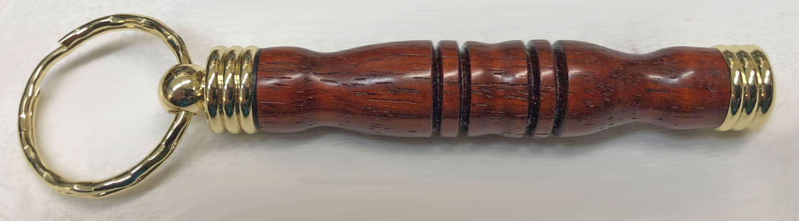

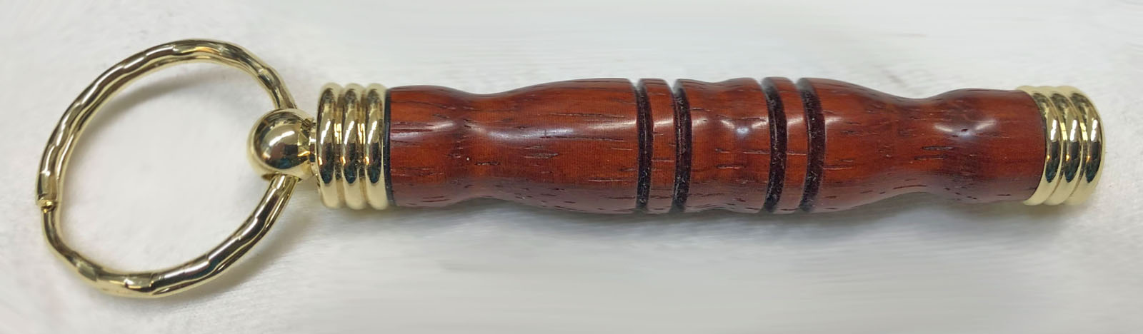

I have had good success with Doctor's Woodshop products applied according to the processes presented by the Doctor in this video on YouTube. I have a personal carry Padauk keychain with big open grain that I finished in January 2022. Of course it show's it's age as it is a little darker, a little less shiny, and the grain looks more pronounced (maybe partially due to the lighting), but in general it held up pretty good considering it has been carried around for more than 2 years.
Here are some pictures comparing it when it was new in January 2022 and how it looked in March of this year - so 2+ years of almost daily handling.
Regards,
Dave
January 2022
March 2024
