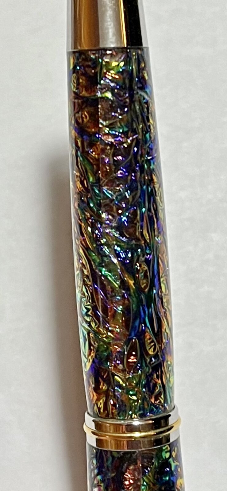

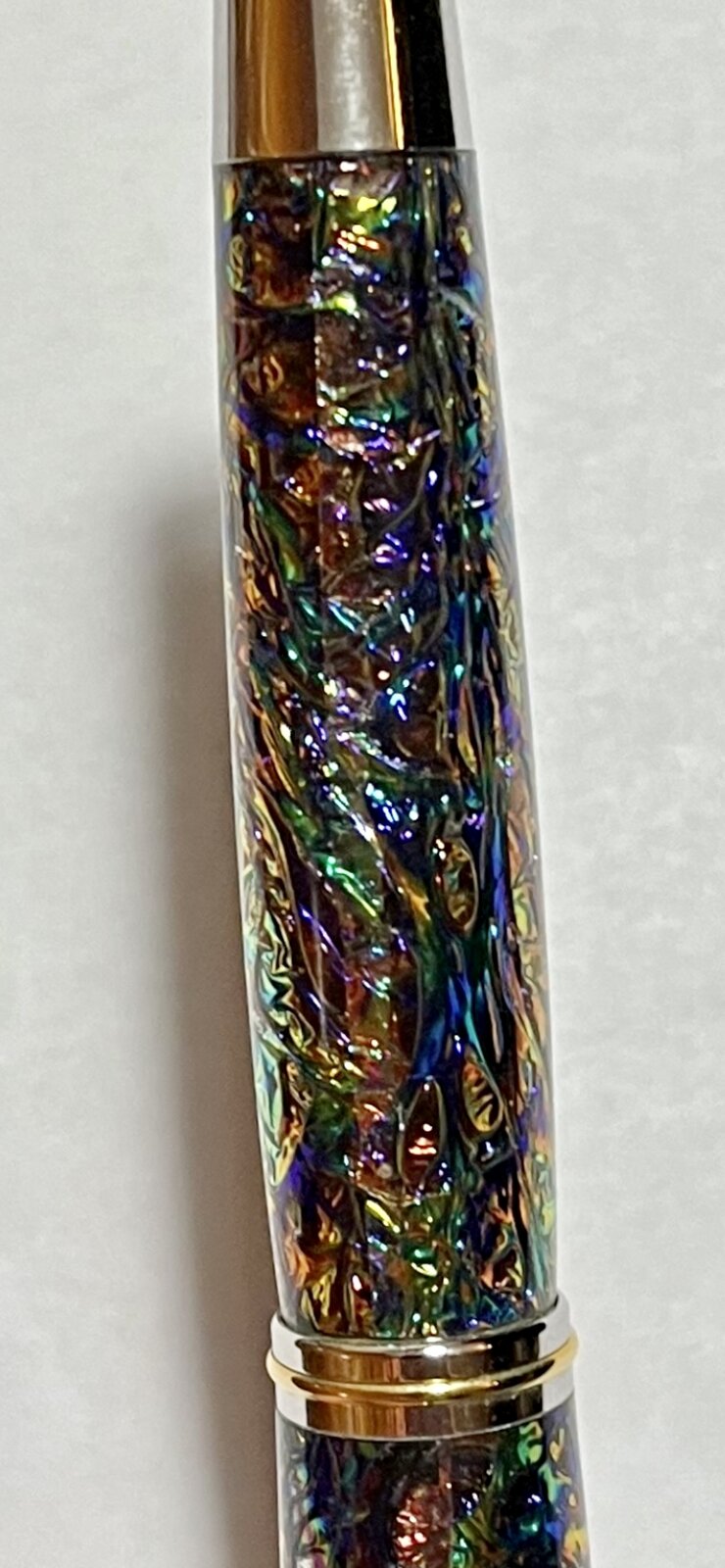

I use it every so often. It's not hard to use, just time consuming and hard to hide the seam. I always do my best to make the seam invisible. It's expensive… about $125. a square foot. I mostly use it on Jrs and larger because it needs to be a higher end pen to justify the price. I've used it on Sierra snd squire tubes. I never had the need to use it on anything smaller than 3/8" dia. Can be tricky to cast. Unfortunately they don't all turn out, but that's casting.
The second picture is the seam.

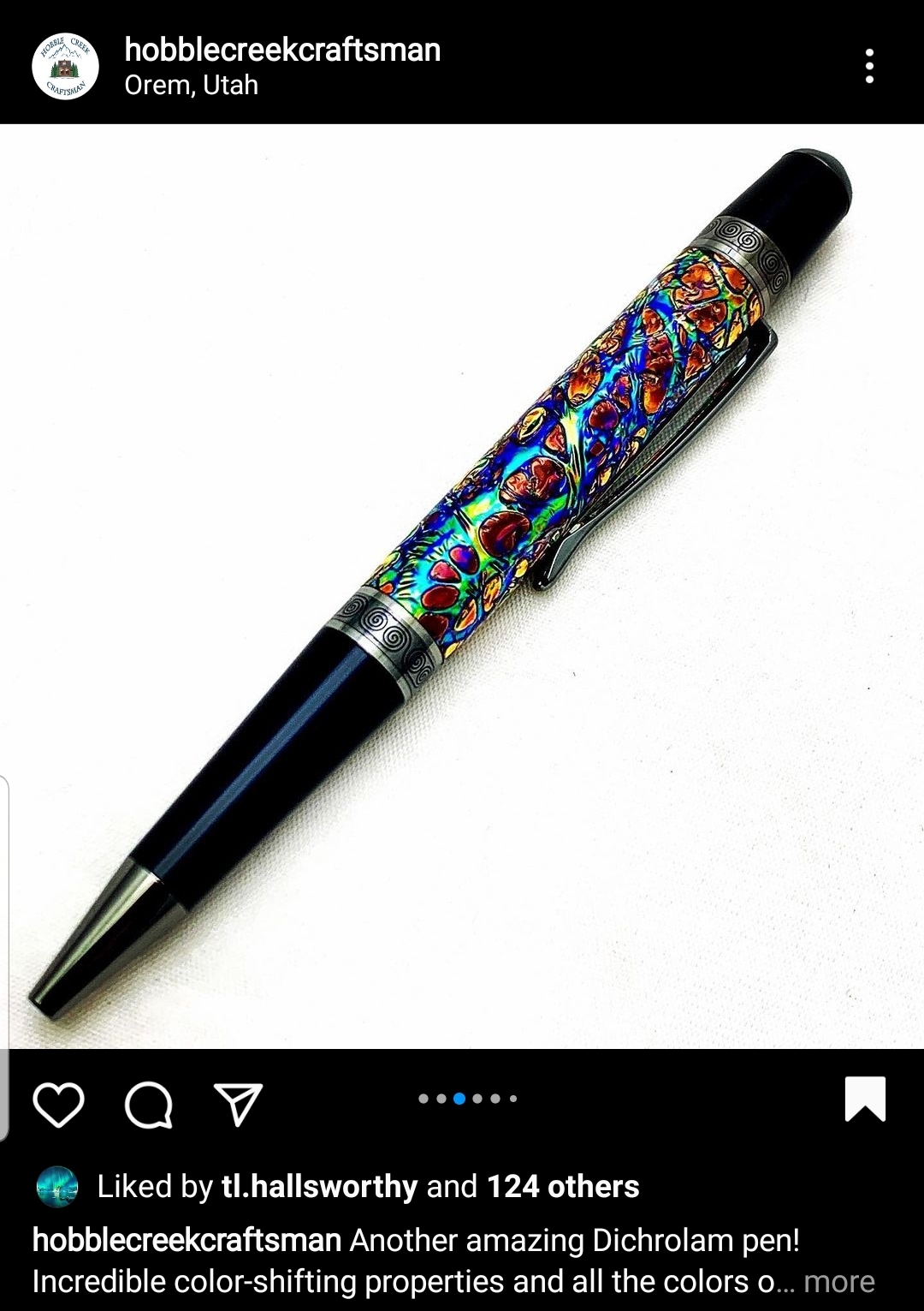

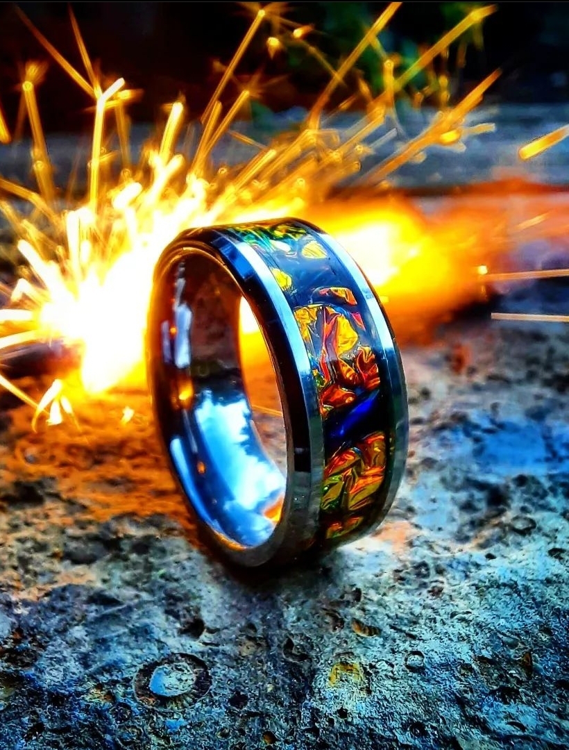

FYI - I supply the Dichrolam with a peel-n-stick adhesive on the back which makes it pretty easy to wrap over a core tube of any diameter. You cut a pc that is slightly longer than the circumference, then over-wrap a little. Then you cut the new seam with razor and straightedge through both layers. Then slightly peel back the overlayer, pick out the trimmed waste, then stick for perfect seam. The visual "busyness" of the dichrolam hides the seam, then the resin hides it more. Masking protects it all from fingerprints, but if dirty, then alcohol cleans it easily.
Casting isn't too hard either - bend a pc of PET clear film into U channel, seal around tube end with silicone or hot melt, then pour epoxy or Alumilite. Brush bubbles off surface while liquid. Cut cured resin into octagonal cross section, then turn.
This system works on long tubes to cut down into multiple pen blanks.
Oh, and BTW - don't think of price per sq ft, but rather per sq inch. Only a few bucks worth per pen, for something more visually stunning than boulder Opal which is over $10,000.00 per sq ft, because Dichrolam is optically identical to Opal.
