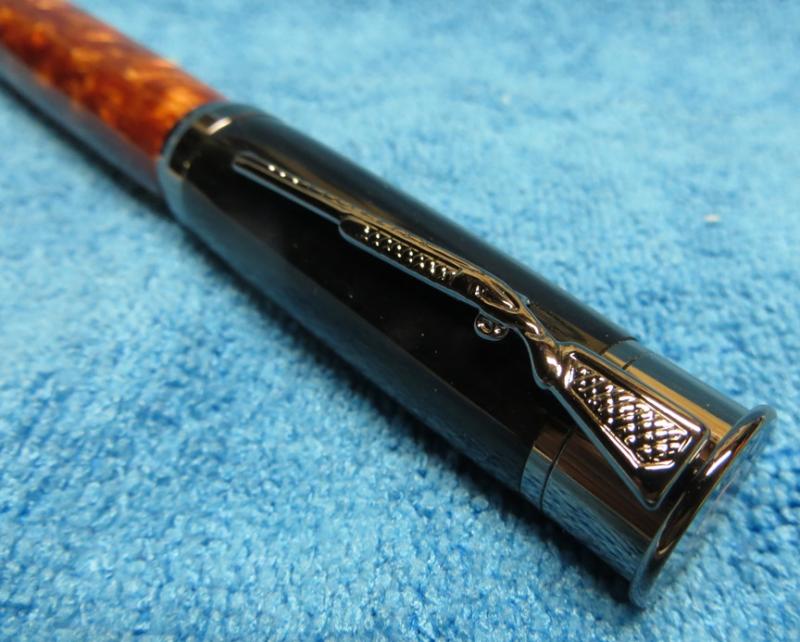

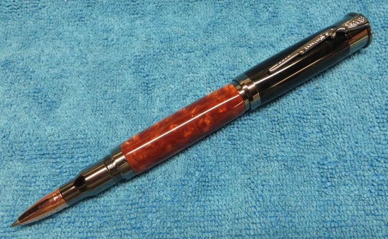

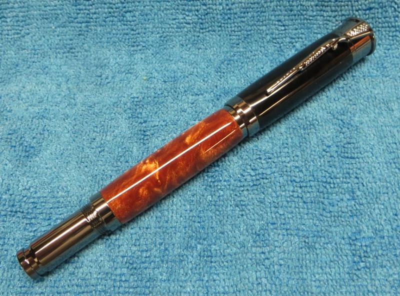

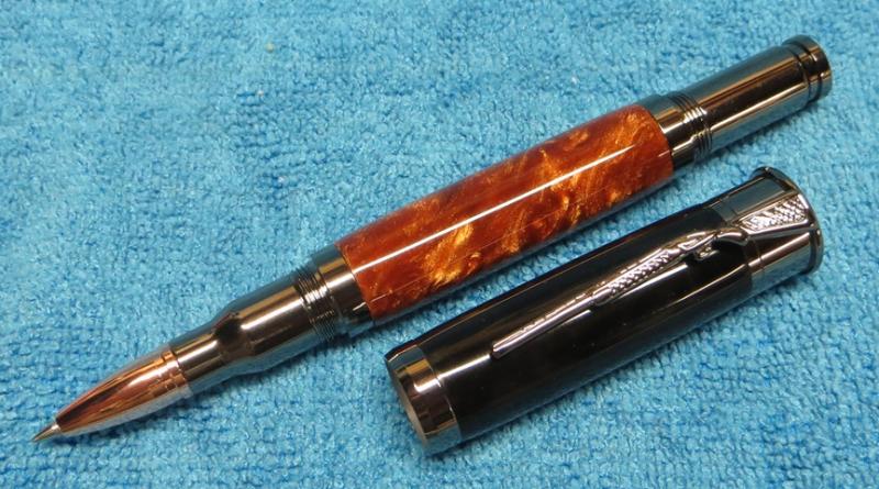

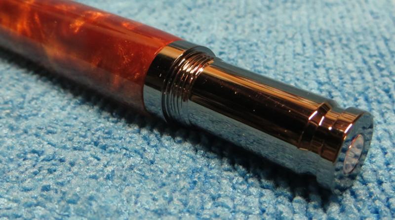

how large do you really want>?
If you're referring to the Over/Under pen, it does require a large blank. I had several failures drilling acrylic for the upper (9/16") blank. I think I ended up using a Rhino blank, which is 7/8". If you're not very experienced, I highly recommend using 1" wood blanks.
