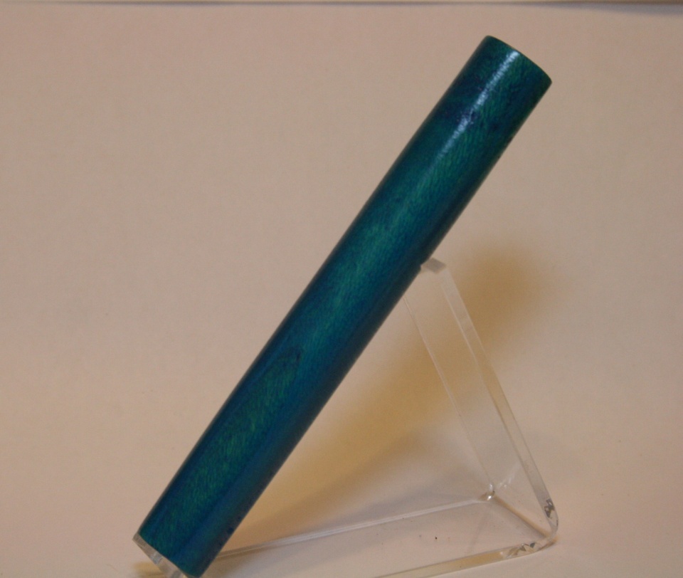

Dan, I have not tried food coloring, but do use a alcohol base dye. I get it from A.C. Moore's (like a hobby lobby) 3 bottles to a pack. I use it just like i do a CA finish, no mixing, straight out of the bottle and dribble it on the blank as it is turning with a piece of cotton cloth on the bottom of the blank rubbing it in on low speed. Now back to your food coloring, i would try it straight first on a scrap blank straight out of the bottle, then maybe mix just a few drops of DNA with it to see which way is best and to your liking.

George did mention something i forgot. I do turn my blanks to final size then dye the blank.

If you are trying to dye blanks for your own use, save yourself some money and lots of time by, simply dying the turned barrel when gets to finished size, it takes 30 seconds using a bit of cloth and the dye/colour, burnishing it against the wood, the friction heat generated, will dry the little wood the barrel has.
If you want to be sure, use a heat gun or a hair dryer to dry any moisture from the dye, burnishing it will leave a smooth finish so, you can apply a couple coats of thin CA before you touch it with any fine grit sand paper, the rest is done as any normal CA finish...!

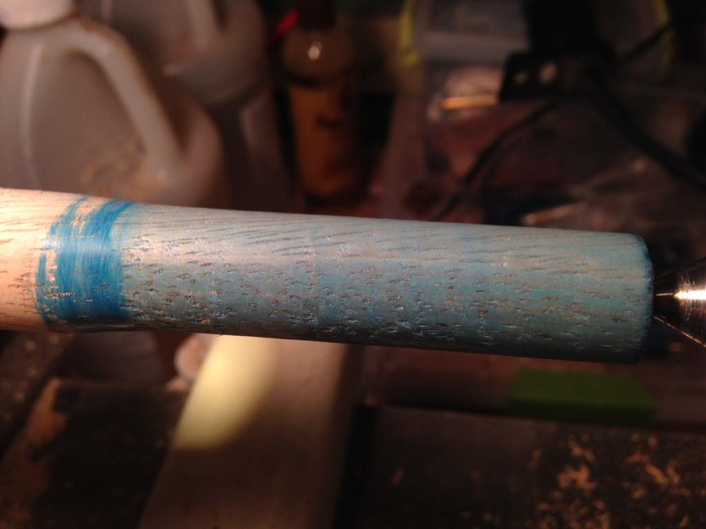

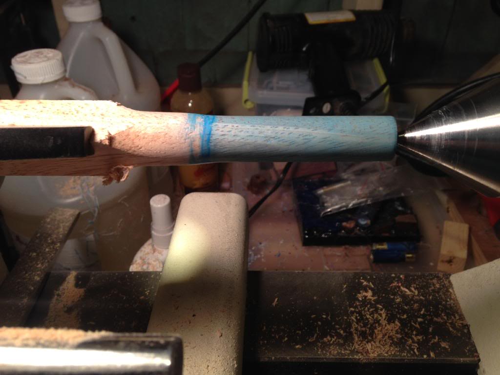

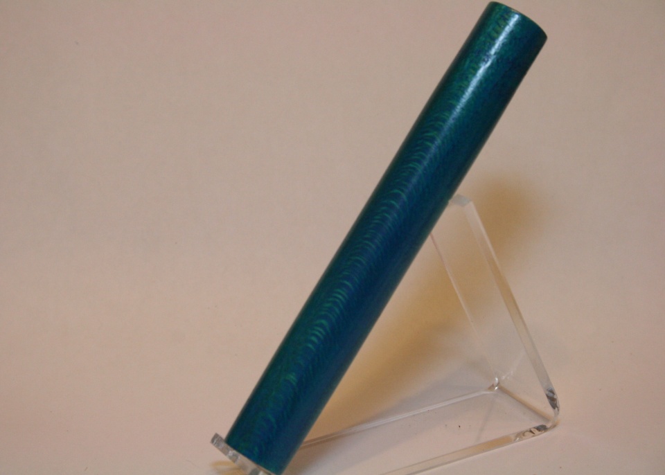

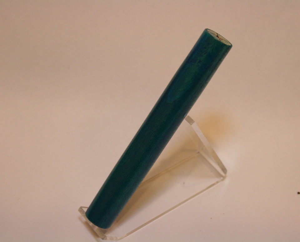

Thanks Harry. I'll try to find it. I used gel food coloring and DNA on this blank and few coats of WTF. I guess I should have let it try longer (I'm not sure how long to let it dry) as I got some blue come off as I put on the finish. I'll turn this blank down some more them I'm going to try some oil base artist paint next I'll try it straight out of the tube to see what happens.
When i get done with mine, i will let the blank spin a bit while rubbing it with the cloth. I also get some dye to come off on the first 2 passes with ca, but after that it's good. Not sure of the results using WTF or anything else, i've only used ca.
That blank looks good though.
Harry

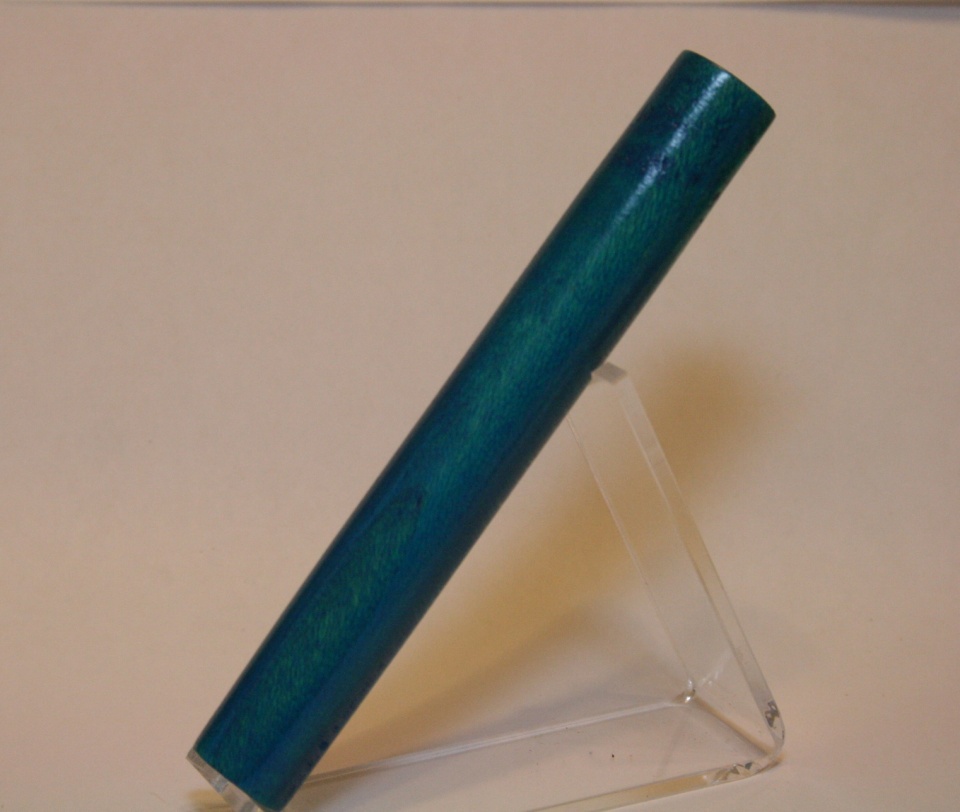

Well, no such luck with the heat set ink/embossing powder. It may be this bland blank from my 30 pack of WC slimlines. I shaved that stuff off and went with a heavy coat of tempera paint, let it dry some, wiped off and burnished with saw dust. Below is the result:
It's not too pretty, but on a burly blank may look nice. I suspect that when finished with CA the color would hold up until the CA cracks.
Now that I've seen a larger photo of my work, the blue is really blotchy!
This photo may be a bit better:
