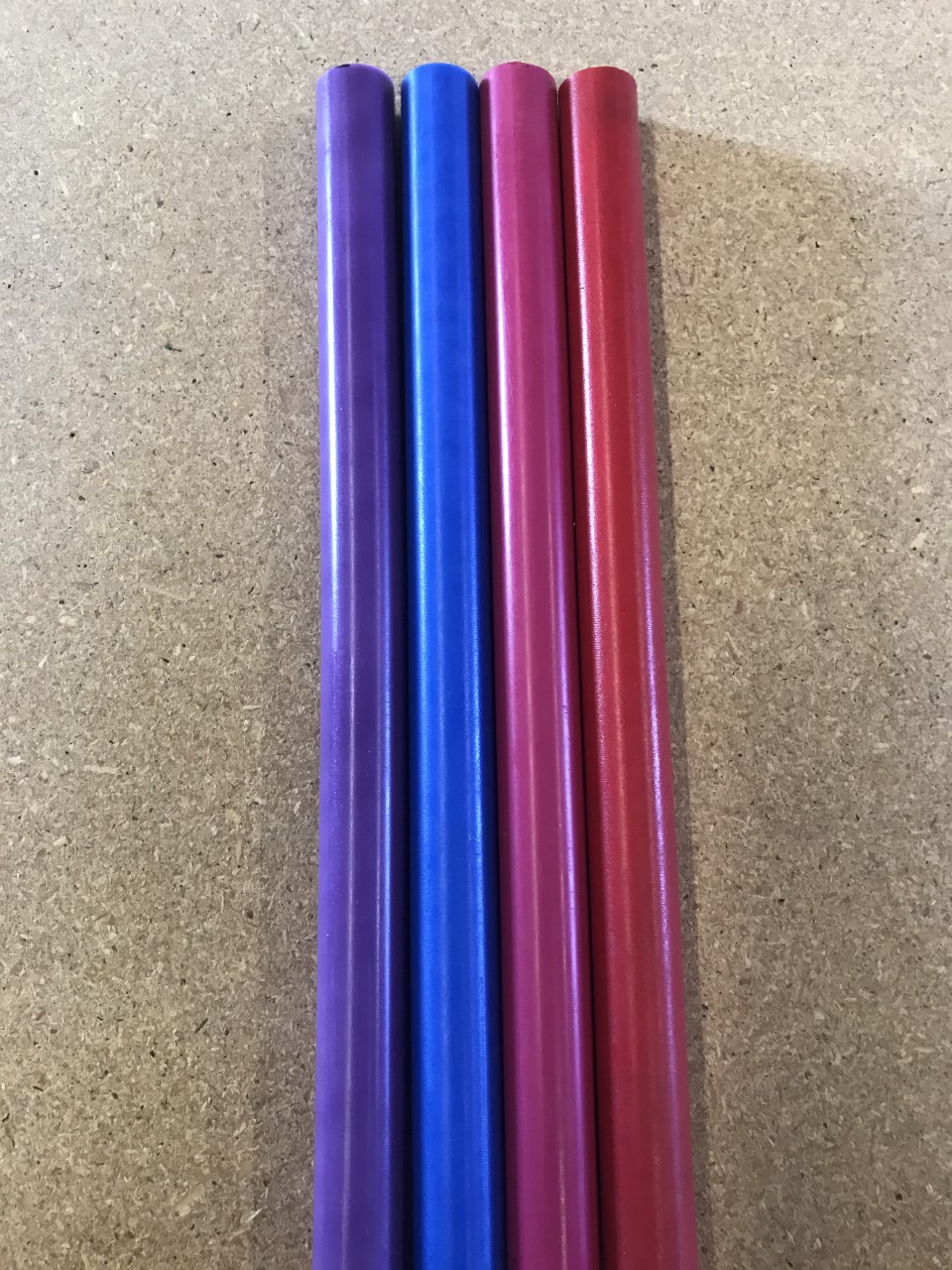

I have a large quantity of Delrin/Acetal in 3/4 inch sticks for sale
$8.00 per foot plus shipping
Purple marbled
Blue
Pink
Red
