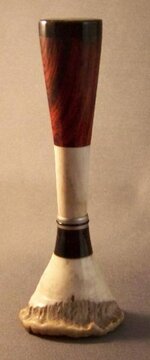

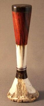

To clarify, is what you have the butt end of the shed antler, or the actual skull bone with the antler attached? Technically the pedicle is part of the skull, where the antler growth begins. The external, bumpy round part of the antler is the burr. Anyway, if it is just a flat round disk, the burr makes a very cool looking recepticle for the point of a pen when the other end is supported by a pair of crossed tips or a forked antler on a desk stand. If it is big enough around, and long enough, I sometimes turn it into the cap section for a desk pen. In either case, If you can't figure out a good use for them, I'd be happy to trade you out of them. PM if interested. :)
If the antler is still attached to the skull, I always try to saw away enough of the skull to turn the entire section into part of the pen, showing the "skull line" all the way around the blank. I usually double the price of a pen if I can get a complete joint line to show up prominently.

My experience, knowledge and expertise on deer anatomy and physiology is mostly limited to which parts taste better fried vs which parts make better pens. I did a quick search to verify my frequently faulty memory as to which part is which before I posted too. Links to follow.
In any case, I do know knife making, and somewhat less so, penturning. Knives made with whole antler beams, with or without the bumpy end section are usually called "hidden tang" or "stick tang" knives, as opposed to "full tang" or "flat tang". The tang is often little more than a stub an inch or so long ground into the back of the blade behind the shoulders for the guard. This is usually attached to a bolt or rod via drilled holes and pins. This bolt or rod is usually either epoxied into a blind hole drilled from the blade end of the handle blank, or (in better knives) bent so that it can be fed through the whole handle and secured with a nut on the butt end. The decorative buttcap can either be epoxied on to cover this nut, or (again, preferably) welded on to it before the nut is tightened down. Epoxy or other material is still often used to backfill the hole.
Here's a couple of pics of pen applications.
and a couple of links for the curious.

Jgrden
Mar 27, 2009
6,287
hOUSTON, Texas
WOW. I like those pens that are part of the BURR. They are slick. I fully agree with your anatomy of an antler and what I have been saving, is the BURR. I don't cut into the skull. Thank you for bringing this to my attention. I need to contact a view of my clients and explain.
