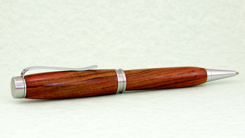

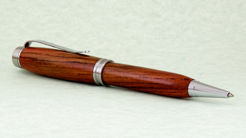

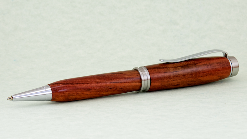

This is a piece of Dead Finish I milled last week, on a bit of a FrankenPen.
Its got a Slimline chassis, with a homemade 316 stainless centerband and finial cap, and a Cigar clip.
I think it needs the proportions refined a bit, but I think it has got potential.
The upper barrel is too long I think, maybe 5 or 6mm shorter would make a difference to the overall look.
Critique welcome.

I really like your "Frankenpen". I think you're right that the upper barrel is too long. But you might also use a euro tube for the lower barrel to add some length.
My only criticism (and a small criticism) is the slimline nosecone. Maybe a funline nosecone would be a better fit with a smoother taper. Or do a custom nosecone out of the same 316 stainless that compliments the centerband.
But overall, I do like the pen. I think the centerband is outstanding. :good:

Really like the center band and finial along with the cigar clip. A cigar nose may be the right answer, also, as the slimline seems to skinny/ abrupt for the rest of the Pen. I would guess about a 1/4 inch shorter on the upper half (about 6mm) or maybe shorter by the width of the center band you used.
The top and bottom barrels do not seem to fit together. The top looks to be a cap that is removable to cap the nib end. I would adjust the diameter of the top and bottom so they are equal. Then I believe the lengths of the 2 parts would not be an issue. That center band is a real keeper, simple and effective, makes the pen look like a classic vintage ballpoint.

Cheers MrD. Probably a bit too much trouble to adapt a cigar nosecone to the 7mm tube, would be easier to manufacture a new one . I like your suggestions though, I think they would go a long way towards solving the issues.

It was my intention for the pen to give the impression that it had a cap. The whole design is a bit off the mark, but is was just a bit of an experiment to try while I had a bit of spare time.

I think your design, with the larger diameter "cap" is extremely good ... NOT off the mark at all ... except the "cap" just might look a little bit better if shortened slightly ... and a custom nosecone would be nice ... you could then enter it in the BASH kitless contest !

The other one is a keeper, I like it. The look of the removable cap idea had not crossed my mind, for some I think it would work, but old people like myself would continuously keep trying to pull it off to cap the nib nd,

Thanks Mal. I really think if I was to go to much more trouble, I would be designing it to take a Parker refill. Will have a think about my next move.

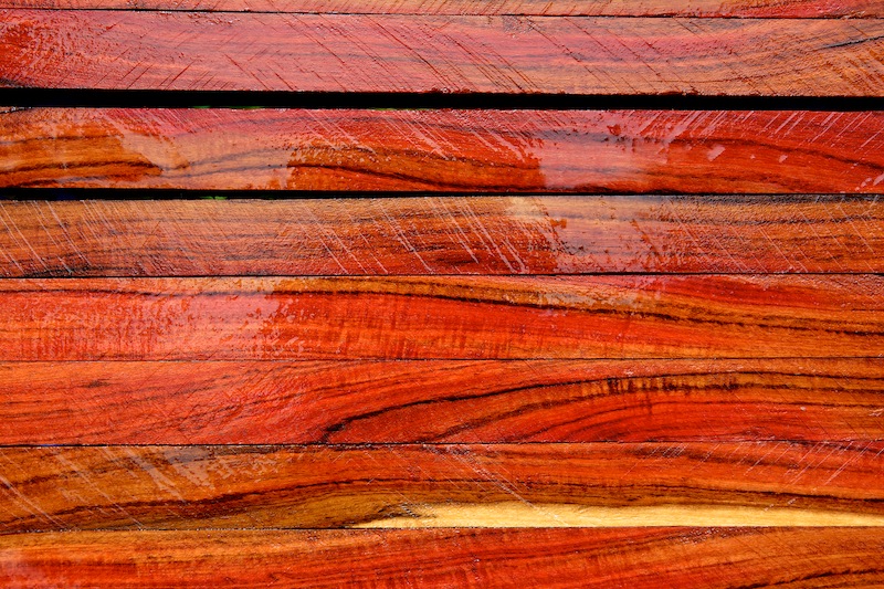

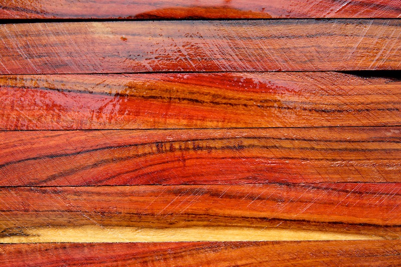

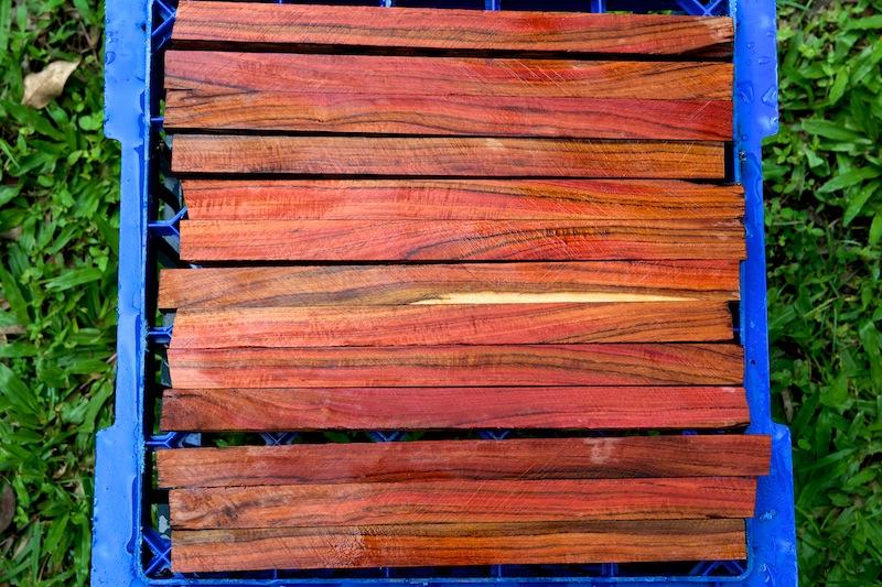

Here are some of the blanks I cut up this morning. The blank used for the pen above came from the same log.
They are cut at 20mm x 20mm x 280mm ( a tad over 3/4" x 11" )
Wet down with water to show them better.
