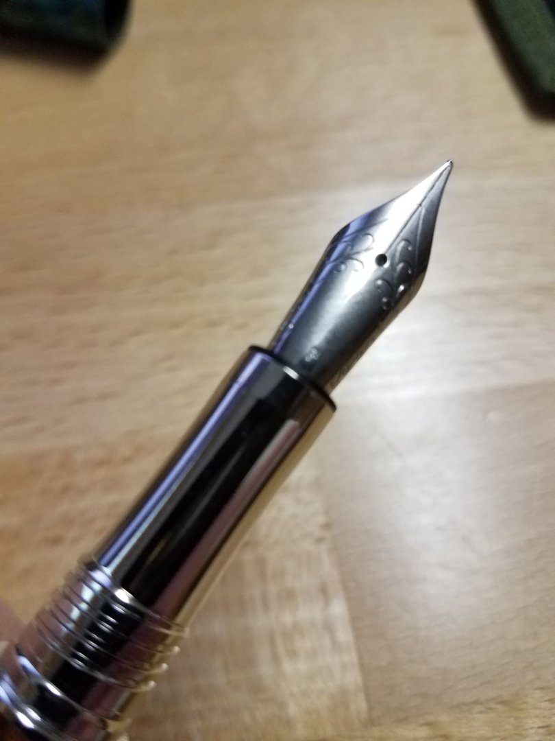

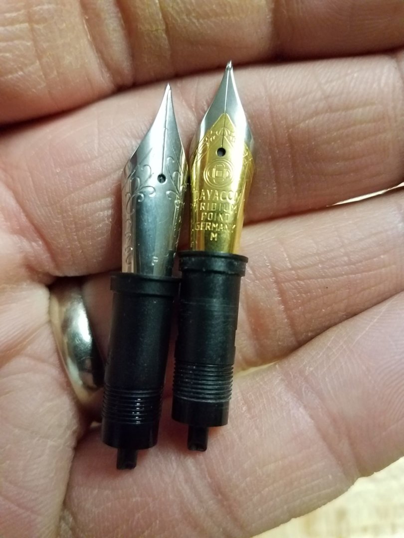

Christos, Jowo makes Dayacom's nibs/feeds/housings. Here's a Jowo #6 next to the assembly removed from a Jr. Aaron kit:
And the Jowo threads right in easily without any issues:
I've ordered my Jowos from here. You may even be able to contact them and see if they can sell you just the housing and feed. And you can buy a whole assembly to replace the one(s) you already cannibalized from another Dayacom kit. The housing/feed will be a direct screw in replacement for the one in the Dayacom kits. I have used #6 sized Bock nibs in Jowo housings and feeds a couple times without issue. So as long as the nib your wanting to swap in is a #6 size, it should fit in there and work just fine.
