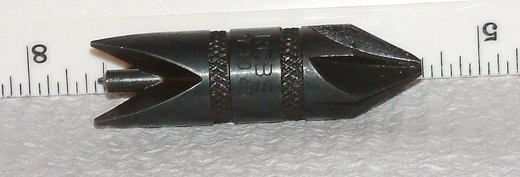

I have used a tubing cutter to cut and a combination reamer/chamfer tool for smooth out the ends.
I cannot find that chamfer/reamer tool for sale anymore, but it might be available somewhere. I can't remember if I got it at Arizonasilhouette.com or the LittleMachineship.com
It is basically a 3 inch long bullet looking steel slug about 5/8 inches in diameter with reamer on one end and chamfer on the other end. VERY handy for cleaning up tubing end flares and crimps.

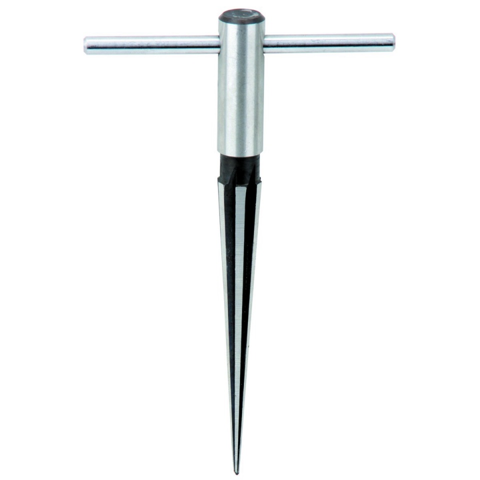

I use what sbwertz uses, then get a 45 degree hand held reamer to trim the end inside bevel works great.

I cut them slightly long with my pen blank cutting jig on the bandsaw, then use a squaring jig on the sander to square the end and get to the final size. Then i use a chamfering/reaming tool I got which is used for trimming bullet casings for refillers. I also use it after squaring the blank with the sanding jig.

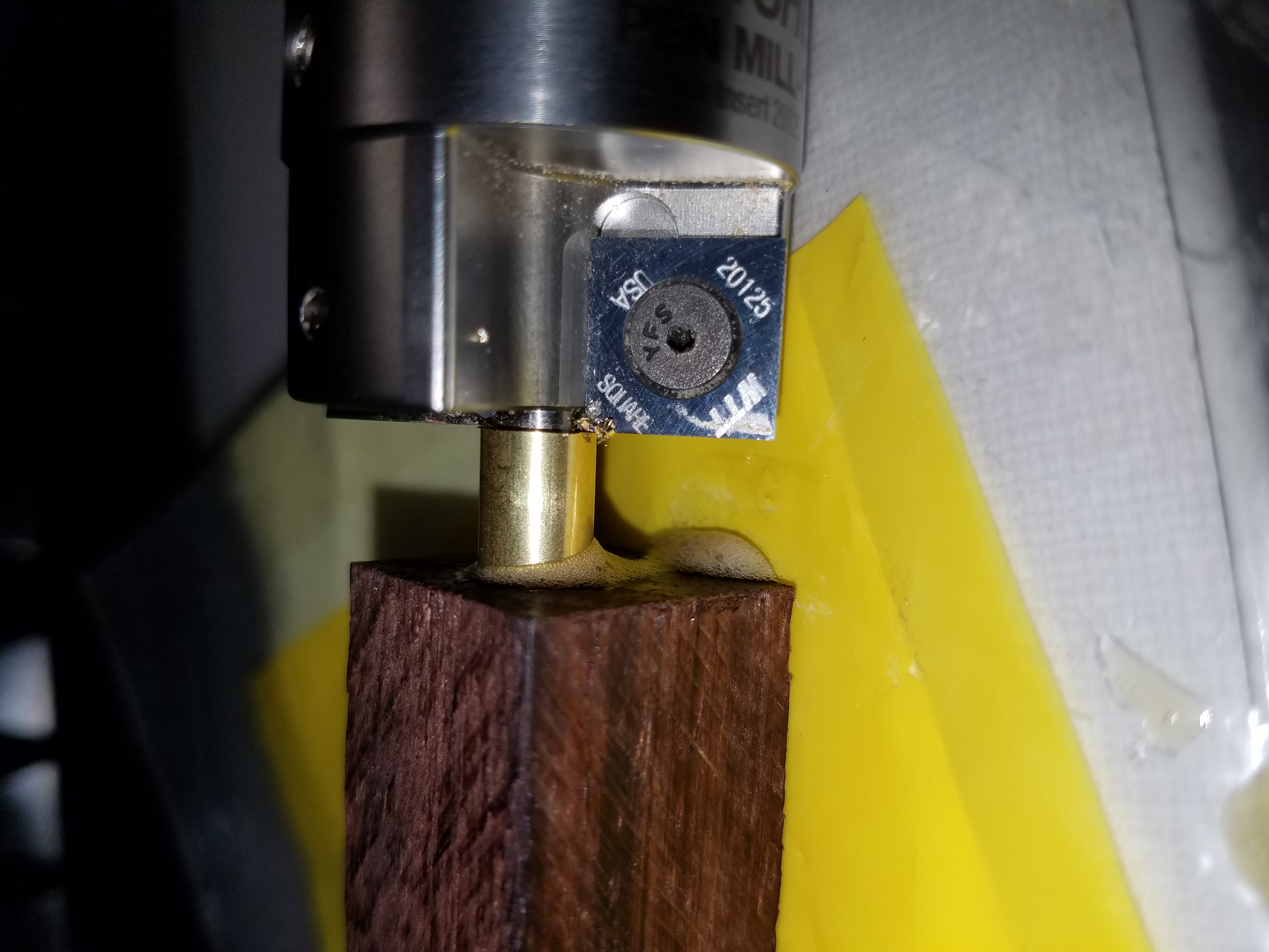

Woodpeckers Pen Mill Ci will shave unsupported brass tubing without issues. Even with a slimline, the carbide inserts completely cover and cut the ends of the tubes. No deburring required.
I've been making semi-tubeless clicker pencils (w/o center bands) by drilling a 4" long blank, then only inserting the tubes 1/2" or so on each end.

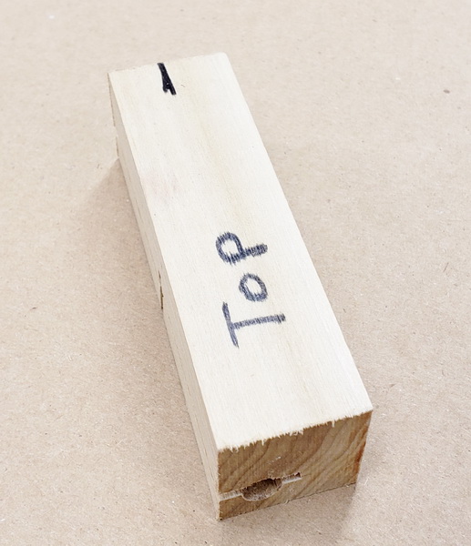

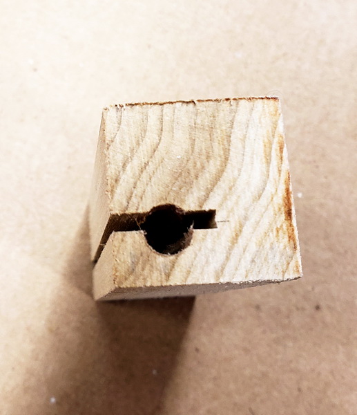

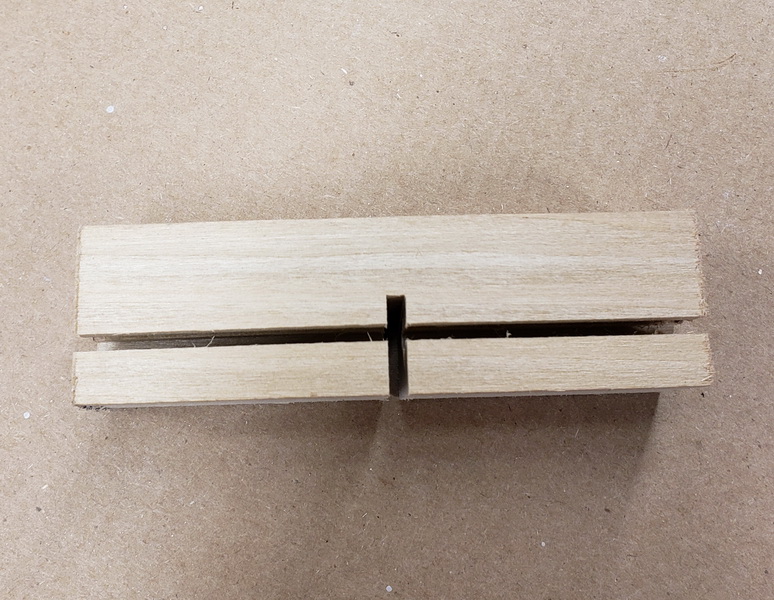

I use a small block as a Tubing Cutter. It works in conjunction with my blank cutter. The blank cutter has a screw hold down. You will still have to use one of the cartridge reamers posted earlier to clean up the inside and outside cut edge.
Just a 1" or so wood blank about 3" long.
Note the hole is offset toward the bottom and front edge.
[imgz='http://www.penturners.org/photos/images/2174/1_Tubing_Cutter_End.jpg']http://www.penturners.org/photos/images/2174/medium/1_Tubing_Cutter_End.jpg[/imgz]
View in gallery
This is the side that faces my table saw blade. The first use cuts the kerf in the front. It just has to be high enough to cut thru the brass tube.
[imgz='http://www.penturners.org/photos/images/2174/1_Tubing_Cutter_Front.jpg']http://www.penturners.org/photos/images/2174/medium/1_Tubing_Cutter_Front.jpg[/imgz]
View in gallery
This is the top side of the cutter. Handy to use and any length brass tube can be cut.

Bass Pro Shop and Cabela's should carry the cartridge reamer as should any good gun shop that carries reloading supplies. I use it on all my pen tubes after they have been squared; just a couple light turns will do it. Removes any burrs.
