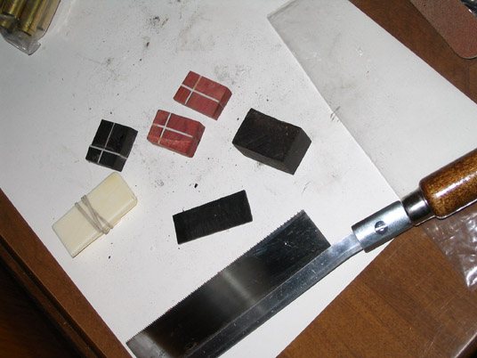

This is how I cut the Cross inlay---No jig ---No router template---No power tools---I am only going to make a few for my use---- not a dozen before lunch.
The trick----simple---cuts must be smooth and straight.
The saw was less than $20.00 bought many years ago---it has two different saw blades---I like this bigger heavy one.

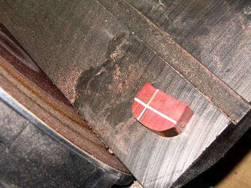

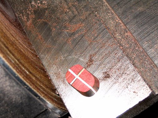

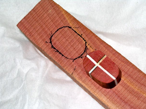

After I shape the inlay-----I cut the blank out to match the oval. It will only fit in the hole one way.
I have no ideal how thick the cross is but it sure looks good---hehehehe
How do you cut out the hole for your inlays??????

Gary,
Nice post, but that isn't the part of this I can't figure out.
The snug fitting ovals is what has me stumped (never mind that one where the cross doesn't touch the edge of the oval).

I'm traveling but I still think if you drill a hole at an angle you get the same effect. If course I have been wrong plenty tiimes before but I am going to try it and post something over the weekend.

Using a Kreg Pocket Hole Jig one could make an oval hole in a blank like that. Conversely,I think one could use a plug cutter to cut a corresponding inlay. I could be wrong about the second part but the first part is totally feasible and repeatable.

Thinking one way to do this would be the hole and the inlay could both be cut with a router. Matching templates and a few jigs to hold both the blank and the inlay. Once the oval hole is routed out and the inlay is routed to match the hole, glue the inlay in place. Most of the time consuming work would be making up the templates and jigs, but after that it should be very repeatable.
The part that I don't get is how to make the inlay. I simply don't have the understanding how, nor the time to get in the shop and figure it out.
