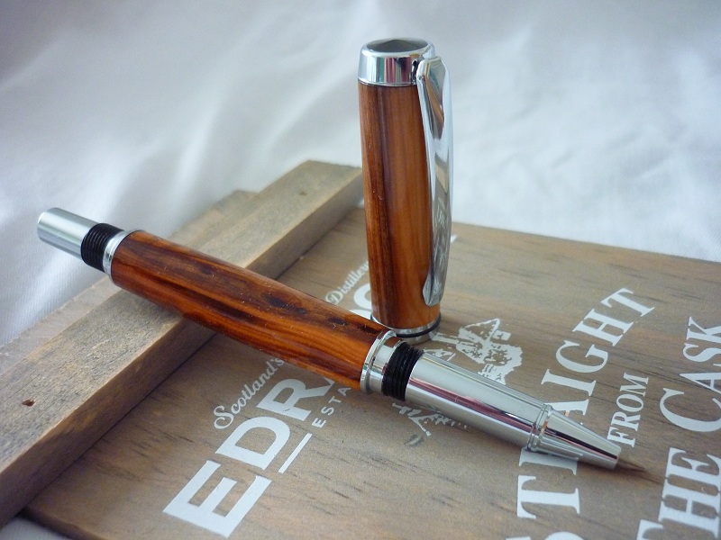

Started this a couple of months back, and have only just had the time to finish it. My first go at a custom wooden pen, so a bit of a practice piece. Used nylon rod to make the inserts....first thing to change for the next! When I was making the section I thought I wasn't going to like it, but now it's on the pen it's not too bad. The clip is I believe from Conway Stewart.......met a guy who breather Conway and he gave me a few.
C&C's welcome.
By the way, the barrel was done on my old lathe, and you can see how off centre it was!!!

Now that is cool! I have a wooden custom in the works and hope it comes out as good as this one. I'm finding it is a pain to design the correct size inserts that will accommodate the needed thread sizes and still give a suitable wall thickness without making the pen so big. Nice job.

I think that pen is excellent!! The small amount of 'black' you used perfectly highlights and shows off the light coloured yew. For me, I'd like to see a little more shape to the section, but otherwise I think it's fantastic. Very well done John !!:wink::biggrin:

Is there a finish on the wood, or is it just buffed? The finishing aspect is what keeps me from attempting more wood custom pens.

Skip: I totally agree with you on the section. I screwed up by using a 10mm thread in the barrel, so there isn't enough meat on the wooden part of the section to take it any thinner. I know this because I went through the first one!!!!:biggrin:
Joe: The finish is just a quick coat of friction polish then a very light buff.

That's a beautiful pen. I love yew anyway so it was always going to be a winner. What will you use instead of nylon for the inserts on the next one?

Probably acrylic or aluminium.....or a mix of both. I may even try ebonite.

I think that's a great looking pen. My only concern is with the section. I'd be afraid I'd stain the wood when the pen was filled. I know you can be careful, but it seems like there will be no way to prevent that from happening. Seems like I get ink everywhere.

Thanks Bob. It is primarily designed as an eye dropper (25ml capacity) but also cartridge/converter. The black end to the section was partly there for the very reason you are concerned about. The converter can of course be filled off the pen, which is what I usually do because I too end up with "ink finger"! :)
