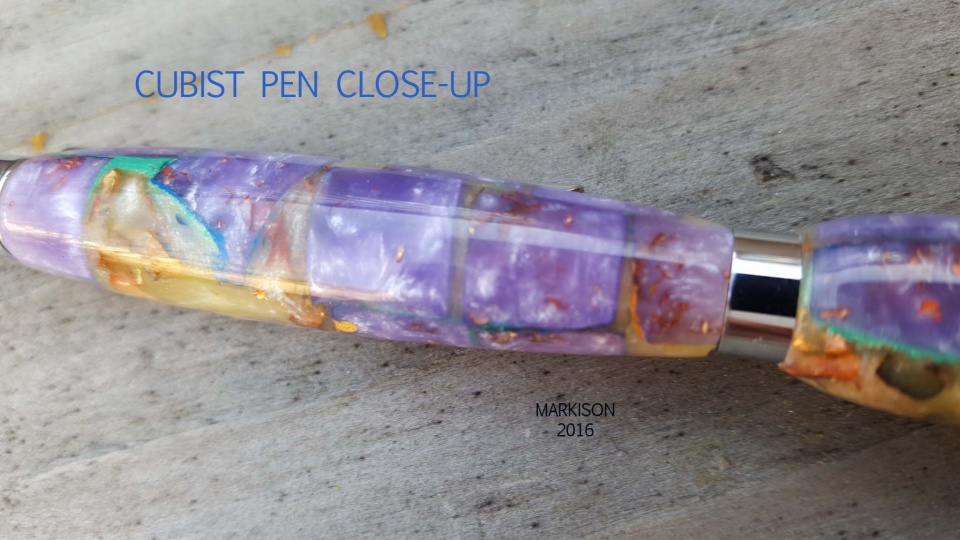

While I think they look neat and I can see the cubes in the unturned blanks I really don't see it in the turned pens. :confused:
Maybe I need a better closeup?
Hi Cliff - Sorry about low pic quality - here's a close-up showing cube edge detail - there are a lot of ways to make and use the cubes.
attachment.php
Best regards, Bob

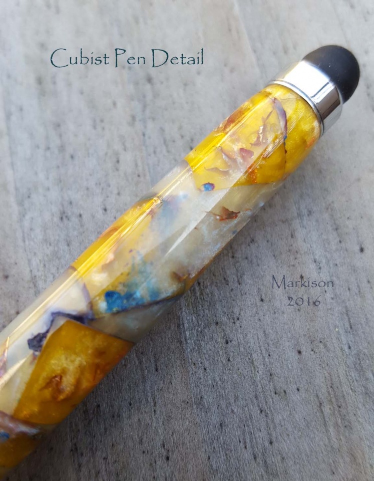

Cliff - Here's a close-up view of another "cubist" pen showing more "edge color pop" resulting from resin pouring into pigment and metal flakes preloaded cube tray.
attachment.php
Best regards, Bob

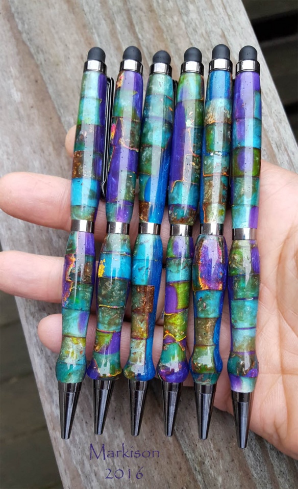

I often recycle resin fragments as well, and the smaller fragments can also be recast into cubes, then final cast into blanks.

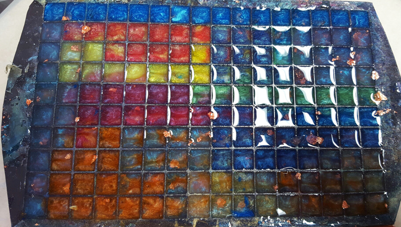

Hi Joel - Glad you asked - I no longer pressure cast the mini-cube trays - I just pour slowly to avoid bubbles. Sometimes I just want color on the edges, so I dust the cubes with pigment and mica powders, then pour in the resin - but more recently I've been premixing colors and pouring to get more vibrant cubes - like these:
attachment.php
I do pressure cast in a standard size pot (at 50psi) after I load my PVC pipe molds with cubes and pour resin over them.
Have fun! - Bob

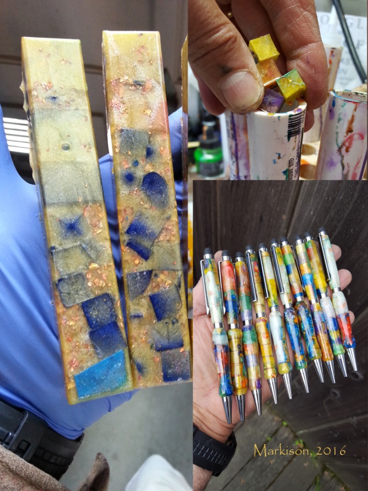

Hi Joel - I stopped pressure casting cubes because they were bubble-free so long as I did a slow pour of the Douglas and Sturgess clear casting PR resin -but you can do as you wish.
I then cast the cubes under 50 psi after I load them into white or clear PVC tubes or silicone block molds.
Since I use the same PR resin, the blocks don't go anywhere.
attachment.php
It's great fun, and opens up all sorts of creative possibilities.
Enjoy, and best regards, Bob
