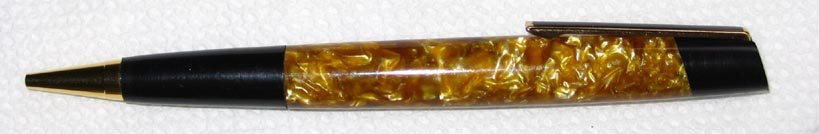

Here's a gold crushed velvet pen
<br />. Turns much like any other plastic...go easy, sharp tools, and it polishes nicely. This was sanded to 12000MM and polished with HUT's Ultra Gloss Plastic polish. The black is PVC rod.

What is the kit you used for the pen shown above? I don't recognize it and its a nice looking pen. BTW, the craftsmanship looks good also.
Richard
its_virgil
Jan 1, 2004
8,131
Wichita Falls, TX, USA.
Richard,
I used a slimline...modified of course. Check out this link to an earlier post on a similar pen. Down in the thread I show a picture of the pen apart. Look here:
http://www.penturners.org/forum/topic.asp?TOPIC_ID=5551
If I can be of any help, email me.
