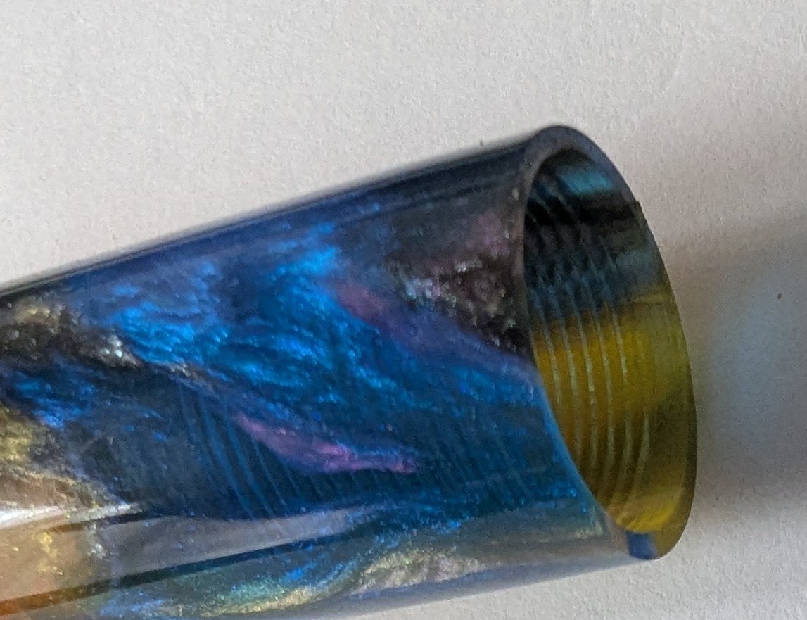

I've been having trouble when people are looking and trying some of my pens at sales, and sometimes they end up with the cap cross threading slightly when they put it on the body. It's easy to turn it back a third or so and restart it but it gives a poor first impression of the the pen.
I presume I'm doing something wrong with the fit of my cap and body threads but I don't know where to start.
I am using Tapco M13x0.8 and M14x0.8 taps and dies and the blanks are typically either from Just Turning in Australia or TurntPenCo.

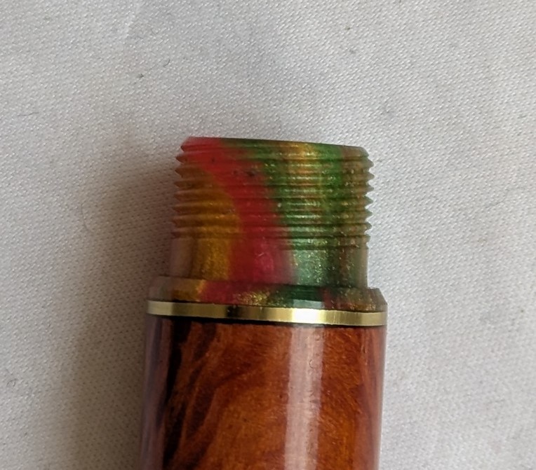

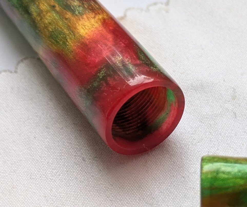

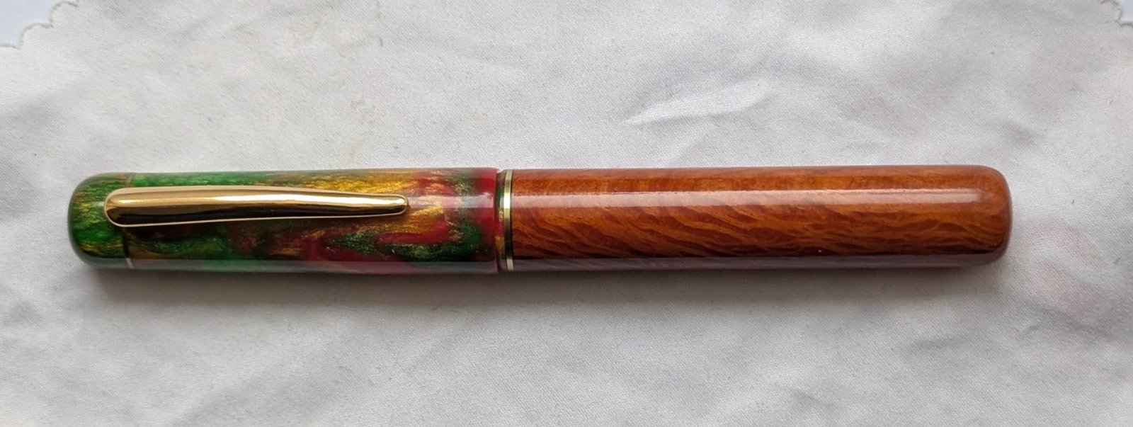

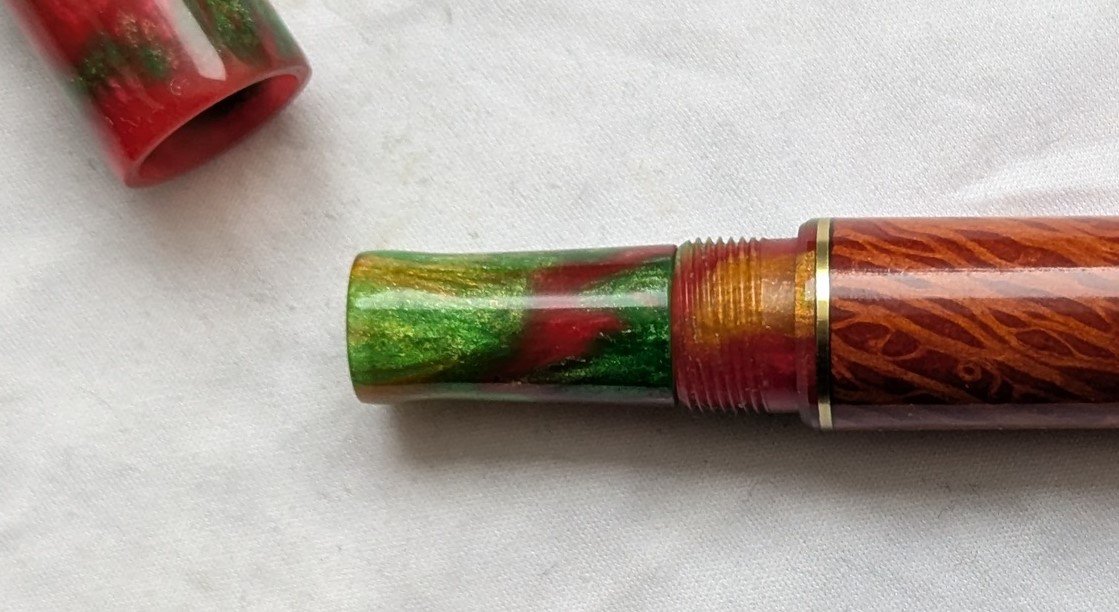

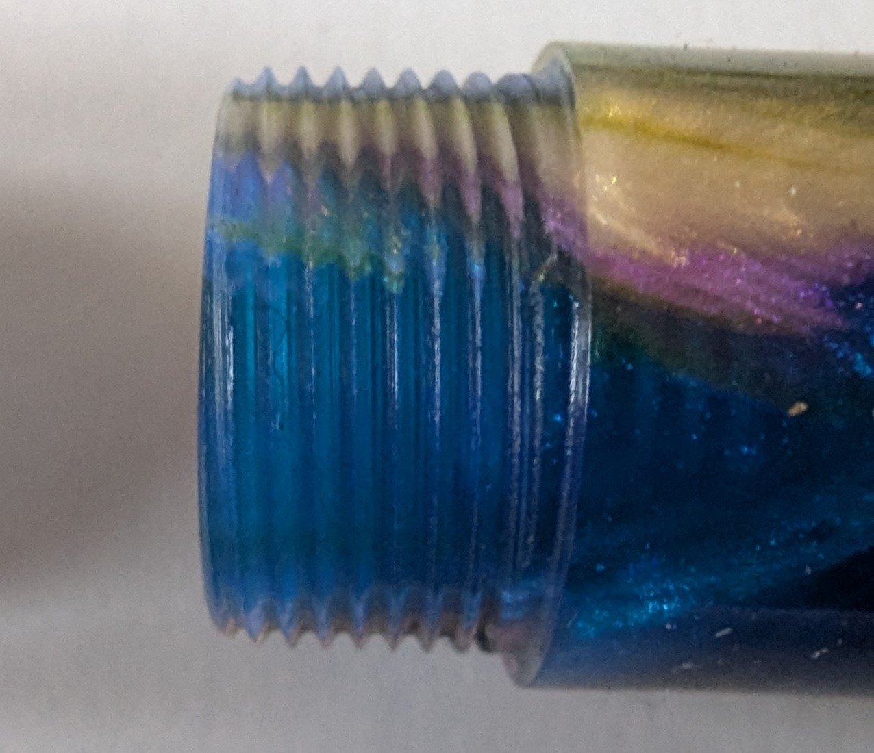

I've included some photos of two of my pens so maybe you can see what I need to do differently.
Any help would be appreciated.

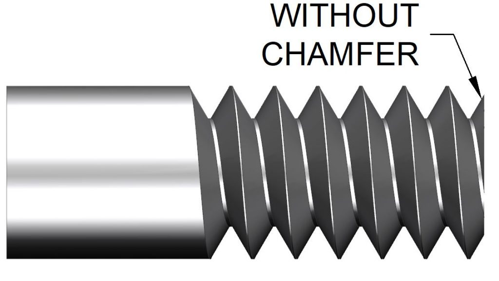

It looks to me like you need to put a radius on the end of your tenon and possibly chamfer the inside edge of the cap. At least from what I see on the blue section.
Doing so with help create a smoother start to the threads and guide the two pieces to join properly to help avoid cross threading.
I agree with @hooked - you need to give a bit of a 'runway' for the two parts to align themselves to prepare for turning. A chamfer or radius on the body would be my first step - allowing the cap to align with the threads as it is pushed forward on the body. The goal also should be to have a corresponding 'receiver' thread on the cap, so you have leeway for alignment before threads come into play.
The pics you provided show the thread starting immediately, without any space to help the cap be aligned before it hits the threads. Providing a non threaded area that brings things into alignment, even if you reduce your threading a bit, will cut back on the cross threading and ultimately help things last.

The blue one definitely has no radius/chamfer or lead in on the tenon, but the start of the cap has 1-1.5mm clear before the thread starts. How big a radius so you think I need?

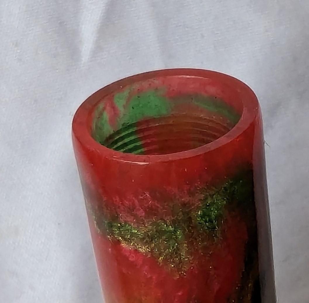

The red/green pen has a small roundover on the tenon and the cap has 3mm with no thread on it. Is this more what I should be aiming for?

I've expanded two of the photos for the red/green pen to see if that helps at all. I've seen some pens where there is a definite 1-2mm lead on the body with no thread on it. I presume this is at the minor diameter of the thread. Is that what I should be aiming for or is it enough to just round-over or chamfer the start of the thread?

Yes. More like the red/green one. It's just a matter of taking a tool to get rid of that 90 degree edge before you thread and make it more of a 45. 1-2mm.
To me, this creates a smoother connection and starts the thread a bit farther down from the edge of the tenon.

Also, what is the ID of the relief you cut in the cap? I remove only enough so that there are no threads or marks from the threads. If this is too large, then the ability to get things misaligned is increased.

When I went back and looked at the original pictures, the red pen is definitely different in its construction than the blue pen. My comments were more focused on the construction of the blue pen - where the body threads start right in and the cap is recessed somewhat for threading. What we can't see is what caused the evolution of the discussion into the comments regarding the ID and relief cuts, as well as the depth and size/angle of the chamfers and more!
