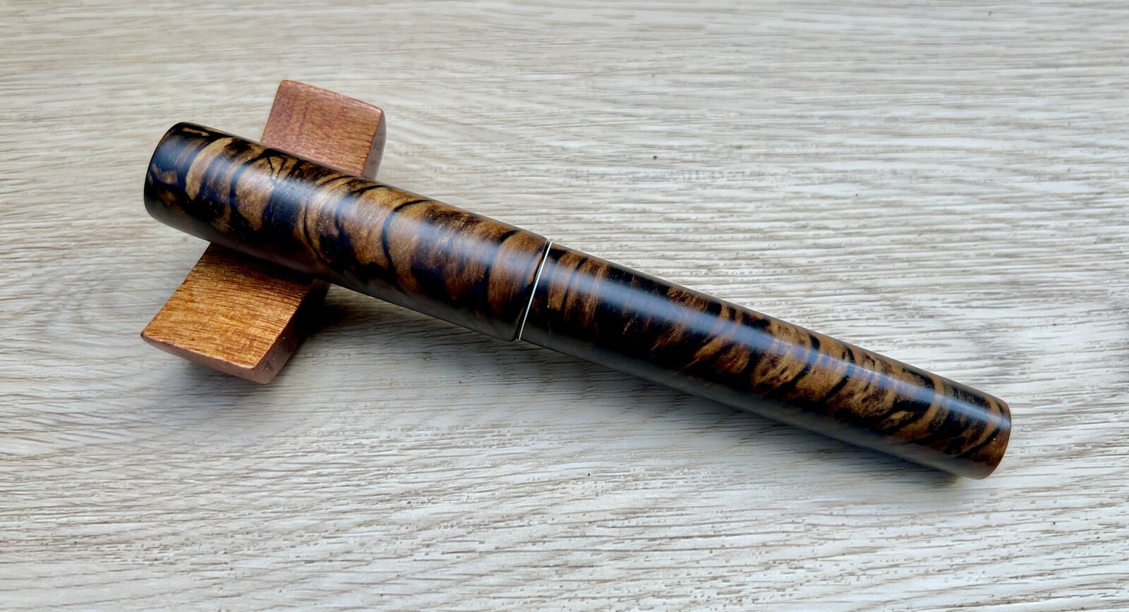

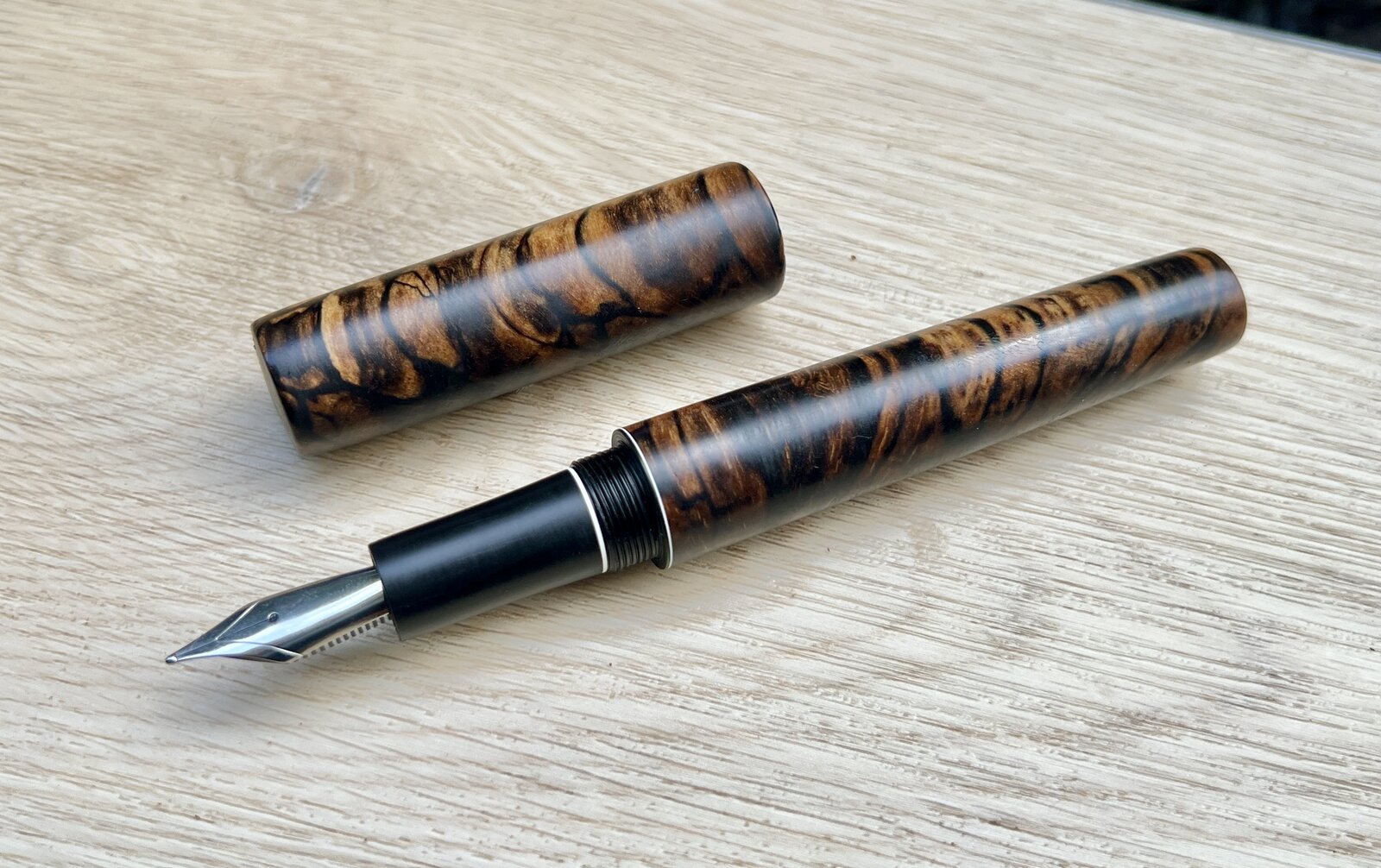

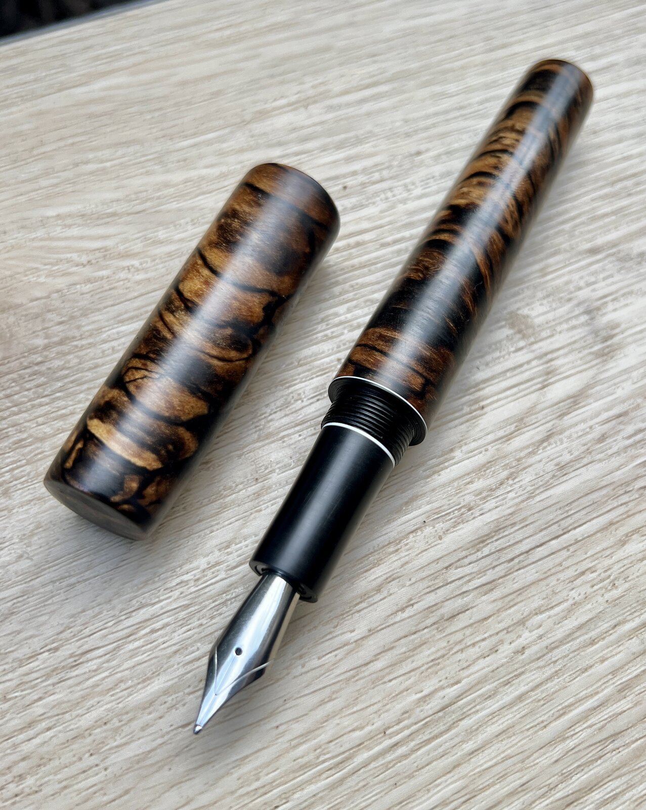

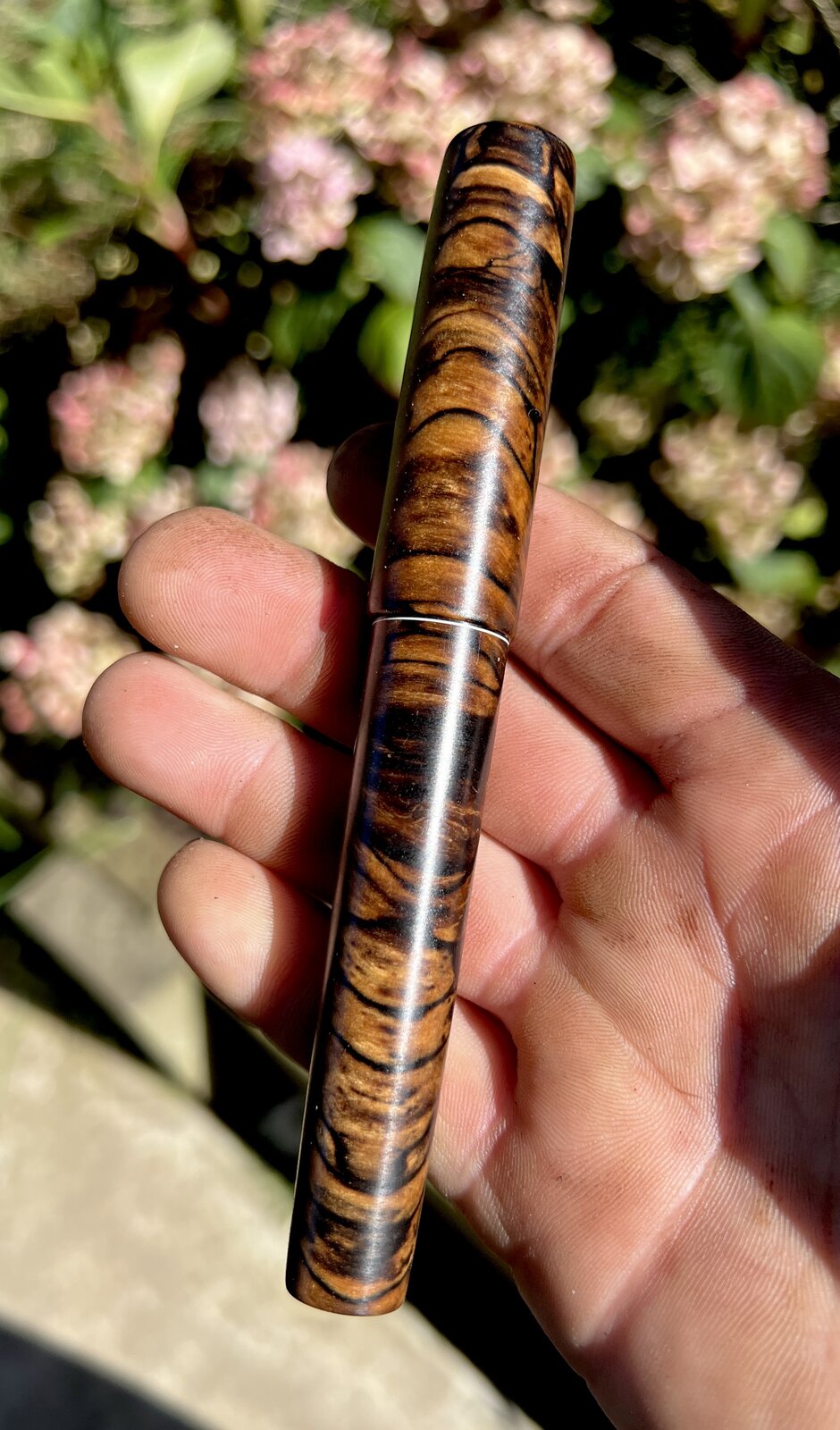

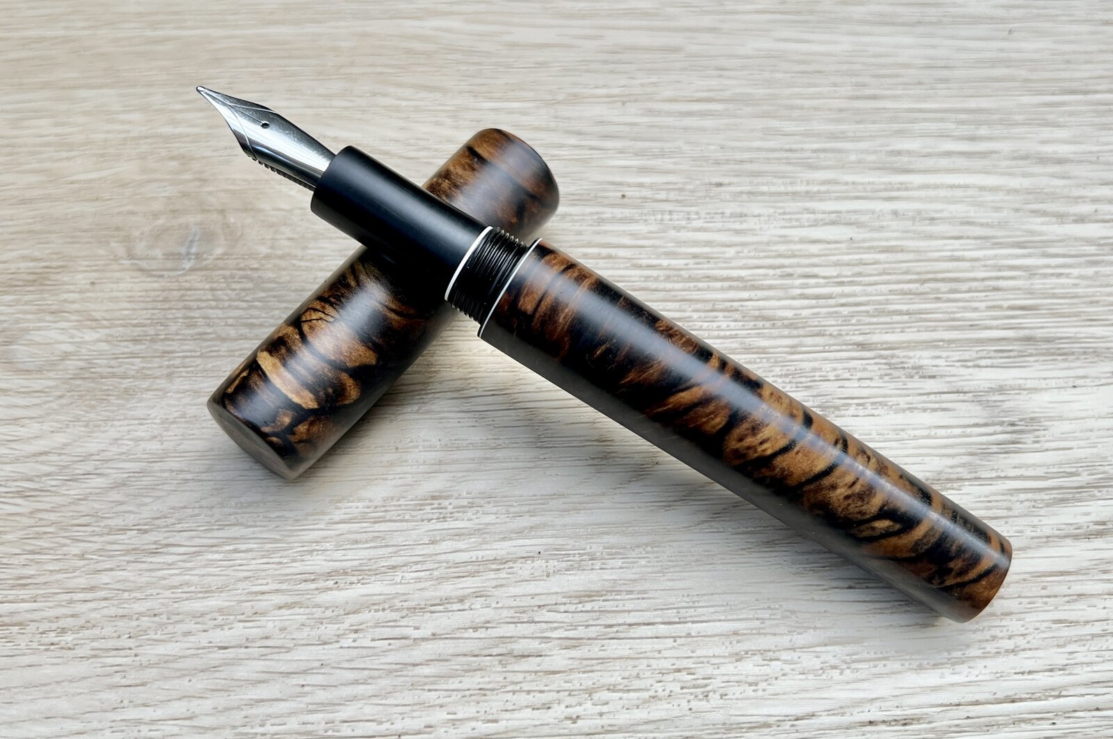

This lovely stabilised blank came from a dear friend and he said that is was the punkiest piece of timber he has ever stabilised. It was like chalk. Basically turned to dust when I was turning it. Slowly but surely down to size. Fully lined with ebonite, ca matte finish. The grip section is also ebonite, and I added a few acrylic bands for that small point of difference. Jowo #6 nib.
M14 triple start threads
Thanks for looking!

Terrific looking pen.
The white bands…did you just cut/insert/glue and turn? Those look great right in the edge of the threads.
Thanks, so I drill a 10 mm hole in my spacer material and glue it onto the rear of the grip section tenon. The body of the pen, it's glued to the end, adds a little protection to the edge but mainly aesthetic, I like the look of it closed with a thin band, gives a little interest
