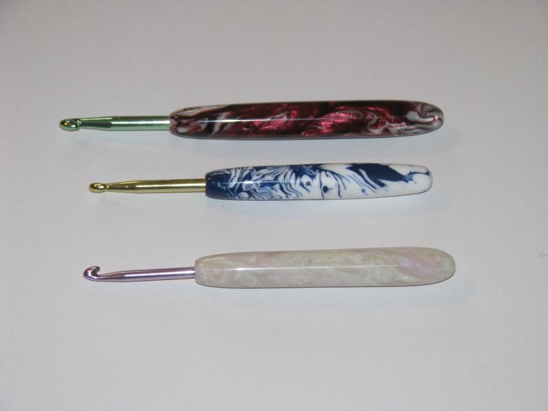

Made these Crochet needles for my mother for Christmas. Since she was diagnosed with cancer last year, she has been making and donating hats for other Cancer patients. She has been complaining that the small needles made her hands hurt. The cobalt blue and white and the white and pink are my home cast. The Copper/white is a Mr Brooks. (sorry for the pic quality)

Nice job. Let's see how long it will take to see these in PSI's catalog.
I wouldn't actually hold my breath due to sizing issues. A serious crocheter needs several different sizes of hook, and the sizes they find most useful will vary depend on the type of project and the tension they use. I use a "G" hook most often, others like a much larger hook "M" or above, lacemakers use teeny-tiny hooks. Even if PSI came out with a generic mid-range kit, you'd still be better off doing a custom job for the recipient if you actually want it used.

These are G, H & I, the sizes my mom use's the most for her hats. All took different size holes. I could only drill about 3 inches deep due to the bit lengths. I cut about 1-1 1/2 in. off the needles to work out the overall length from the finger bump.

This is easy to do. It is similar to making seam rippers, or other sewing and darning tools. I don't usually use kits for most things. I order parts from wholesalers and then figure out how to make it work with turnings.
