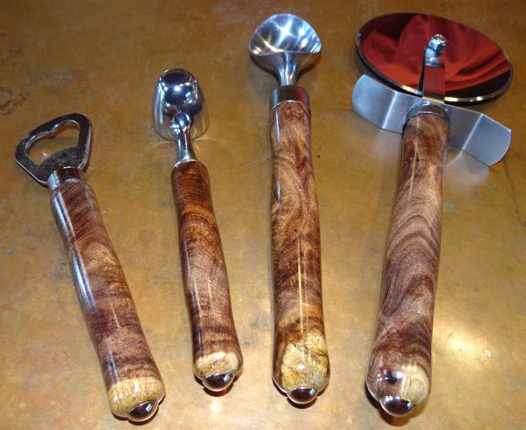

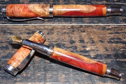

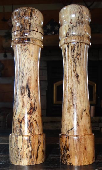

My goto finish now is to do a soaking coat of thin CA, then sanding down with a 500 grit Abralon pad and then 5 to 6 coats of Craft Coat (with 1 minute between coats). The CA gives a nice hard base as well as really making the grain and color "pop." The Craft Coat then gives a very durable, hard, water resistant high gloss finish without the "plastic" look of CA.
Here are some recent utensils, mills and a Desire fountain pen using this method.
