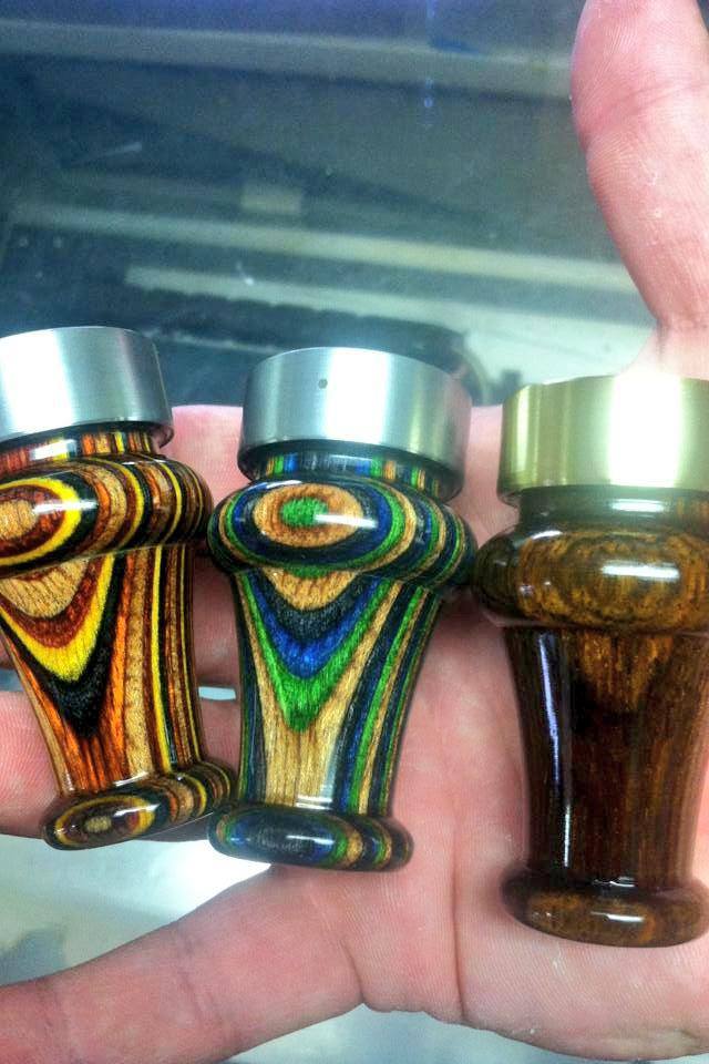

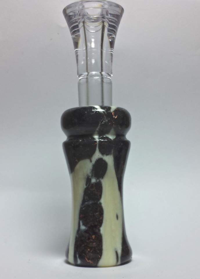

Eco Advance has some customer pictures of duck calls finished with CC on Facebook. Here are some of the pictures from the duck calls. These calls were dipped rather than friction finishing like most of us pen turners do. And just for the record... these calls have the CC covering the Metal bands too!
936832_533451400024799_795466510_n.jpg 941831_528927893810483_1207236952_n.jpg

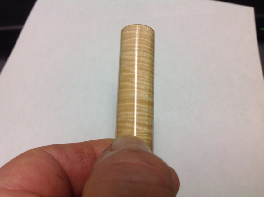

Got mine yesterday and gave it a try. I had pretty much stopped using wood for pens because I wanted high gloss (with the superior grain detail / glow of an oil finish), a quick finish and I didn't want to deal with CA/BLO anymore. CC seems like it has potential, but I haven't been able to get the results I'm looking for yet (after only one afternoon's trial). Here's my thoughts after a couple of hours yesterday:
1) On closed grain wood it takes about 10 minutes to get a really high gloss finish on a pen blank sized piece of wood. Most of that time is waiting time, but not enough time to do other things while you wait. 10 seconds application followed by 50 seconds of waiting...repeat 8 to 10 times.
2) On open grain wood, CC will not fill open grain. I do not like high gloss finishes over unfilled grain where the unfilled grain (or other things that lead to a less than flawless gloss finish (e.g. tear out, tool marks, sanding marks...)) leave a "broken" plastic looking finish. With CA, it was easy to QUICKLY fill open grain in a number of different ways. While there are many ways to fill grain before application of CC, none of them are as quick as CA. Sanding in the first coat of CC is not a good way to fill grain (unless maybe you wait a whole lot longer than I did before the second coat). I intend to play around with this some more to see if I can find a way to speed up the grain filling process.
3) I like the way wood grain "pops" with the application of an oil finish (e.g. BLO / CA). I also like the ambering an oil finish gives to lighter colored woods. CC doesn't "pop" the grain. On light woods, it doesn't show anywhere near the ambering of a BLO/CA finish. CC on lighter woods look lifeless and pale to me. It looks pretty good on darker woods, especially those that usually really (over) darken up with oil.
Trying to get a better look on lighter wood, I gave a blank a quick friction application of BLO. Then applied the CC. The CC did not adhere well to the BLO treated blank (their instructions clearly state the blank must be clean with no oils or such, but I had to try anyway). CC did adhere well to oily wood (teak and rosewoods) that were wiped with DNA before application.
Application of shellac as a base coat is pretty common with water based finishes. I did a few trials with shellac, and it seems like it might be able to significantly improve the look of CC with lighter woods (in my opinion anyway). I also have some "ambering" dyes that I used when I sprayed my turnings with water based lacquer. I plan to test those with the CC as well to see if I can get closer to the look I want in lighter woods. I'm optimistic.
4) I didn't detect any smell with CC. I didn't have any noticeable reaction after working with it for a couple of hours. I did read the MSDS which sounded dire in places, but no worse than most of the other finishing products (and resins) that I work with every day.
I wasn't happy enough with any of the test blanks to spend time taking pictures. I turned off the finishes to get them ready for the next round of testing.
Hi Ed,
Thank you very much for the information. My experience has been much the same with regard to your second point. I have mitigated the "broken" plastic effect by wet-sanding with Mylands Friction Polish at the 220-grit stage of sanding.
I have been using this method of sanding on all of my open grained woods and any burls that could use some pit hole filling. I then just sand the blank like I normally do for a smooth finish. My process is then followed up with the CC finish. YMMV, but this has worked well for me. :)
View attachment 108405 View attachment 108406
Hi All,
I was just informed this morning that this Call had been thrown in the air and allowed to impact the concrete, was submerged in water for 24 hours, and was doused with insect repellent. This was done all in an effort to simulate a duck hunting expedition.
Michael
Presumably that's the "after" picture? :biggrin:
Ed
You are correct Ed. Thanks for clearing that up as I neglected to even mention it. :rolleyes: Blaming lack of coffee this morning.
Additionally, in all fairness and full disclosure, that call was dipped rather than friction polished with CC.
Michael
have a before image because I am having a hard time finding the scuff mark where it impacted the concrete.
Hi Ed,
I have no other images as this was the only one sent in by a customer. I agree about the not seeing a scuff mark comment for sure, but I do not have any other images to compare for before and after, only the after.
Michael
I was actually thinking the photo's were before shots for some reason.
We thought the same until the customer informed us that it had been under water for 24 hours and then he sprayed denatured alcohol on it. :eek: The finish looks to have held up its end of the bargain for sure. :smile:
Michael

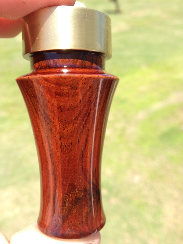

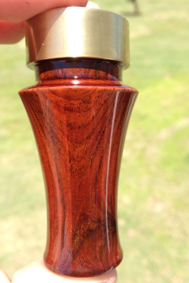

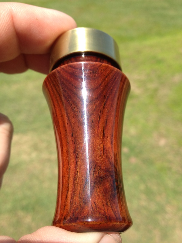

Here is the actual review for the cocobolo call tested with CC
Here is the actual review mentioned in earlier posts. These comments and pictures were provided by a customer of ours. I was able to find a second "after pic" to add to the collection. I corrected an earlier post referring to insect repellent. I was confusing reviews from customers.
"Ok Guys here are 2 more pics of some cocobolo. This call doesn't have any sanding sealer on it at all. The finish is complete solid and is not gummy.
I have also done a drop test from eye level (= 5'6") on the concrete floor in my shop and it didnt chip or crack. I then tossed it up in the aid and let it drop on the concrete. This time it dented the flared part on the call below the band and he a very small chip that you couldn't hardly notice.
2nd test was I wiped denatured alcohol on it. it took the shinny look off the call and was a little gummy for about 10 seconds and then it hardened right back up. I was able to take the call and put it on the lathe and applied Novus #2 and it polished right back up."

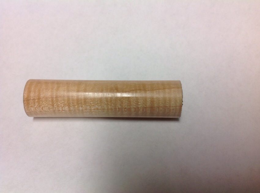

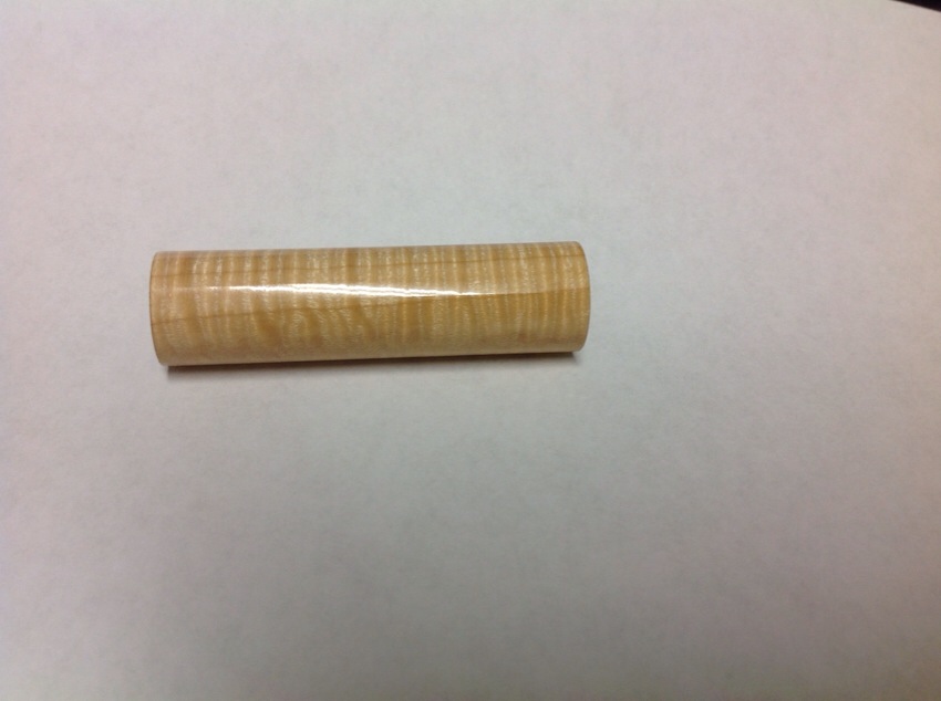

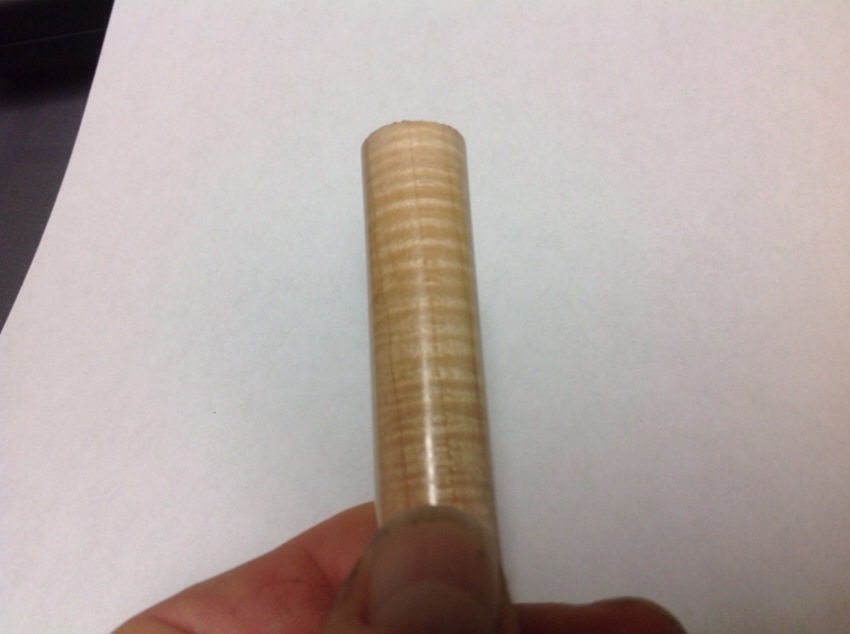

Well I finally got my CC and have now given it a try. 1st impressions not good.
I was OK to apply not as fast as CA, I liked the low or hardly any odor.
But as others have said it does not pop the grain like CA as with most if not all water bourn finishes it does not have the richness of the non water bourn products.
The 1st two pictures are CA 8 coats and the 2nd two pictures are CC 12 coats.
I could not start my finishing on the CC after the 12 coats as it was too soft and had to wait overnight.
I am now doing a dipping method but this will take a little more time to get the coats on.
Oh just another FYI don't try to use plastic polish on it.DAMHIKT.
Lin.
