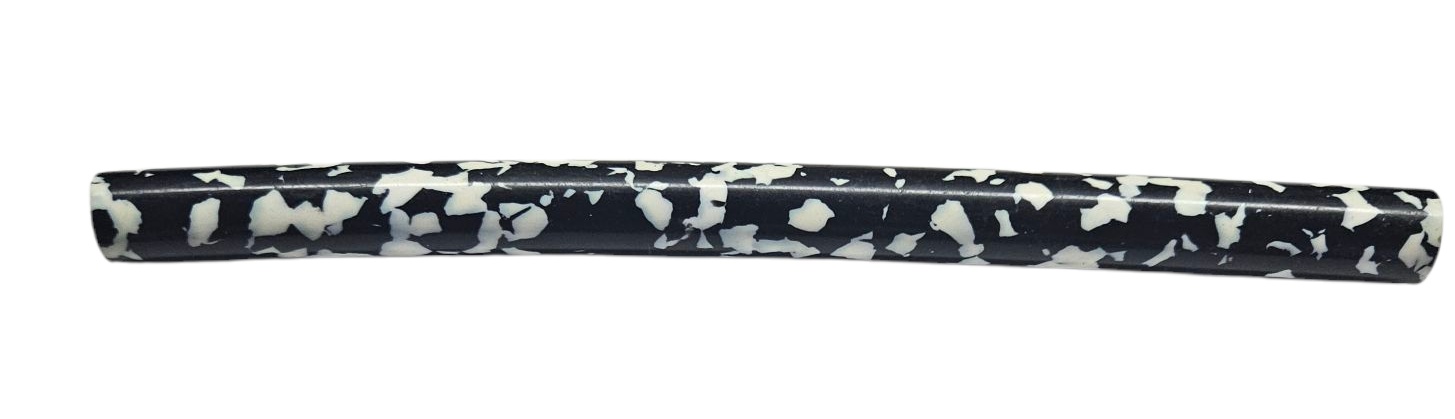

I have this if it will work. 9 inches long
Cebloplast from The 1849 Mazzucchelli Company
Sensitive to heat. Drill slowly and use a spray of water to keep cool.

That's a great blank Don! I have made pens with Ceboplast before - it's great old resin. I appreciate your reply, but it looks like I won't be needing the cow pattern after all.

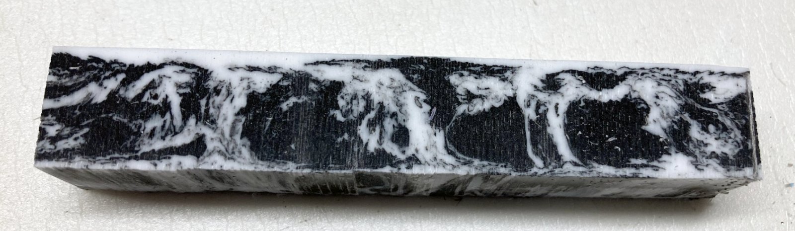

I tried casting a "cow" blank last weekend - I carefully poured black dollops into white resin in a mold - unfortunately, I think I poured too soon (at too low of temperature) and did not get very good color separation. A photo is below. I showed the photo to my customer, and he thinks it's nicer than a cow blank, so now he wants me to make his pencil with this blank.
