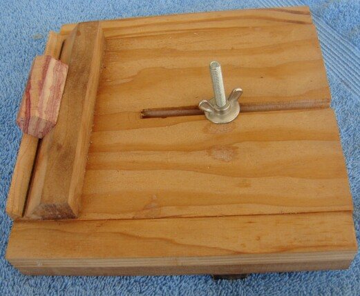

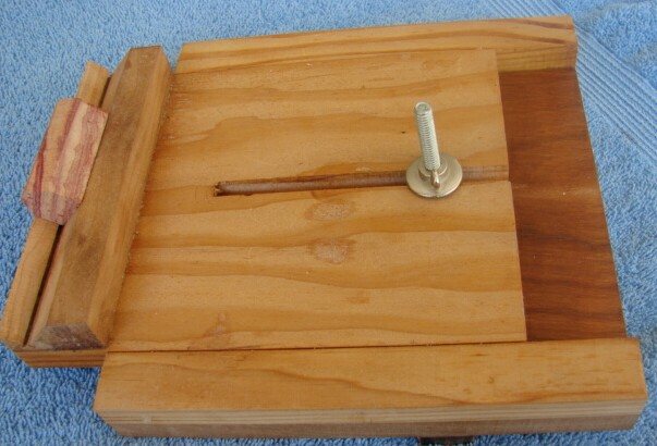

Thanks Bit, or should I say Mr Broke?
I am guessing this is meant for a band saw?
I have a similar one I use on the table saw that is adjustable using the fence and the addition of a "hold down" piece for the top.
The concept is the same.

Pretty neat jig. If I feel the need to cut some corners, i usually just run the blank, on the mandrel, on my band saw. Do you have to hold the blank down on the jig with your fingers?

I take my time and my fingers nor the mandrel does not come near the blade. Well not near enough to make me nervious. [B)] My question was, what holds down the blank in the jig?
