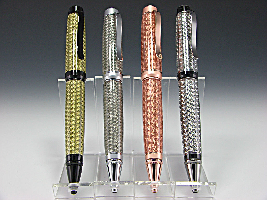

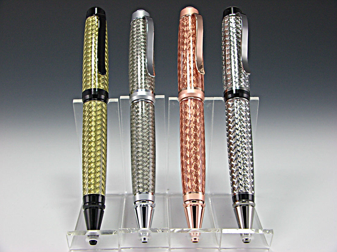

I have done all kinds of braiding on pens. For copper I get from ebay. I like to use 1/2" mostly. If doing slims you may want 3/8" The braiding will expand some. Do not want it to over expand then you see the tube through it. Have done copper, brass, stainless steel, stainless and brass combo, red colored copper with black. mylars of many kind. Here is an example of some.

I am particularly struck by the yellow and black one. I have seen it before and thought "Hmm not sure" but thats the one I keep remembering and coming back to. What kit is that one please?

Awesome job.
Sorry did not see this question. All these are cigar kits. That one has brass braiding on it. From left to right, brass stainless, copper, and chrome mylar. Of all the ones I make I sell more chrome.
