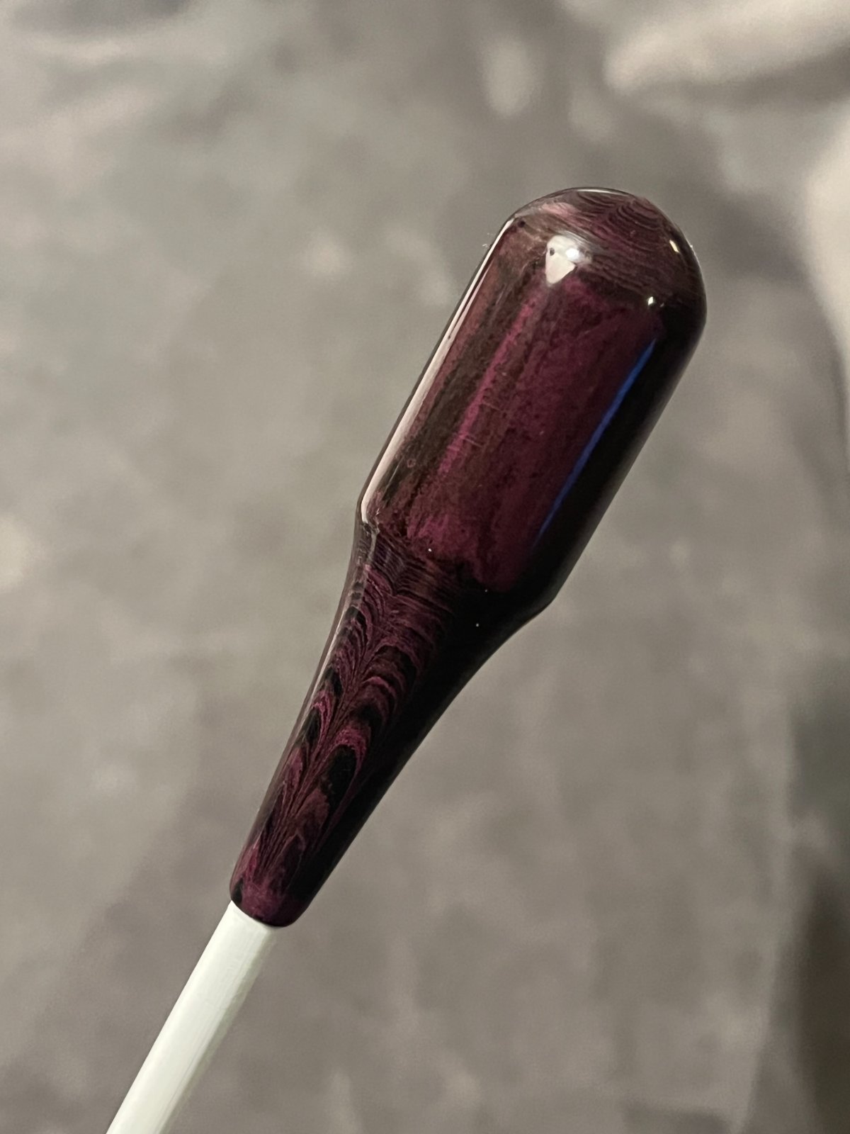

I just got into turning. The best kind of hobby is one that your spouse gets something out of. So the first thing I started making are conducting batons for my wife who is an orchestra teacher. So far I have made them out of purpleheart, ceylon satinwood, curly maple, purple dyed curly maple (school color), acrylic and most recently purple ebonite.
She has also started giving them as birthday presents to her fellow orchestra teachers. The first person who received one was particularly fun because she is a young teacher who had only ever had cheap plastic "chinesium" batons. Good batons typically start around $75-100, not something a young public school teacher is likely to spend money on. So she was particularly excited to get a high quality baton that was properly balanced. The baton should balance right in front of the handle. The only way to achieve this is to add a weight inside of the handle.

Nicely Done! Love the ebonite.

Very Cool!

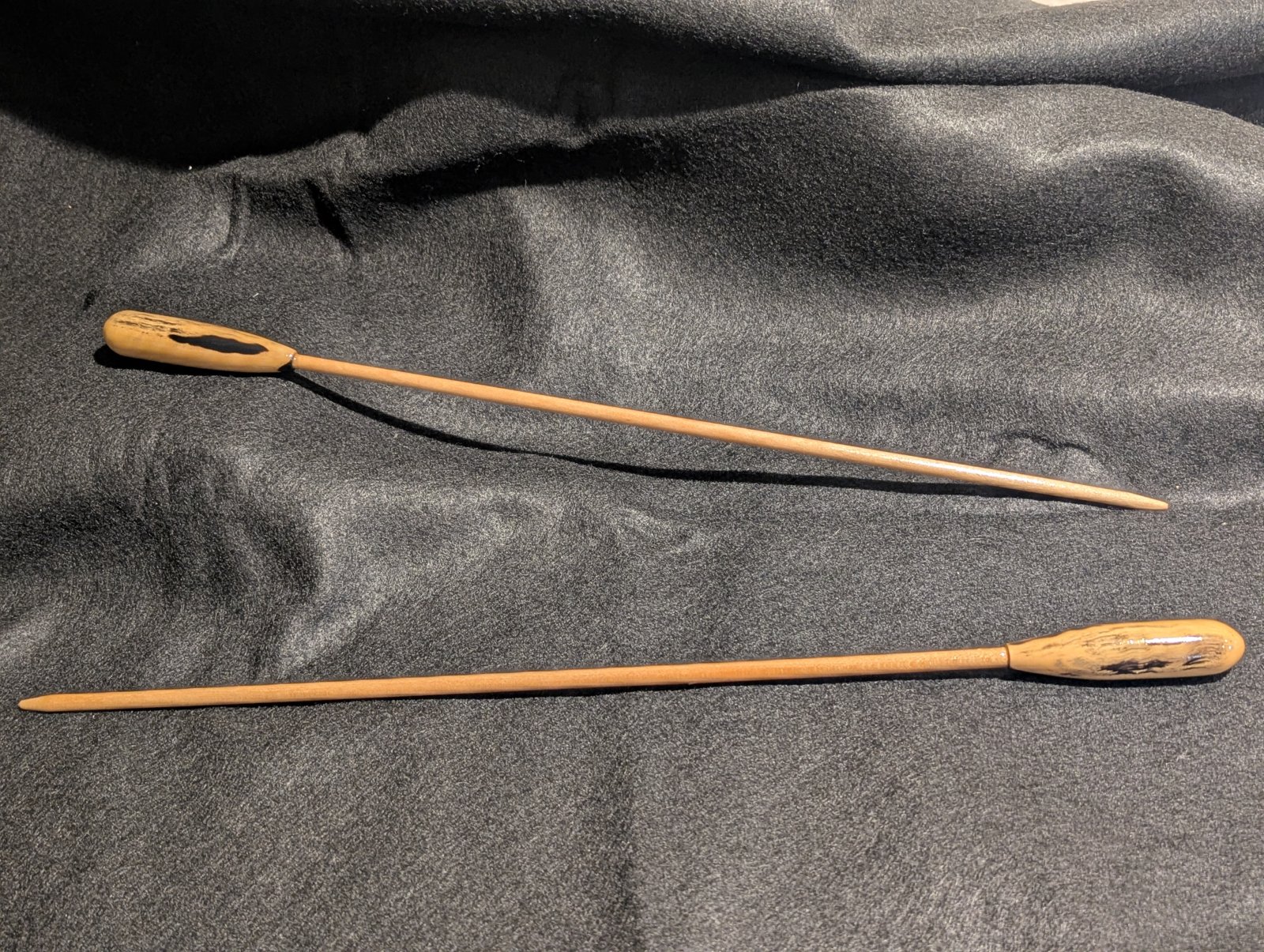

Beautiful work. I've done a few batons for my kids band teachers, especially the student teachers as a thank you and graduation gift. I make my shafts from maple. I cut it into 1/4" x 1/4" x 18" blanks. I've found it faster and easier to sand it to shape from there. I plan on trying decorative inlays for balancing in future pieces. These 2 are black & white ebony handles with maple shaft.

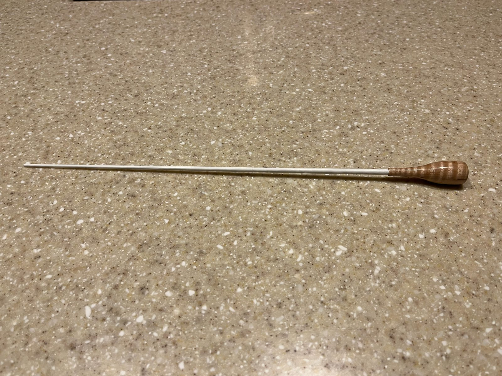

Yeah, my wife breaks the wood shafts, so I have to do fiberglass. Here is a picture of a curly maple one with the whole shaft. IMG_3417.jpg
Very nice. Where do you get the shafts? I've made some out of maple but had requests for fiberglass
Steve
Originally I was going to buy fiberglass rod and turn it down, but I decided I really didn't want to deal with fiberglass dulling my tools and filling the shop with fiberglass dust. So instead I found that the cheap "chinesium" ones on the local multinational conglomerate trillion dollar e-tailer can be used sort of as blanks. They truly are garbage, the handles are poorly cast plastic and the shafts are unfinished splintery fiberglass that is way too thick for a proper baton. However they are super easy to pull the handles off, chuck in the lathe to sand down to a decent thickness and then paint with a white polyurethane. I wear a respirator and hold the end of my shopvac right next to the sandpaper as I shape it. A lot less work and much safer than starting with fiberglass rod. Definitely worth the $2 they cost (as a blank, not as a baton).
