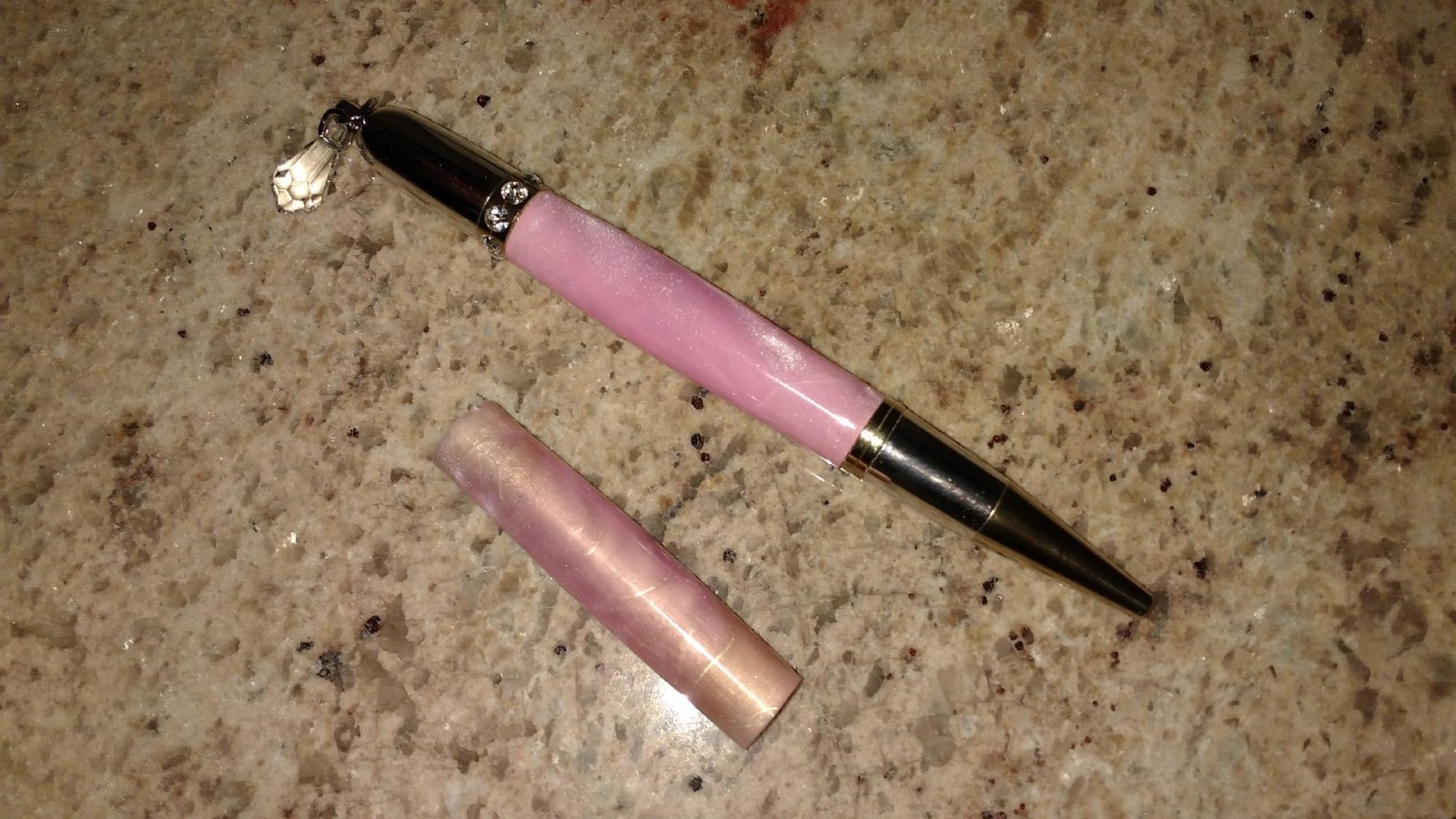

... I've now spent three days trying to make a Dive pen for my grand daughter (a very fitting pen). Without considering the potential for the tube to show through the Hot Pink Aquapearl blank, I just drilled the blank, glued in the tube and turned the blank Disaster! So I started over, painting a tube and the inside of the blank with pink acrylic paint. Next day: the tube would not fit into the blank so I drilled it out and glued it in with pink colored epoxy. I got carried away with adding paint to the epoxy so I'm not sure what tomorrow will bring. Sometime I learn from my mistakes.
I'm attaching a picture of the blank on my first try, and the finished pen after painting the tube, the inside of the blank,and the epoxy pink.

WOW ! . . You can certainly claim success !! . Well done, and thanks for sharing your experiences with us.

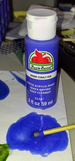

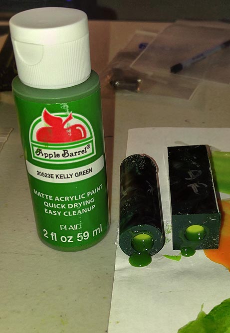

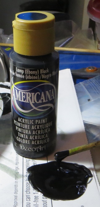

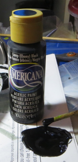

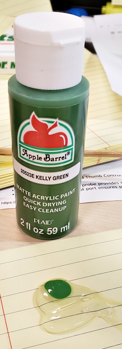

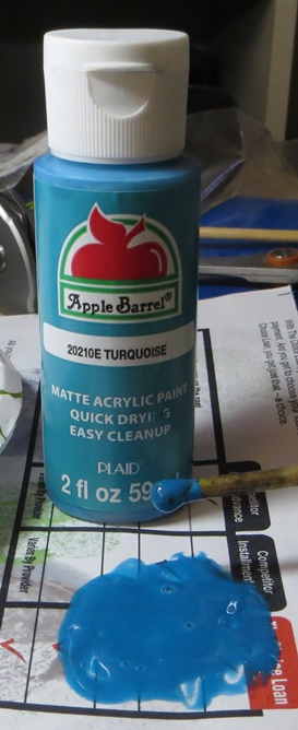

qquake
Feb 8, 2004
5,007
Northern California

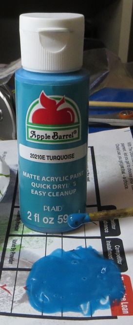

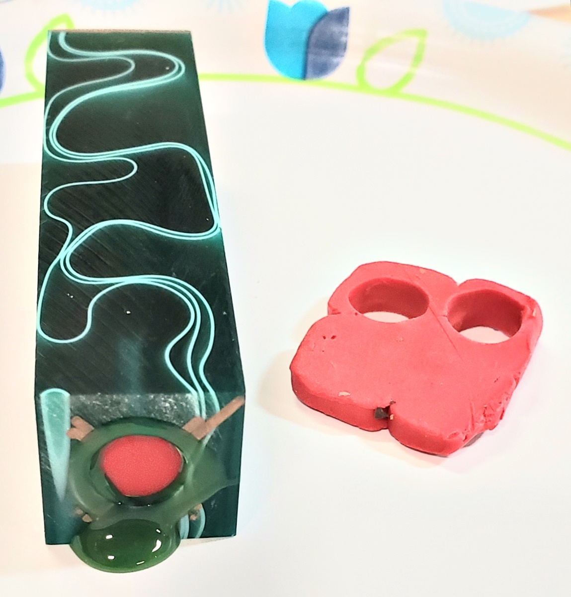

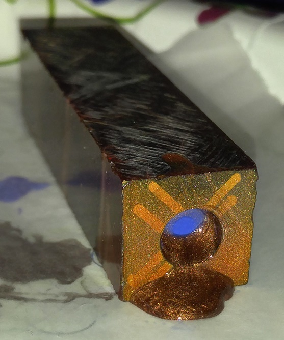

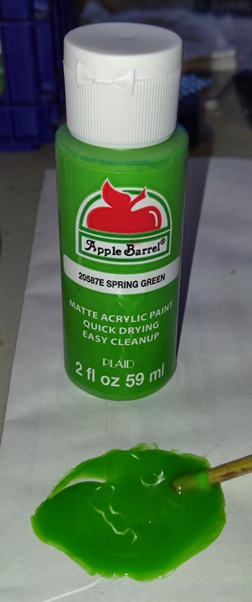

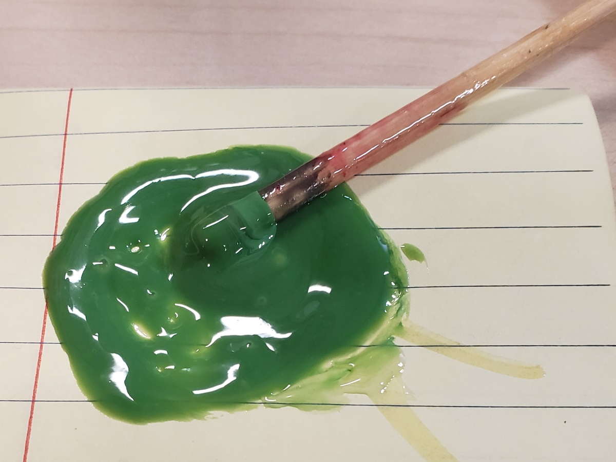

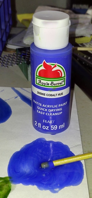

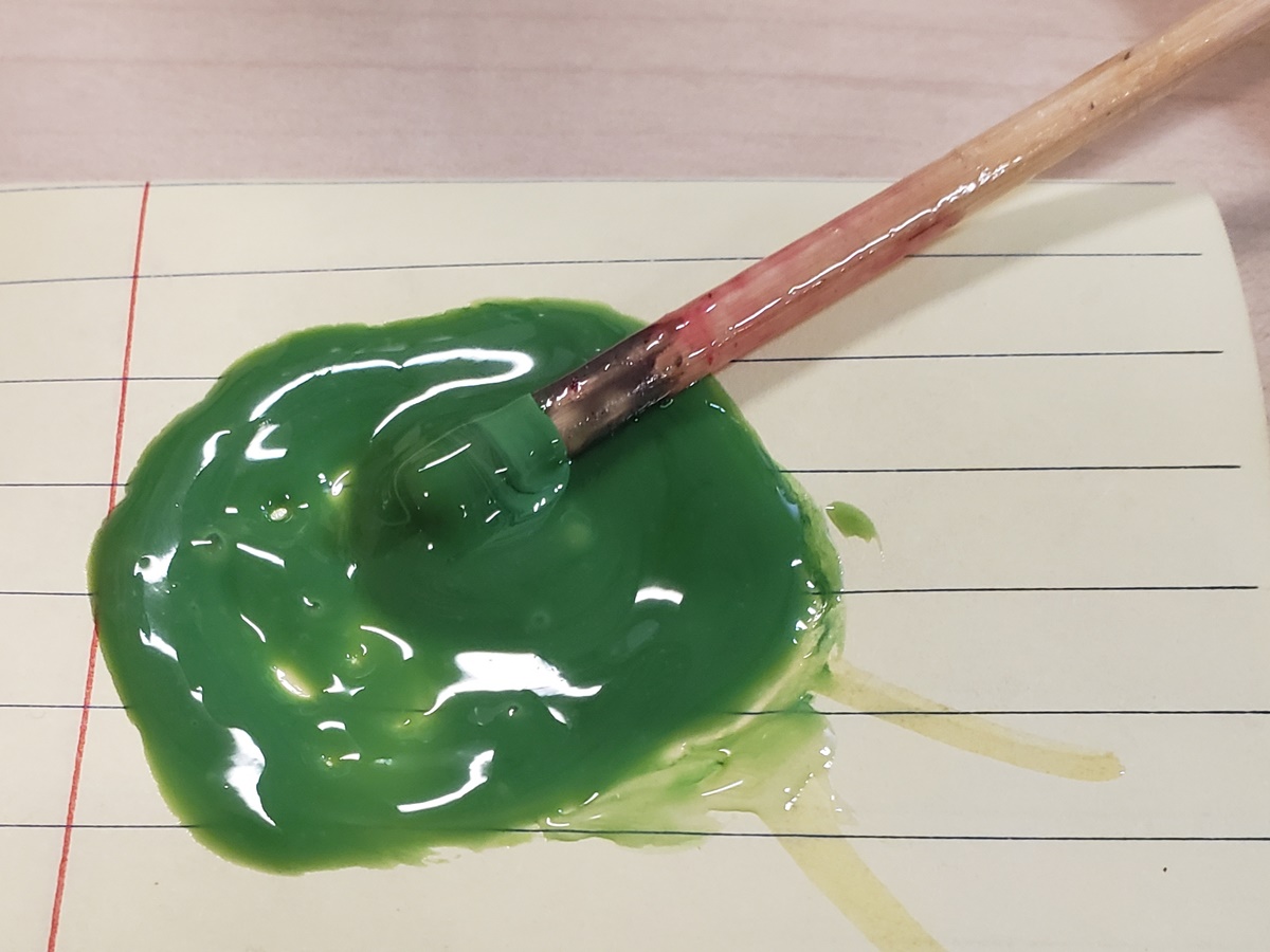

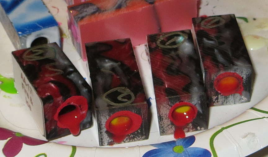

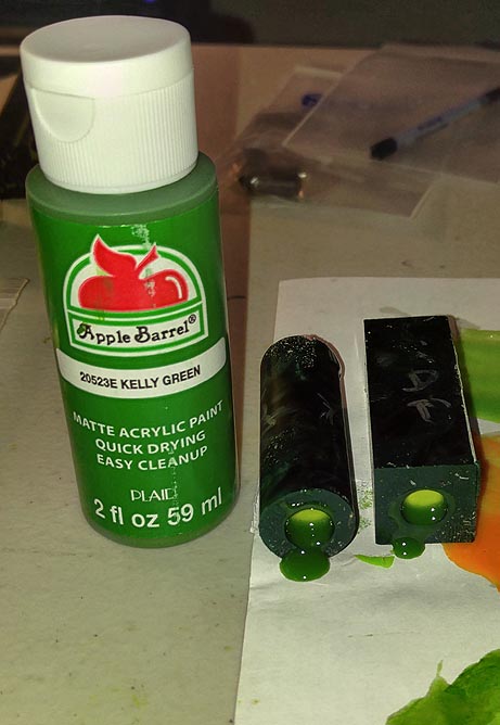

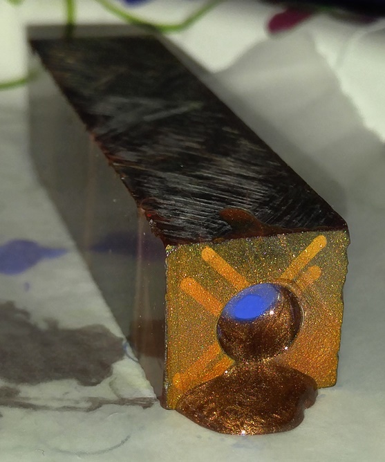

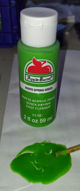

I just use cheap acrylic paint to color epoxy. Never had a problem with it. Walmart has a lot of different colors for 50 cents a bottle.

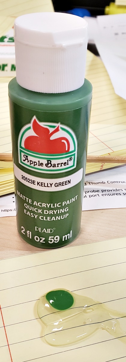

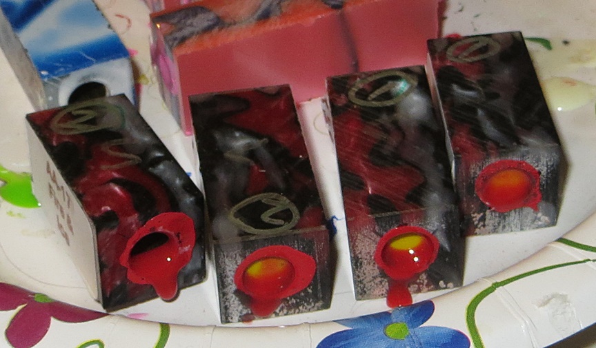

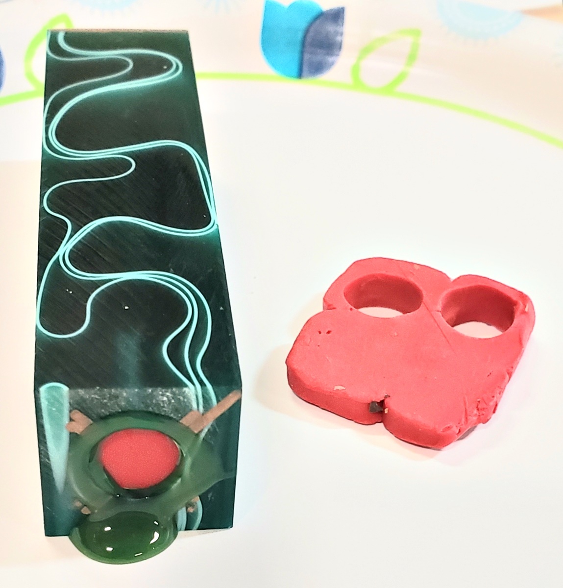

howsitwork
Jul 9, 2016
2,299
Thirsk
Never tried it as I thought the acrylic being water based might not be compatible,with the epoxy but I think I'll experiment as just got some epoxy dies to use with aluminite. Also some acrylics which were for another project but there's some left .
qquake
Feb 8, 2004
5,007
Northern California
Like I said, I've never had a problem with coloring epoxy with acrylic paint. I've done many, many pens this way.
