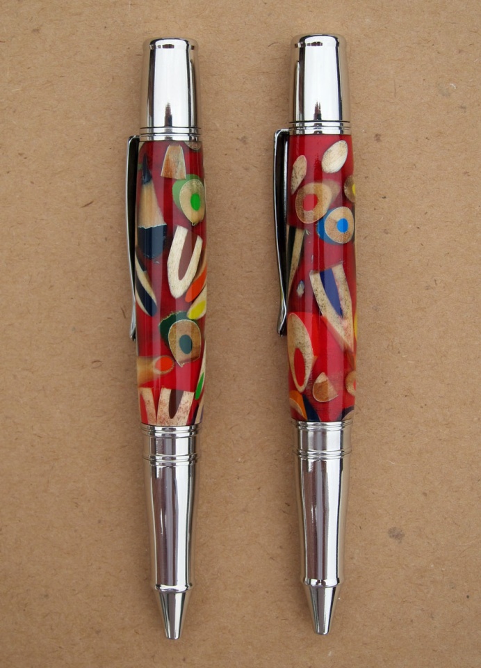

These two pens are my first time placing some object in a blank and casting it. These are the sharpened ends of colored pencils cast in resin.
After casting, I drilled the blank and painted the inside of the blank and outside of the tube red. I then VERY CAREFULLY turned the pen. Finally, I covered it with Mercury CA.

You've created very effective and fun pens there. Look forward to seeing your next creations.
Sent from my Nexus 6P using Tapatalk
Those are great, especially for a first attempt at casting. I too think the randomness of the pencils gives an overall better look than when they're lined up.
