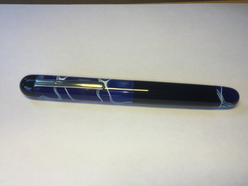

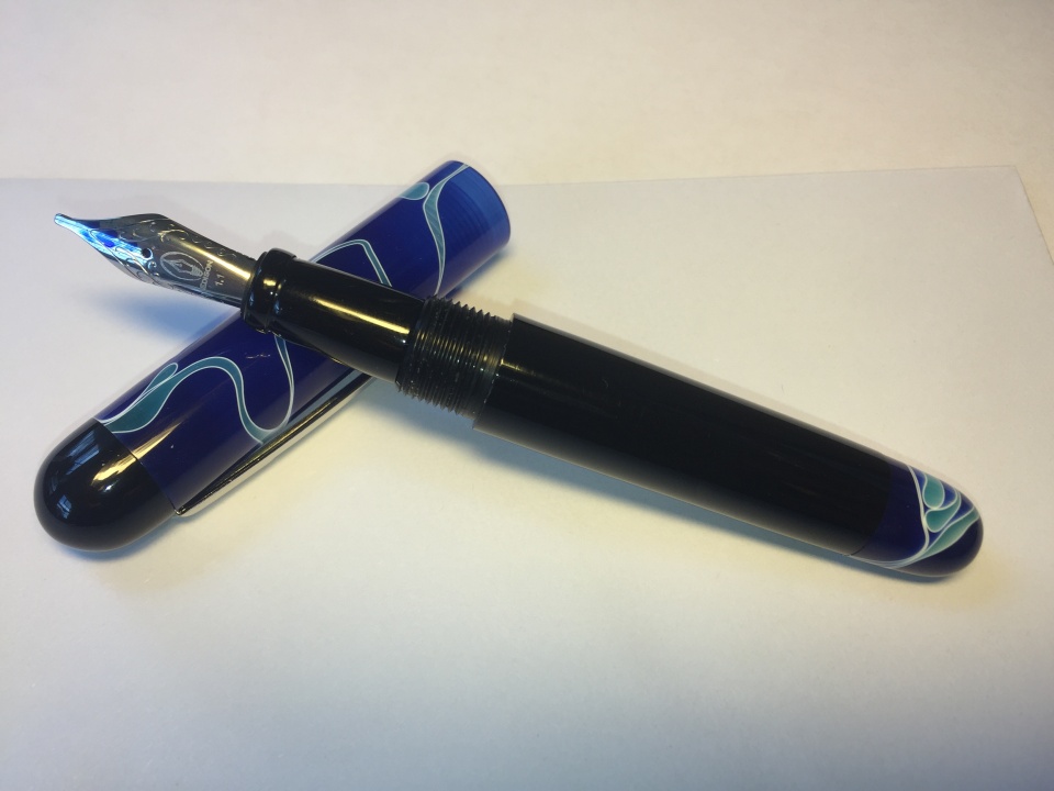

So here is the first pen I have made. It has some small flaws on it due to me not having needle files for the clip. I made it work with what I had and will be getting some files for future pens. I had a Edison replacement nib laying around hence the nib. I will be purchasing some Jowo nibs for future pens. Let me know what your thoughts are and sorry in advance for the crappy cell phone pictures!
