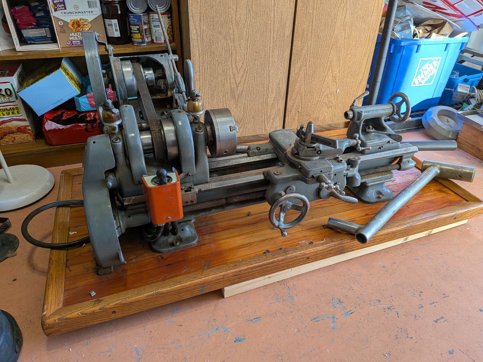

Just hauled this 80 year old machine into the garage. The cabinet it was on needs fixing before I can mount it up though.

I'm still getting the cabinet and everything set up. Soon I can start assessing the lathe. MUCH cleaning in my future at the very least
