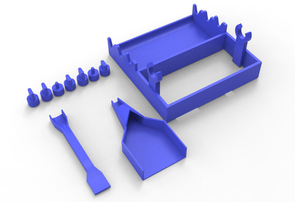

I constructed a "station" along with some simple tools.
Inlay Station

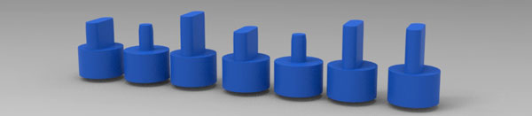

The wood blanks were held on 0.25" bolts. Since I make a few at a time, there is also a drying area.

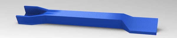

A few simple tools for pouring and packing powder material streamlined the process.

Also, a little masking tape on the "spatula" end of this little tool made it somewhat reusable.
Whereas these little packing tools were basically disposable.

3D Model
I'm attaching the 3D model for anyone who has the ability and interest to print it.
I tried to be efficient with space so that everything prints within a small footprint.
The file is called InlayBox.zip which contains an .obj file
