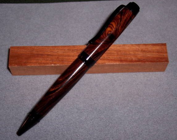

jbyrd24
Jan 23, 2005
356
Winston Salem, North Carolina, USA.
Here ya go Jim:)
It's a lousy photo, hope you can see the grain.
Ended up finishing it with 2 coats of Behlens Woodturners Finish,
and 2 coats of TSW.[:)]
<br />
JimGo
Jan 24, 2005
6,498
North Wales, PA
ALRIGHT! It's about time Bryan! [:D] Yeah, lousy pic, but it REALLY shows off the finish and the grain. That is BEAUTIFUL! Congrats!
