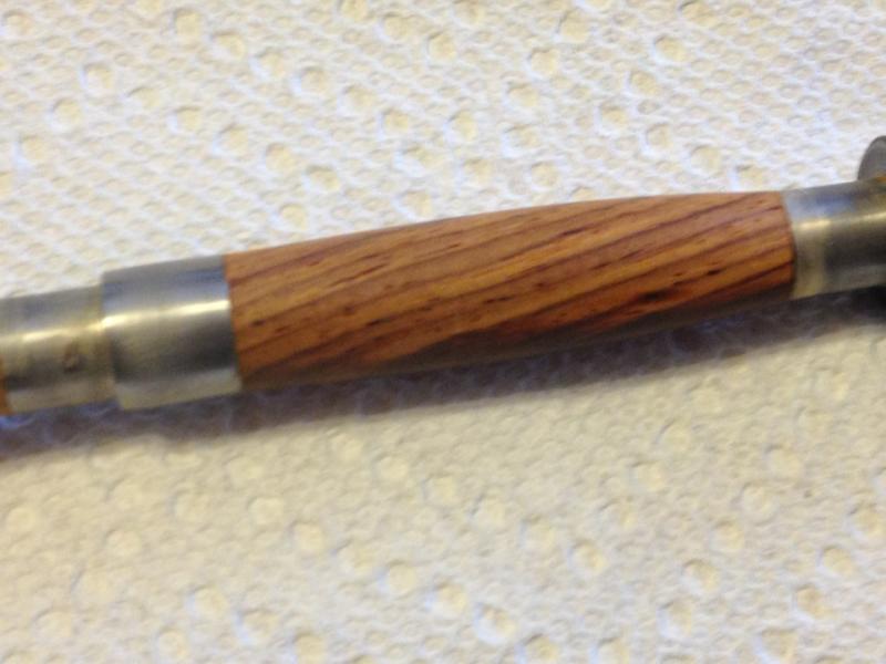

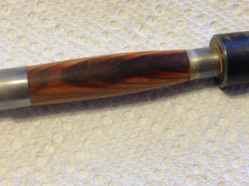

I purchased a 10 pack of cocobolo from PSI, all of the blanks have a dark exterior as if something was applied to them that has soaked into the wood. The centers of the blanks are much lighter in color. One of the blanks didn't drill straight so one side of the pen has a dark streak down the side where the drill went too close to the "stained" wood. Is this something natural in cocobolo? Or has something been added to the blank to darken the exterior?
Took a couple pics with my phone, maybe someone can verify this is a normal appearance. Also note that excess CA when gluing the tubes came off with an orange tint picked up from the wood.

That is normal for cocobolo. Over time, it will darken. You can speed up the process by placing it in direct sunlight. The orange tint in the CA is evidence of the cocobolo oils mixing with the CA.
I think some suppliers must immerse the blanks in a stain. I say this because I can't conceive of these blanks being exposed to light on all four sides so evenly.
In my experience, there is a great deal of difference in cocobolo depending on its origin. The lighter stuff isn't as desirable. That's why suppliers try to make the blanks look like something they're not.
Certainly cocobolo will darken with exposure, and even the darkest cocobolo will darken more soon after cutting.

In my humble opinion I would consider wiping the Cocobolo down with alcohol to dry the oil out and you can see the real color.. My two cents.
