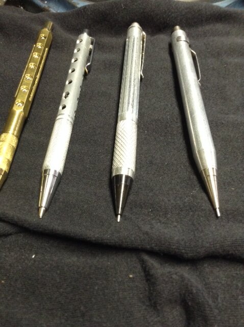

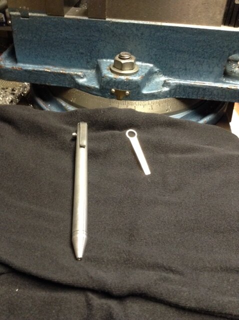

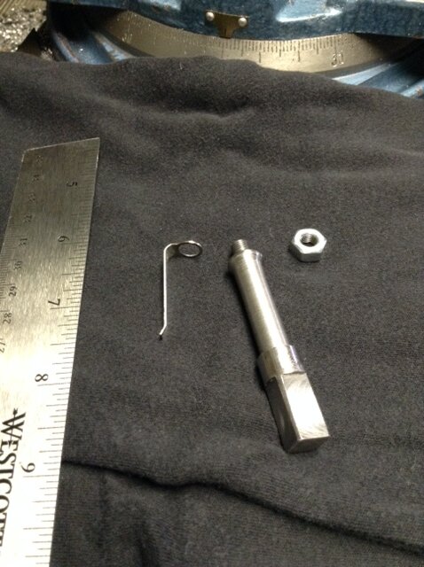

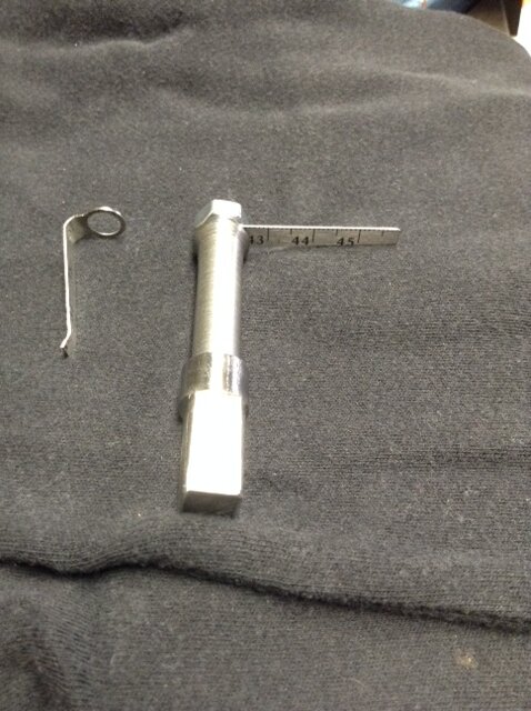

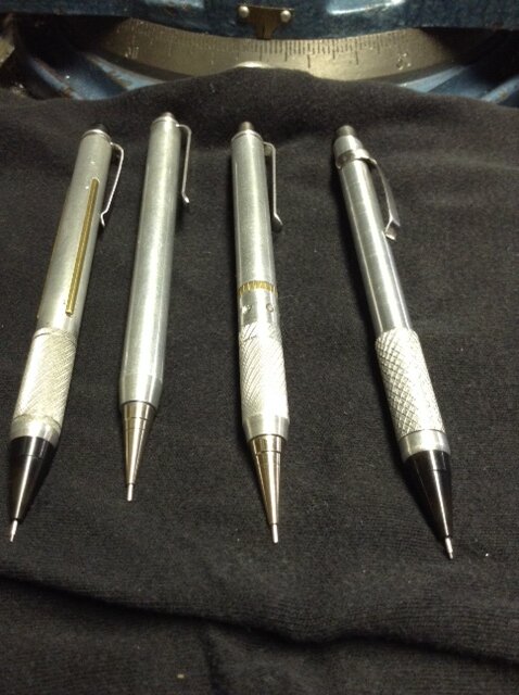

I'm attaching pictures of some of my experiments including the jig for bending the clips.
I hope this info can be of some use for other experimenters.
Blessings....Tom
