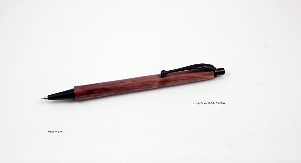

Sierra or any pencil kit. Depends what you want to do with it. This one's from PSI and I made it a one piece. The lead is a .07 B. I like the darker leads. So look at them all and have fun, they're all pretty good.
