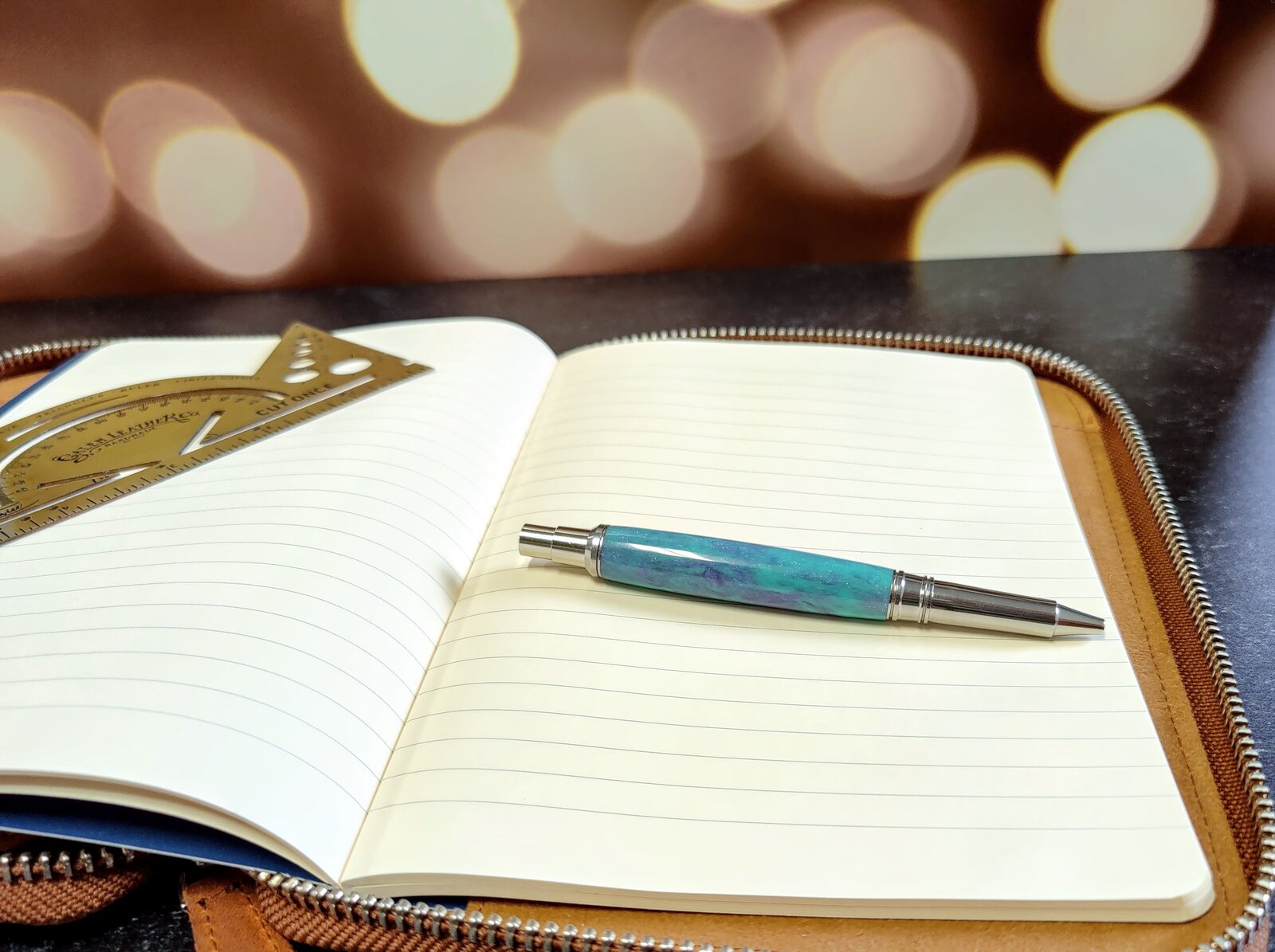

Well.... I'm not the cheapest... but... If you want US made solid stainless kits for your project we can probably work out a bulk discount. They're out of stock on the website, but we've got 1k kits in the shop right now going through the finishing process. No plating to fail, machined from solid stainless bar stock in GA then sent here to NC for finishing.

Tim please do not take this comment as a knock of what you are doing and you have another thread asking for suggestions on what to do next. But the photo you just put here is an exact example of what I am going to say and why I posted here. This pen and others you are bringing back and making, to me look more machined or robotic than most pens on the market. In that what I am saying too much metal showing and you do not let the blank do the talking. That nib is too obtrusive and screams uncomfortable. They remind me of many rollerballs that have that front end that is all metal and such a small barrel for the blank. This type pen does not need that. Just look at the German pen above and you will see what I like to call a comfort pen. Just an opinion and as everyone here has them so I voiced mine. Maybe something in the future to redesign some of pens you are bringing back.

You have an opinion?! I never noticed! šŸ¤£ I would say that "robotic" is a bit far. It's pretty classic pen profile all around. I distilled your comment down to: You don't like metal sections. That's fair. We are working on a minimalist setup with just a nose cone and a back end to hold a clip down and thread in the click mechanism. It'll require you to be able to thread the blank but will absolutely be the most blank you can use with this particular click mechanism. (I refuse to add spacers inside the pen) I will say that this pen is one of the most comfortable I own. I carried one for several weeks prior to making them available to ensure it wouldn't have any failure points I didn't take into account in the design phase.
Fair points and it is your business but I ask you to look at all the pens in this field of genre and see what most look like. Short metal nibs.
