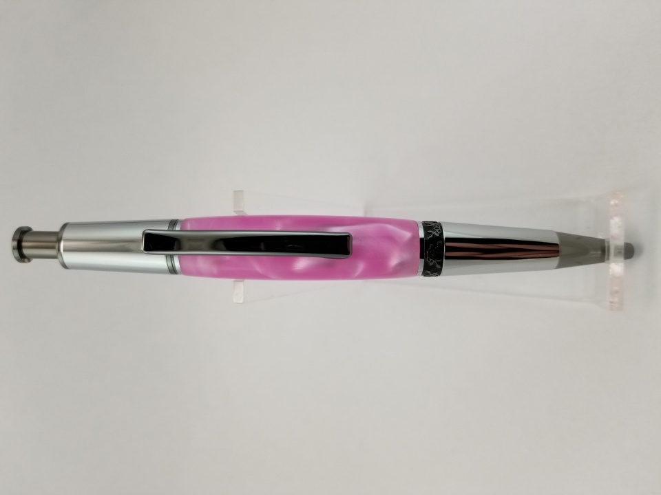

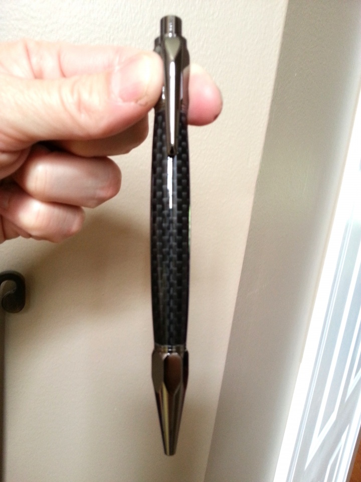

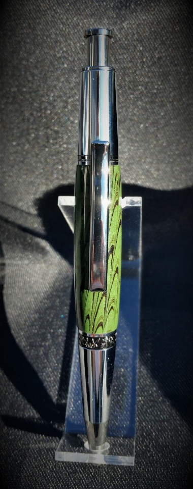

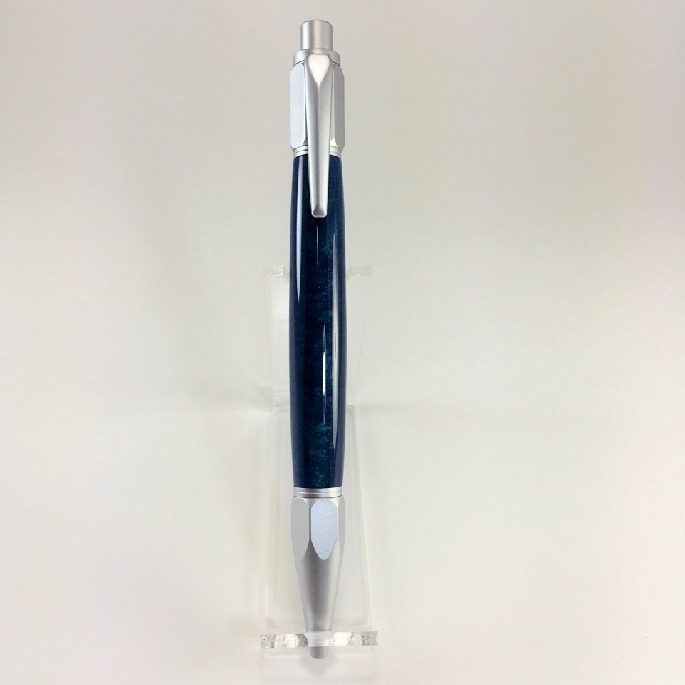

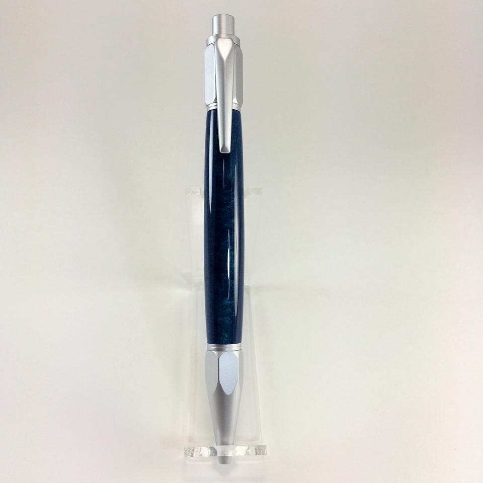

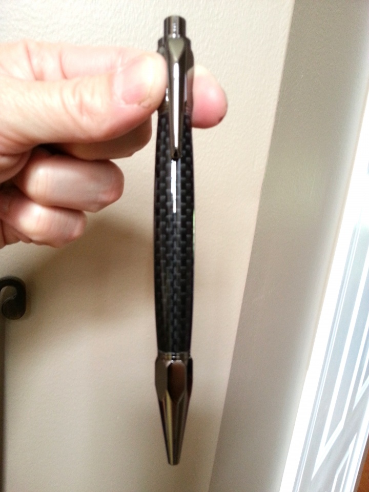

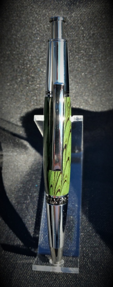

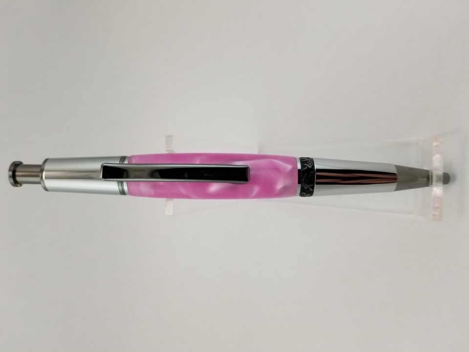

Like you Denny, I have not been impressed by many. I find the Vertex, Aero click, and Spartan to be decent. None have come back to me, but my clients may not have informed me. Here's a few.
