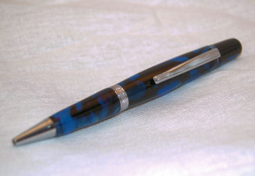

Like the others, I've had good luck with the Sierra click. I don't like the spacer you need to use a Parker refill, though. It's too easy for the client to throw it out with the dead refill. I cut the tube down to 1.88". That way, it only takes the Parker refill. I think the pen looks better being shorter, too.
As for replacing the black plastic part, I've done it with acrylic on a non-click version a couple of times. It could be done in wood, too. Here's a pic (bad quality) of one of them.

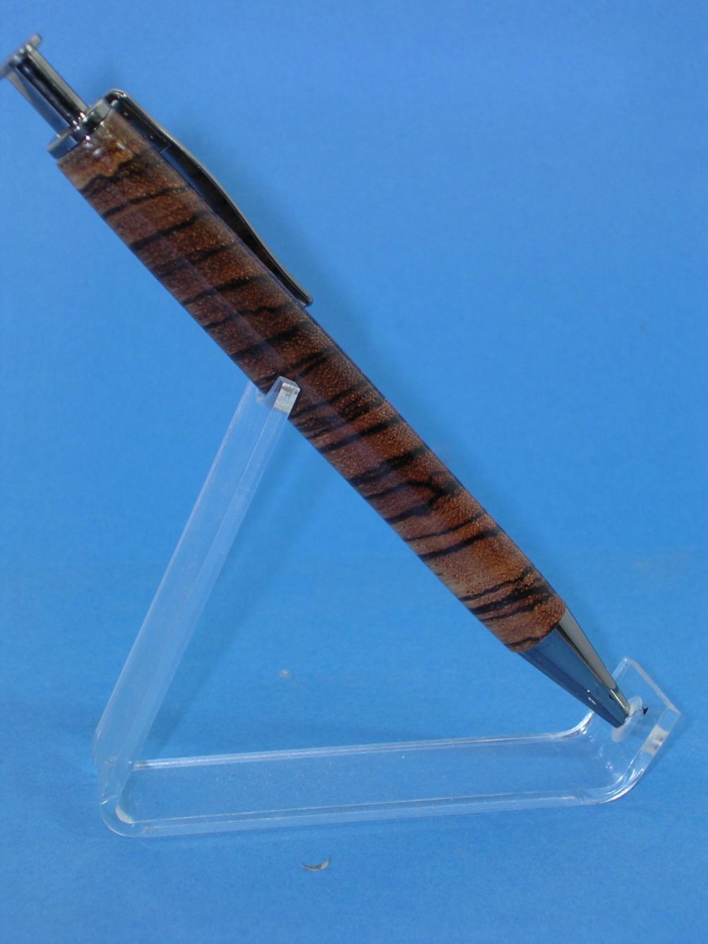

I like the long click pens and have had happy customers with them.
Ralph
