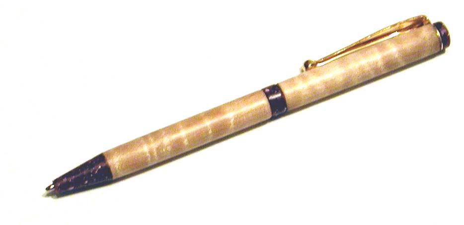

It can be done. Here is one I did a few years ago just to do something different. I did use the clip. Other 'kit' parts are made from corian.

It is "kitless" as described and only took about 10 minutes. I didn't polish the brass though, just trying to see how quickly it could be done!!!!!

Yep it's kitless , not exactly what I had in mind but it is within the rules and as such is allowable , and thank you for an idea .
for everyone wondering how to "make a nib" , here's your first solution "Bite the Bullet" well not literally but you could try using a "Copper" (I do believe they are copper) bullet from a cartridge , just drill it out and figure how to attach it to the 7mm tube .
