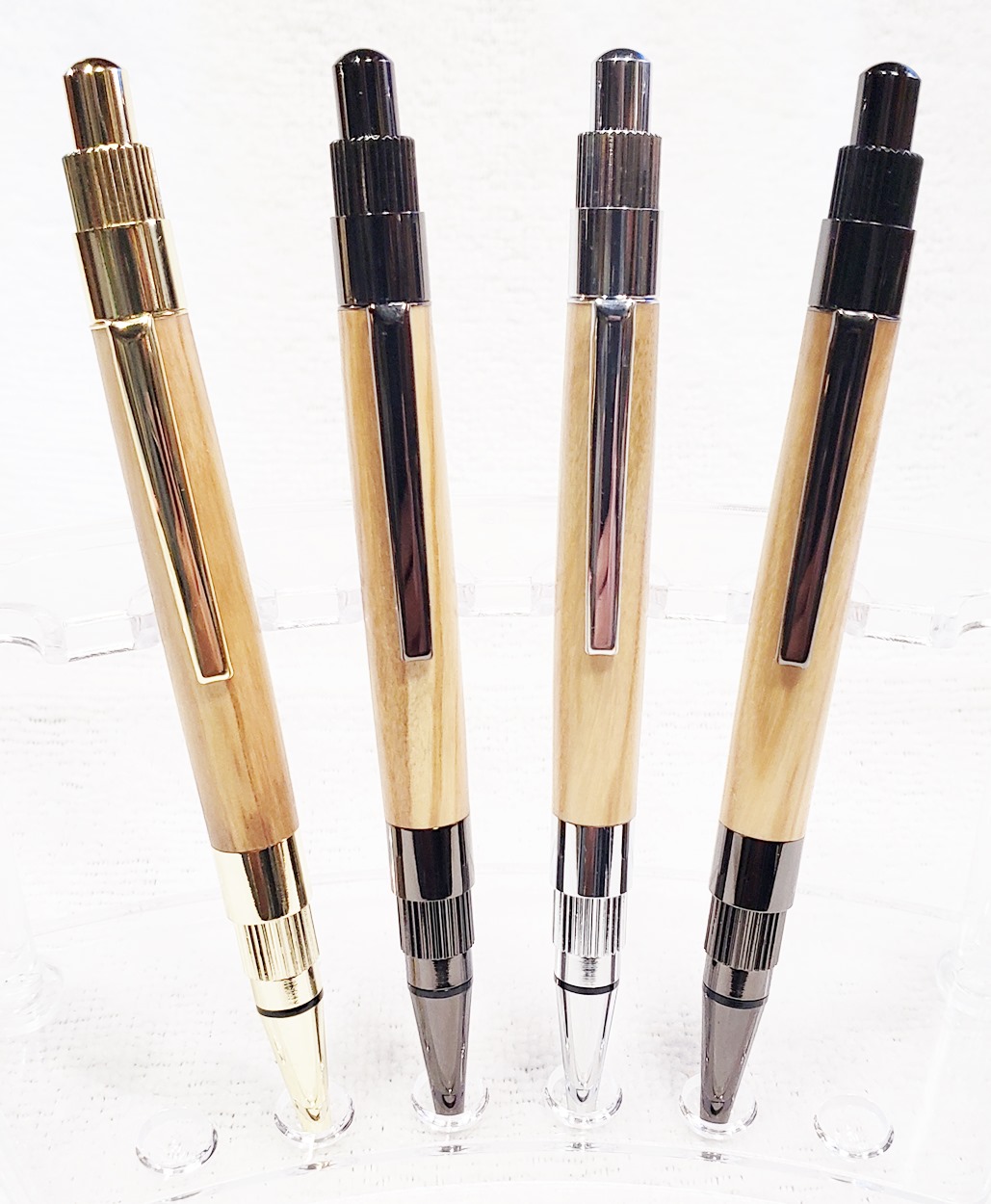

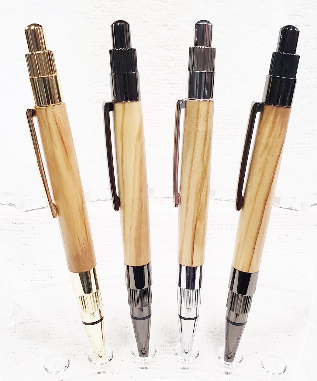

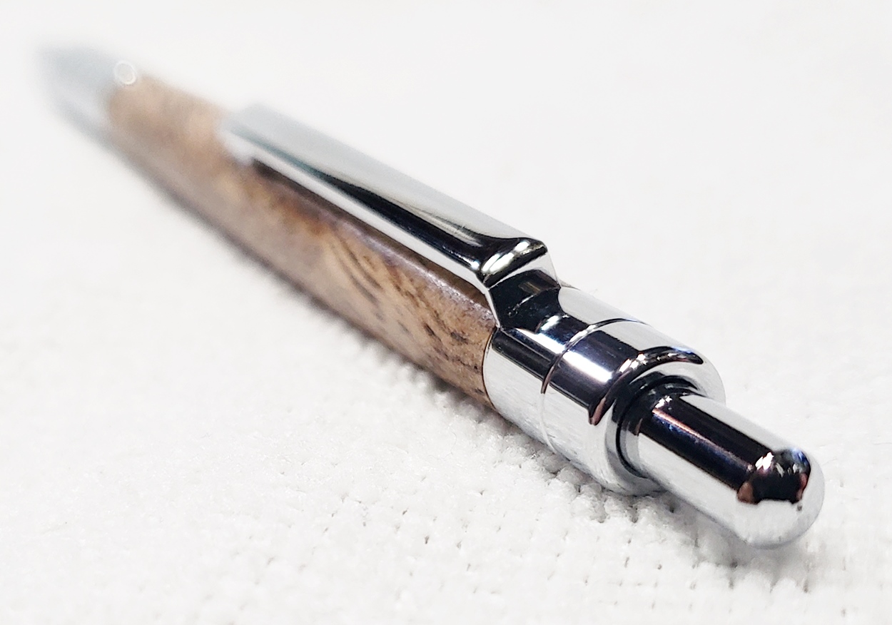

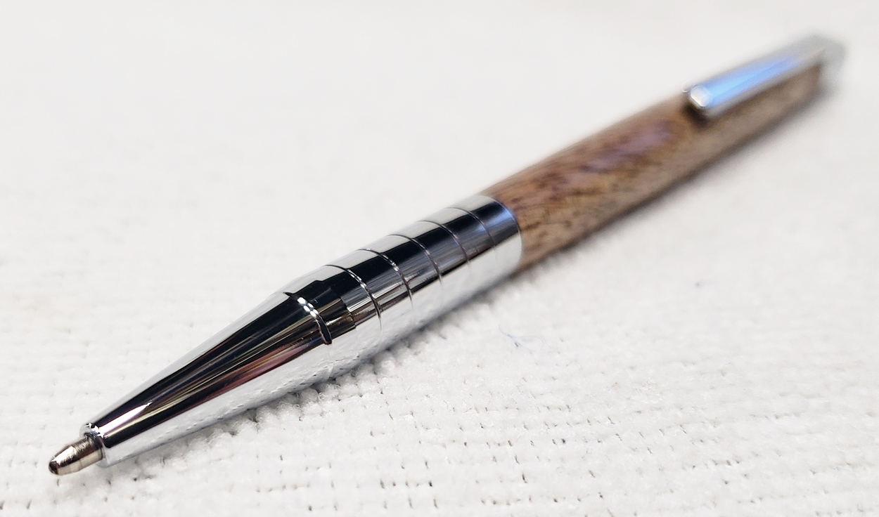

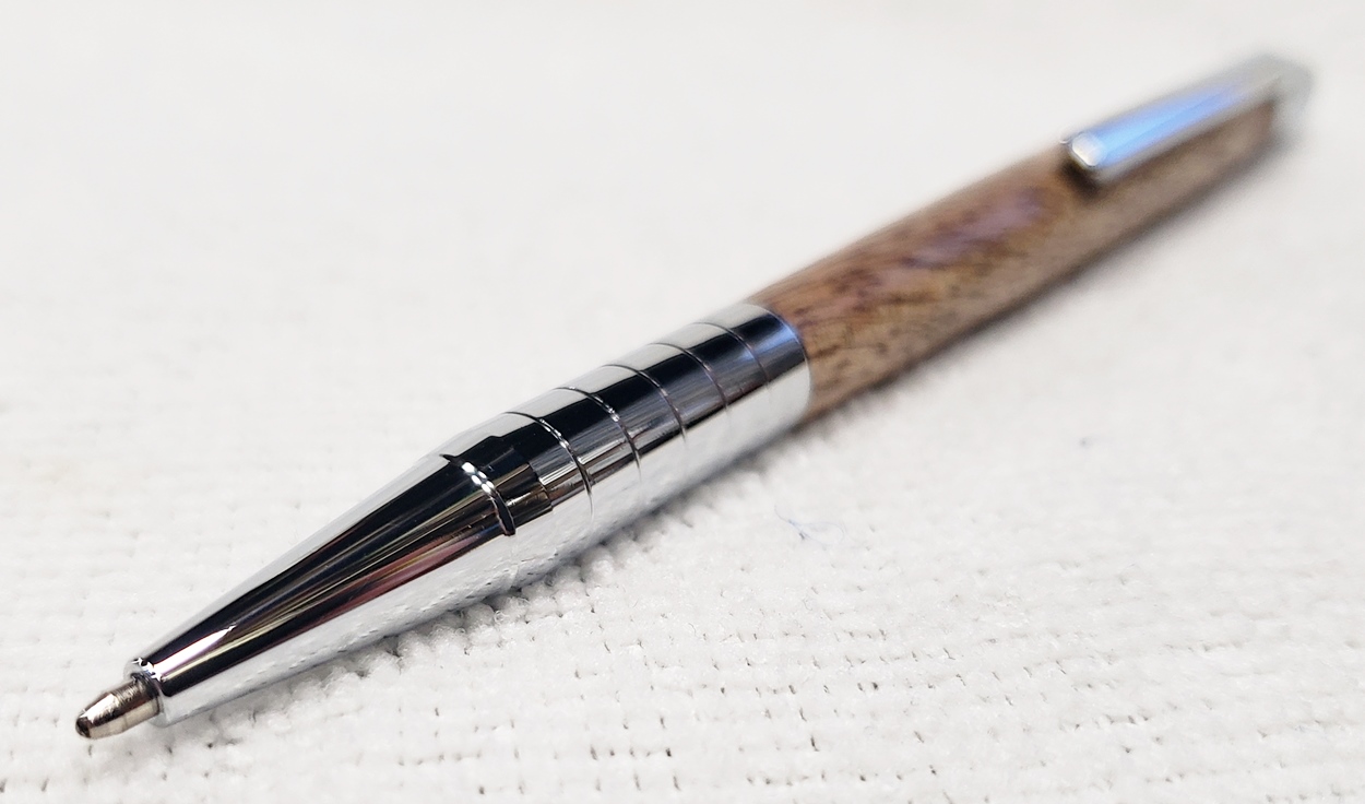

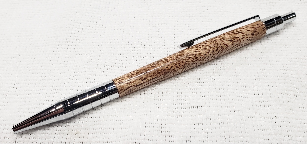

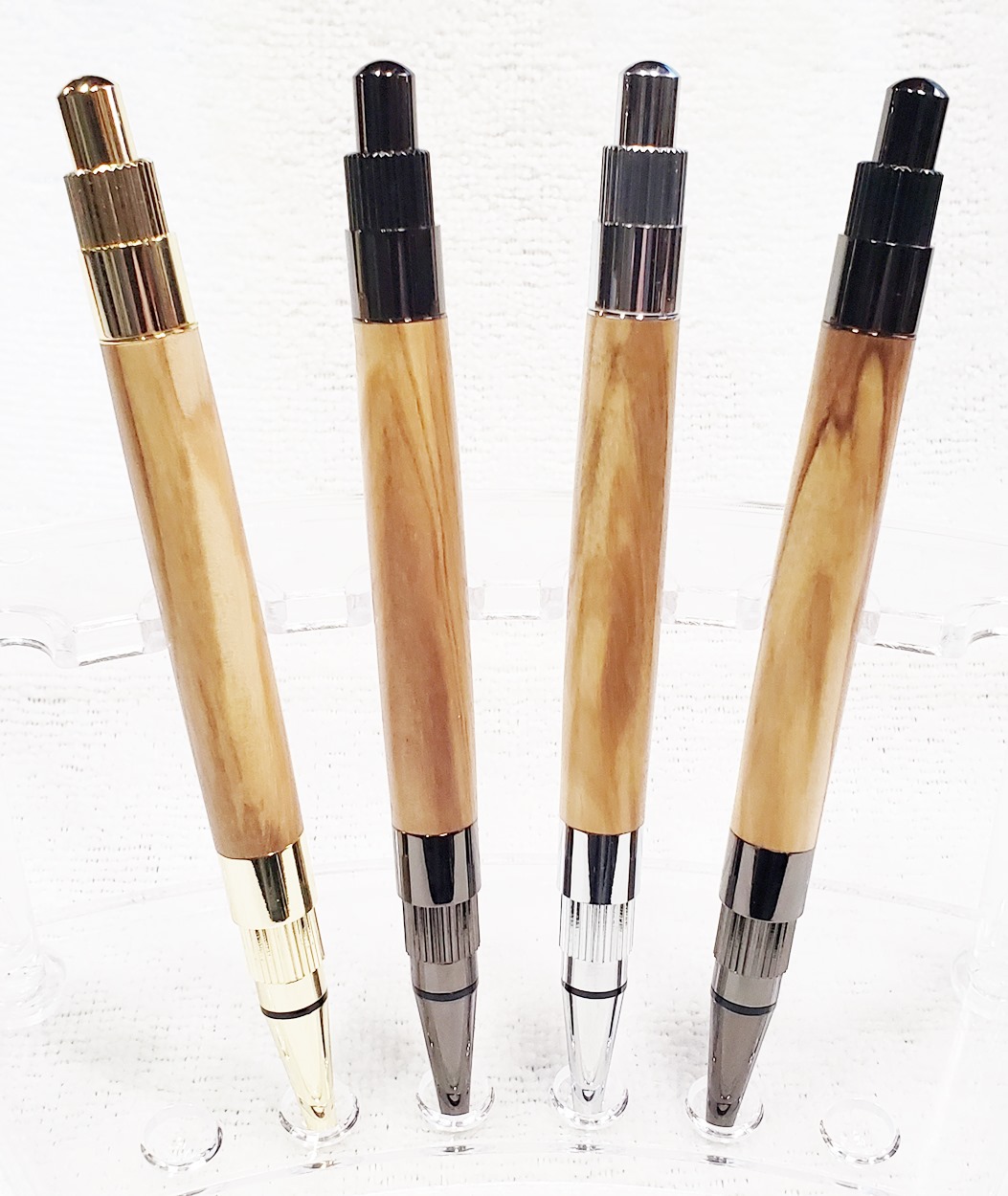

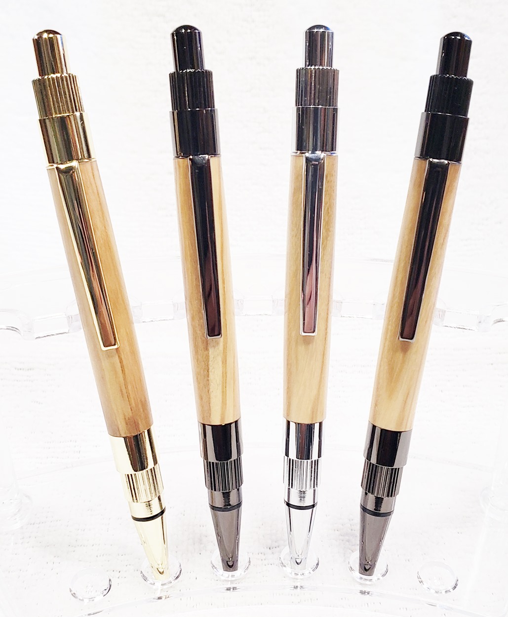

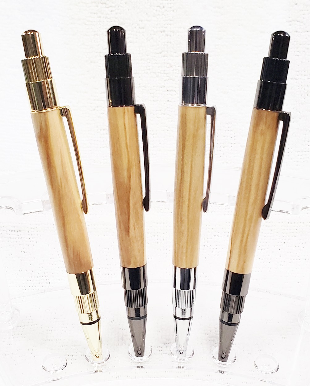

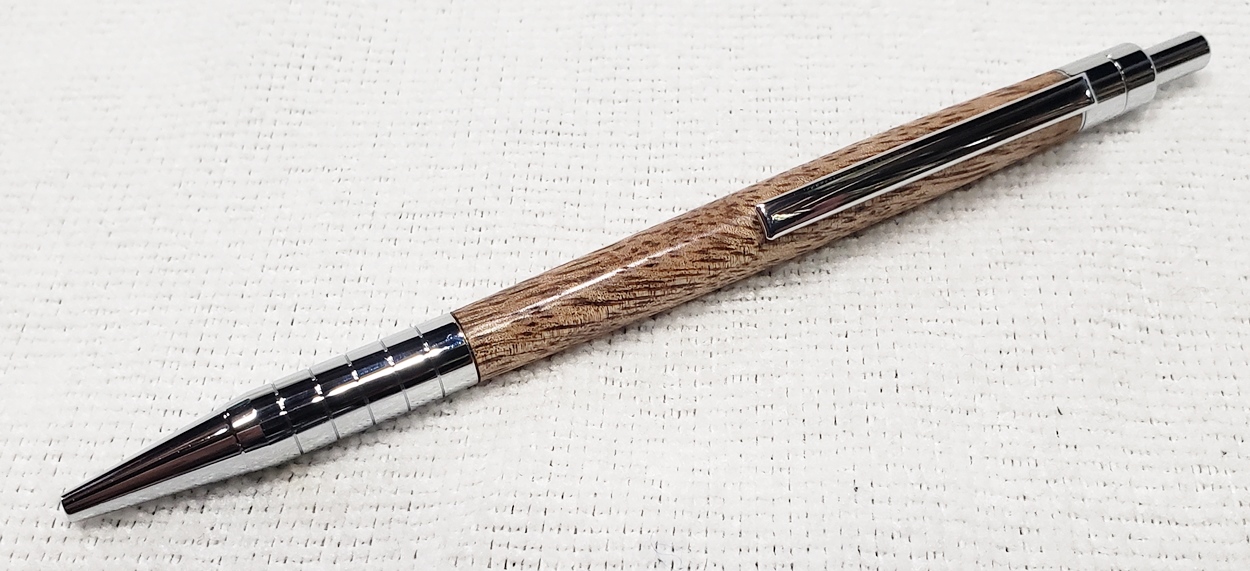

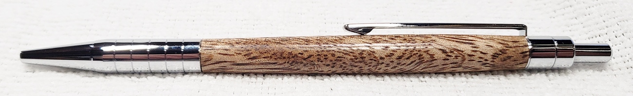

How about the Saxa from PSI? I've found that ladies, and some men, prefer a slim pen. It has a single barrel and Schmidt click mechanism. It takes a 7mm drill bit and slimline 7mm bushings. I've made several of them.

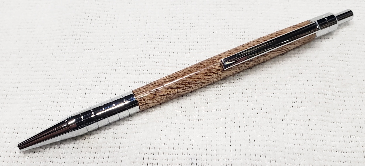

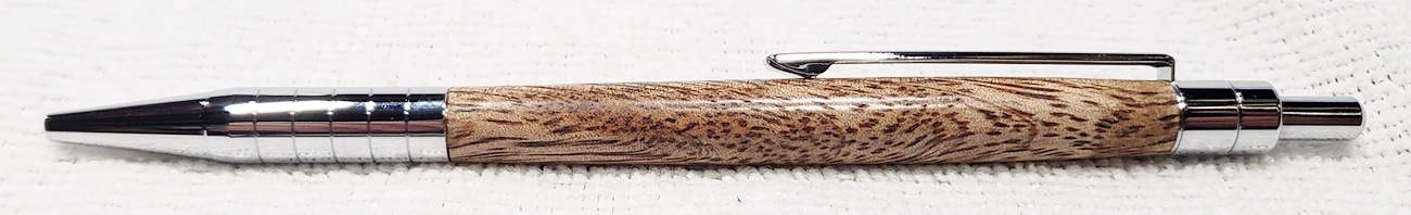

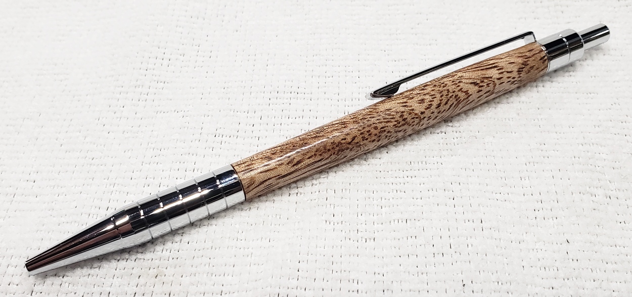

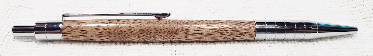

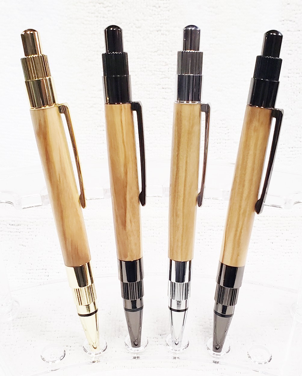

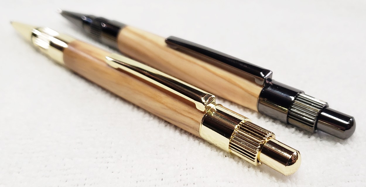

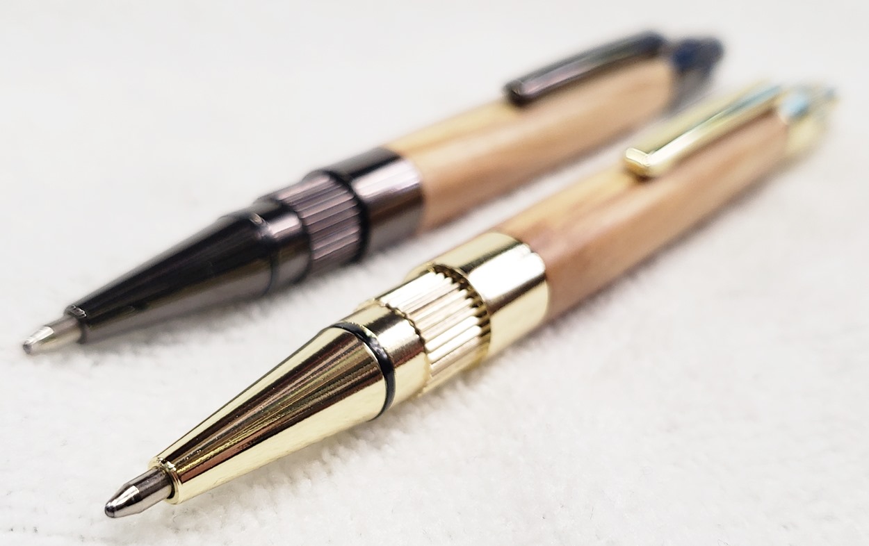

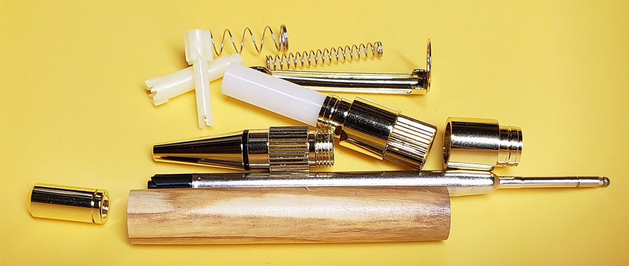

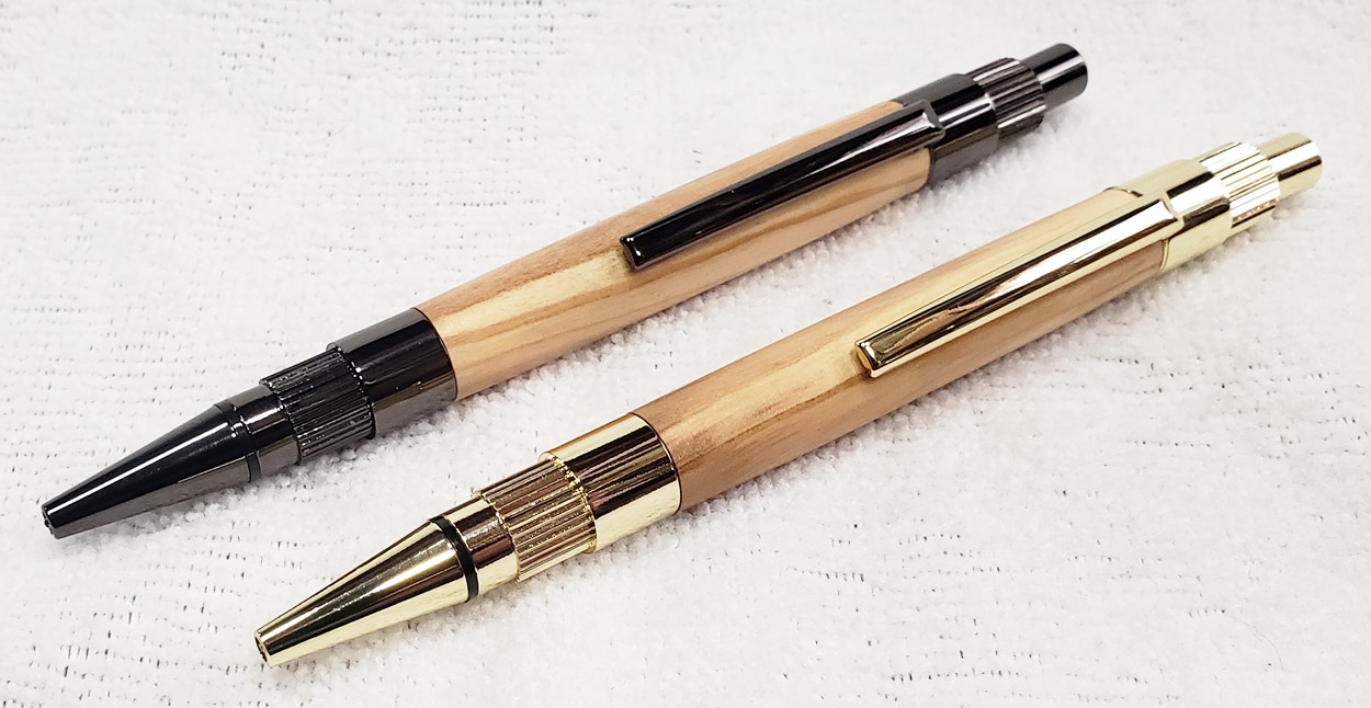

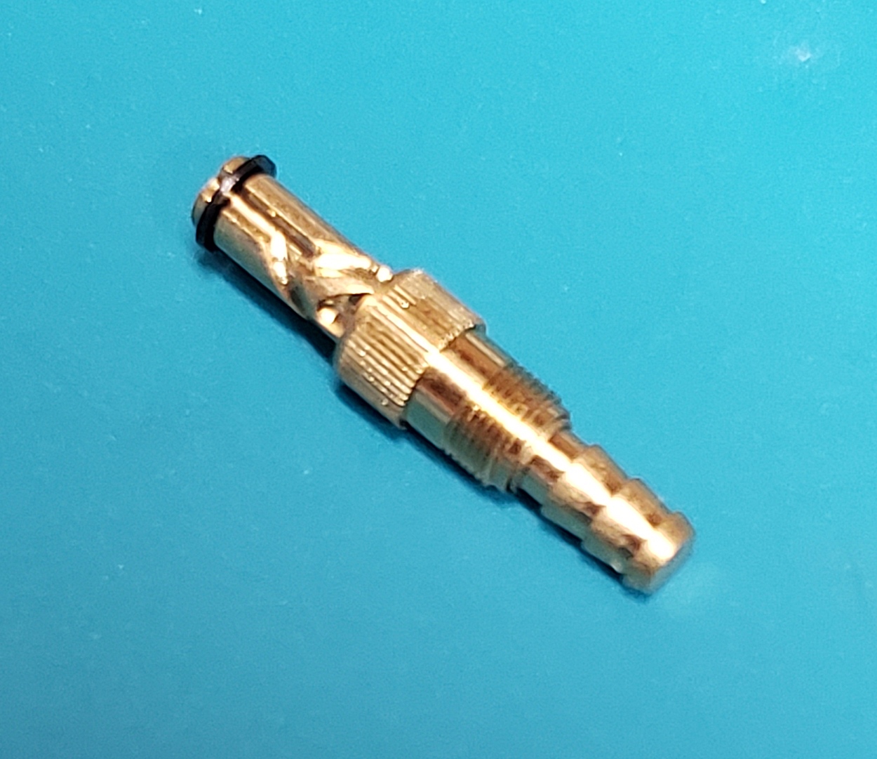

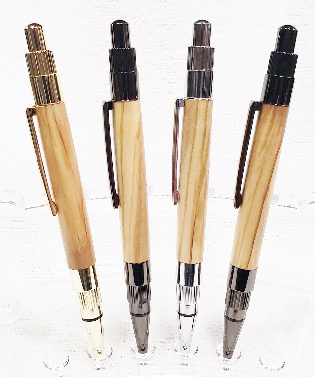

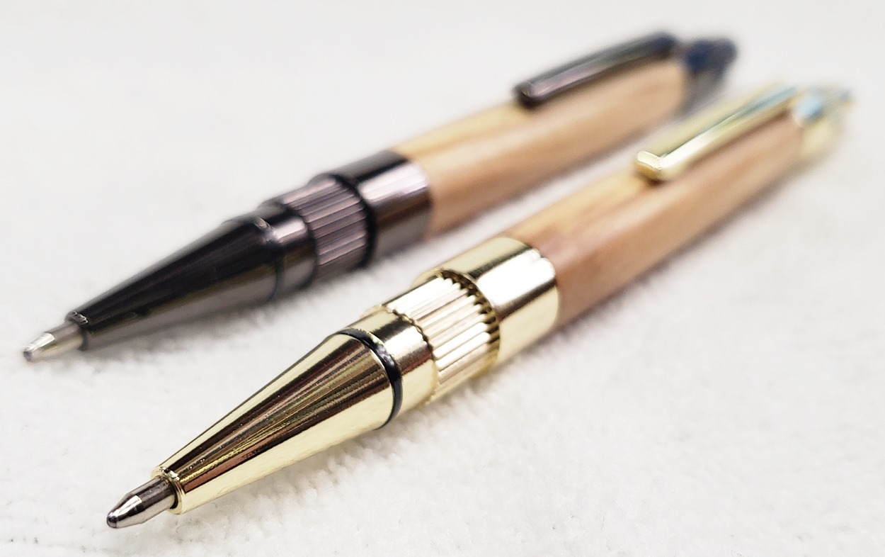

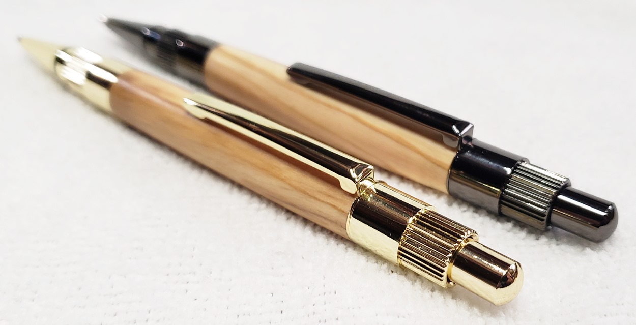

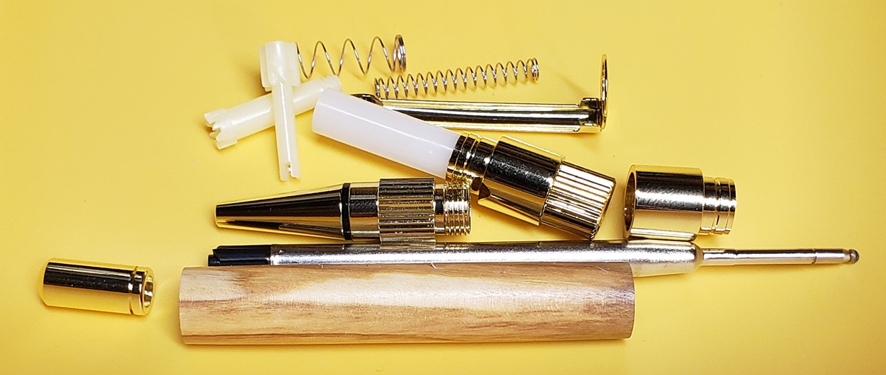

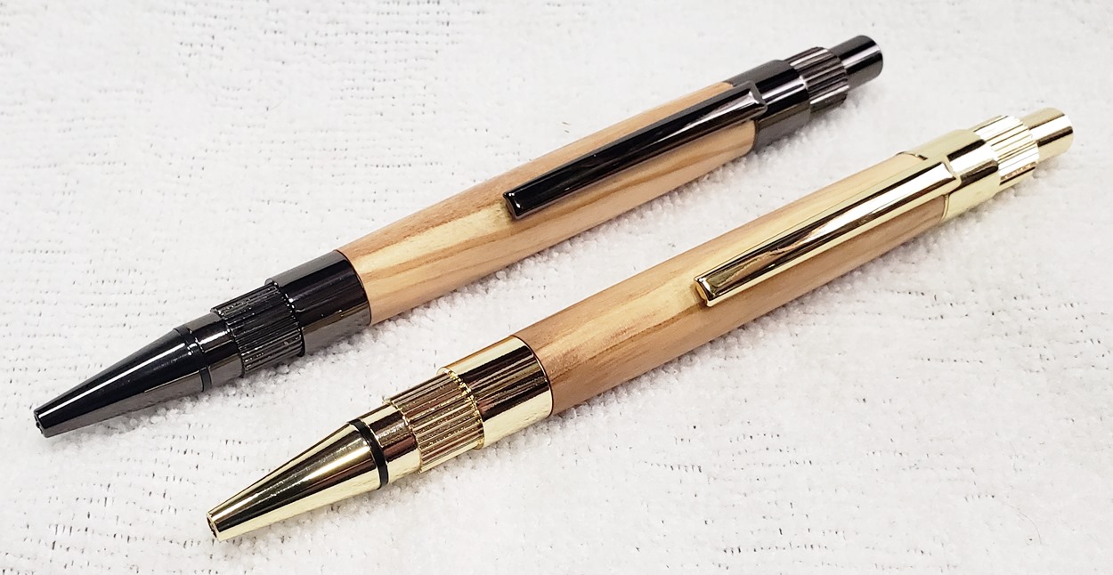

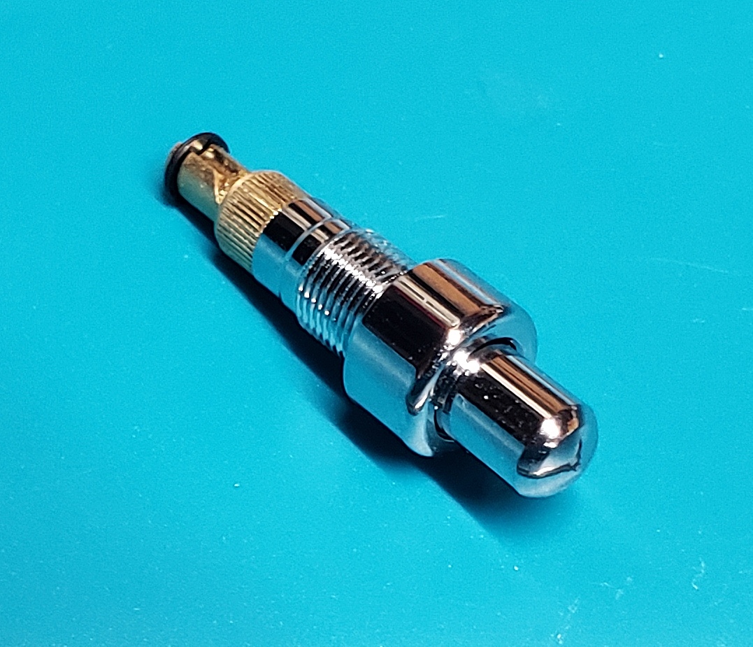

If you want something less expensive, there is the Gear click pen from Crooked Mill. It's a little bigger, it takes an 8mm drill bit, but still slimmer than some. At 25+, they're only $4.50 per kit. I prefer single body pens, especially for this many. You'd only have to turn 25 bodies, vs. 50. It has the old two piece click mechanism, but I haven't had any problems with them. I've made a few.

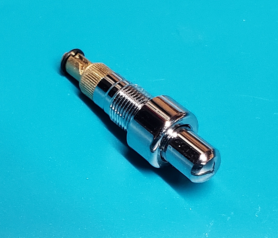

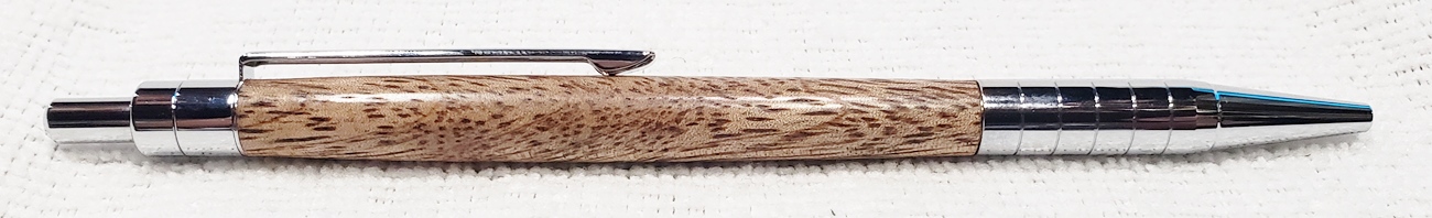

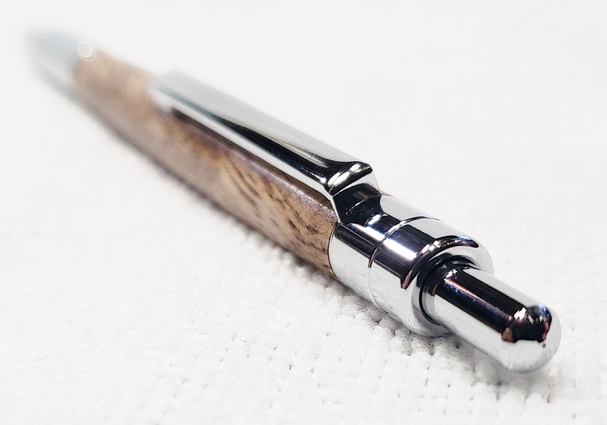

I am not a fan of the Groove Clicks. I used to use them as my slim click pen. The mechanism isn't the best and they are a PIA to assemble. I switched to the Slimline Pro EDC. Better mechanism and no crazy hoops to jump through to assemble. It is a change from a 7mm to an 8mm tube tube.
