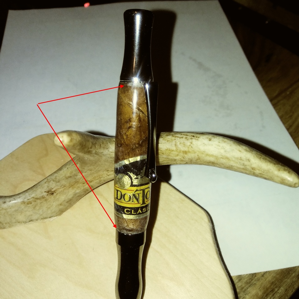

check this video... i tried it with not much success. i think its because the leaves were still damp. (see picture)
https://www.youtube.com/watch?v=nsbzhmCM4CA
so my next step is to make sure the leaves dried out then apply a thin coat of pudge and then thin coat of CA on it before casting
here is what they look like....

here is the result... came out not bad except white spot at end of tube. Anyboy have any idea why
Any idea why
swcrawford
Jul 2, 2013
31
Were the white spots there when you took the tube out of the mold? How did you square the blank to the tube (with a pen mill or sanding)?
To me that looks like the resin de-laminated from the leaf during turning or trimming. If I were trying this project I might do the steps you did to cast the leaf, then:
1. Make up a jig to square the ends of the blank to the tube by sanding, not with a pen mill. The mill teeth may grab the leaf and cause the de-lamination which may not be readily apparent until after you turn to shape. I use a sanding jig on the lathe made by member Rick Herrell (rherrell) and it works great. I square all my blanks this way now. (By the way, he is offering 20% off all his products now during the birthday bash.)
Also, make sure you square the resin back all the way to the tube. Really important. Whenever I get in a hurry and neglect to do that, the inward pressure from the bushings can cause exactly what I see in your picture.
2. After squaring the blank to the tube, put a little bit of thin CA at the end of the tube/resin junction. It should wick into the joint there and give a little insurance against de-lamination when turning. I do this whenever I cast something thin wrapped around a tube to keep this from happening and also to keep water/sanding slurry out of the blank since I like to wet sand resin blanks. Just the tiniest bit, let it cure, and then re-sand the end to smooth it out.
Give it another go. I think you are really close to a complete success.

thanks...i think you 'nailed it'. the white appeared after turning. I did use the barrel trimmer. i will try as you suggested.
what do you think about putting the tube in the oven at very low temperature so that the glued (podge) leaves drye
swcrawford
Jul 2, 2013
31
Drying in an oven at really low temp shouldn't cause any problem. Just let it cool before casting. I never do. I've just learned to be patient and come back to a project later. Getting in a hurry has caused me more problems than just about anything else.
