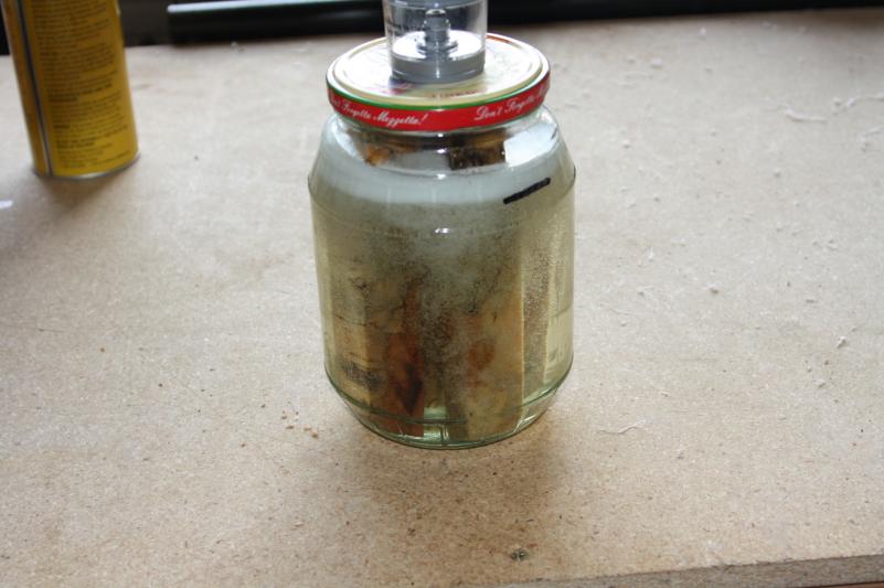

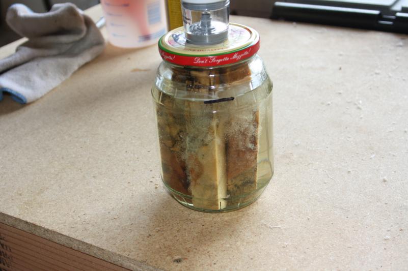

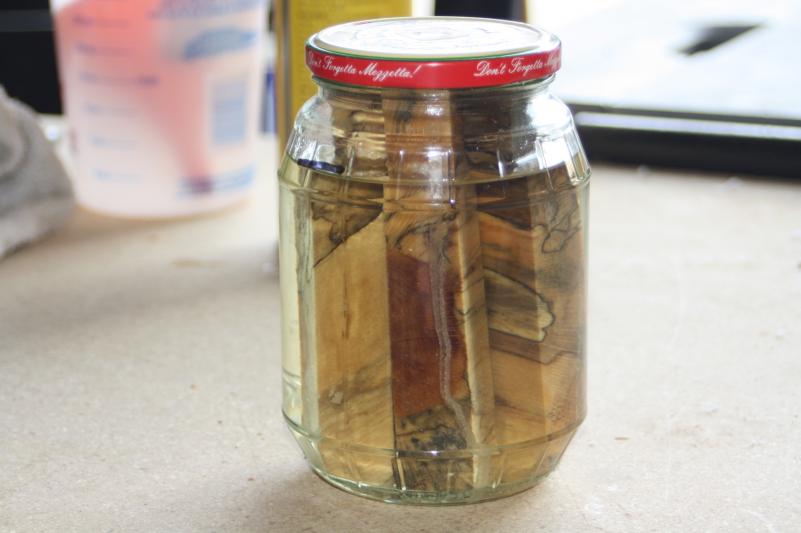

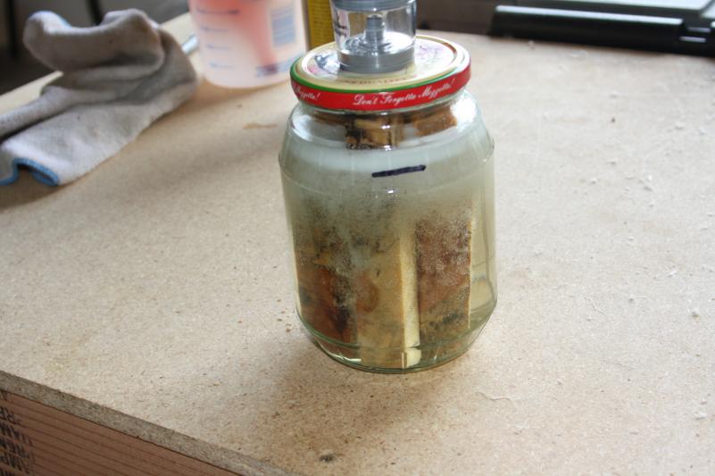

My version, a hand held food vac pump from W-mart,($22) pickle jar, Minwax wood hardner. Kept the pump on til the bubbles stopped. Flipped the blanks, vaccumed again. Now letting them dry. Started with 24 oz of hardner, when done had 17 oz left. used 4 blanks. Didn't weigh blanks before or after (should have) If nothing else , sped up the time for the product to soak in.

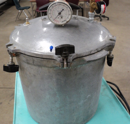

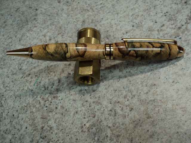

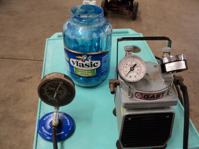

Redneck, home-made and, "hey, watch this" is what innovation is all about! lol It may not be 100% stablizing but I have been experimenting with the same process! I mean, poor folks gotta' make do with what ya got. I drilled a hole in the lid of a pickle jar, threaded in a fitting, and hooked up a discarded pump that I found & pulled a vaccumn for a while.
Then I soaked the blanks in some discarded stuff from Sherwin Williams and put them in a pressure pot for a while (again discarded stuff) and turned out a decent pen...It's all about relaxing & having fun while you create something unique...Total cost: Less than $10.00

Brake bleeders suck (and not in a good way!). It takes quite a while to pull vacuum and you need a constant pull with the pump running for best results. You could pump it down, let it set, come back and pump again, repeat, repeat, repeat but it is going to take a good while.
