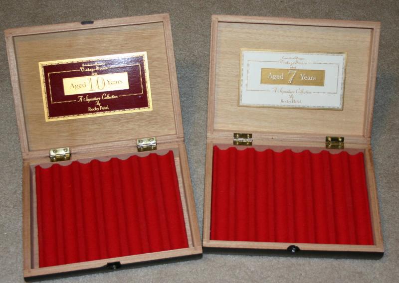

Picked up a few Rocky Patel cigar boxes from ebay. I have eight more boxes to prepare, so I should get back to the shop. :biggrin:
Box on right holds 8 pens. Left box holds 7.
Thanks for looking. As always, comments welcome (constructive criticism encouraged).

Those are very nice Tim. The seller maybe didn't have the original insert on the one case as it doesn't quite fit right?
Thank Jeff.
I make the inserts from 1" wide single pen strips. There was not enough room for me to sand them thinner and slide an 8th in the space (like I did with the other).
Think I will cut some 1/4" pieces and wrap them in the fabric to fill the gaps. Any other ideas are welcome. I am not completely sold on that solution yet.
Suggestion only:
cut two(2) wood strips to fill the gaps and "stamp" or laser engrave your logo
tru blu on both sides that way it adds to the look of the cases and really makes it your "own". That is what I've done to a few of my own. Nice cases and the red felt really makes the pens stand out.

Very nicely done. Make a good use for all the empty cigar boxes I've got as a result of buying full cigar boxes... :)

Tim; Nice job on the inserts. The red looks good. May have to try that after I run out of black next time. I use a slant jig on my tablesaw to cut the coves in pieces of stock that I square up on my jointer and then plane to final dimension so that I'm 100% sure they are square. I find that about 4 feet is a handy length to start out with. I have a ton of 1"x1" square hardwood stock that was used to sticker lumber for kiln drying, it's kinda rough, but it cleans up nicely at 7/8 square.
Nowdays I leave the mitered spanish cedar liners in the boxes too, and use them to cover the edges of the insert, it's easier to glue on the fabric if you don't have to worry about covering the edges. Also the cigar store dude told me they "just don't look right" without them. I took his word for it, he deals with these things for a living. They also help to keep the boxes from warping as they dry out after being removed from the humidor. I hope you're not using spray adhesive to hold the fabric down. Tried that, got a couple back that didn't hold.
I also found that it's much better to cut a insert out of some sort of thin wood and glue the strips to it, rather than trying to glue them to each other. Seems that no matter how carefully you square your stock, when you glue 8 to 12 pieces side to side, some cumulative error creeps in and they don't want to lay flat. Besides, if you glue them to a backer square, you can use spacers between them to space them out and eliminate the gaps at the edge. (I cut up usps flat rate envelopes into strips the same height as my inserts, then trim them off with a disk sander) I try to have enough space to leave a double thickness on the outside edges now, it seems to look more finished for some reason. Anyway, just a few observations from having done a bunch of these, YMMV.
Thanks for the comments.
I leave the liners in the boxes, until I have the inserts ready. I do find some measurable changes in the boxes from the time I received them, after they have set in my shop for a few days. The inserts help keep the boxes from warping. (I have one where the inserts were removed, after a week in my shop the box won't close.) I like the framing the inserts provide and will probably used them.
What do you used instead of spray-on adhessive? These boxes are for me, so if they come loose, I will just repair them. I am planning to make some for sell, so I would like to know a better method.
Great suggestions. Thanks.
Suggestion only:
I like your idea better. Thanks. Don't think I can invest in a laser engraver, but I might could get some strips printed, the cut to fit.
The red felt was just what I had on hand. I want to pick up a few swatches to see what colors show off the pens best.
I use wood glue now. I think the problem with the spray was the fabric I use, it's a faux suede, and the back is a fairly slick synthetic fabric, and just don't want to grip well. But the top part looks pretty cool, imho. The trick is finding something to hold it down tight into the coves till the glue is good and dry. I use a piece of 3/4 round weave nylon rope. Weave it back and forth till it lays flat in all the grooves, and clamp a flat board on top till it dries.
