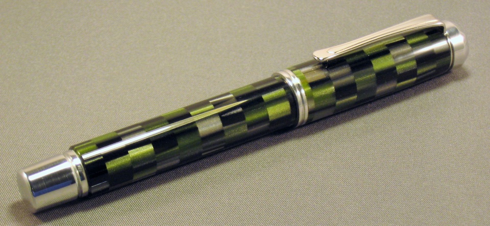

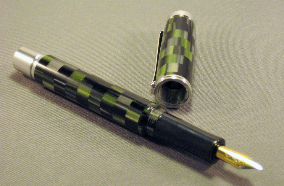

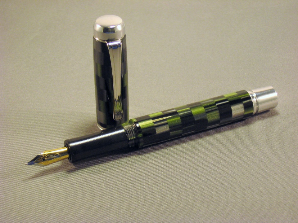

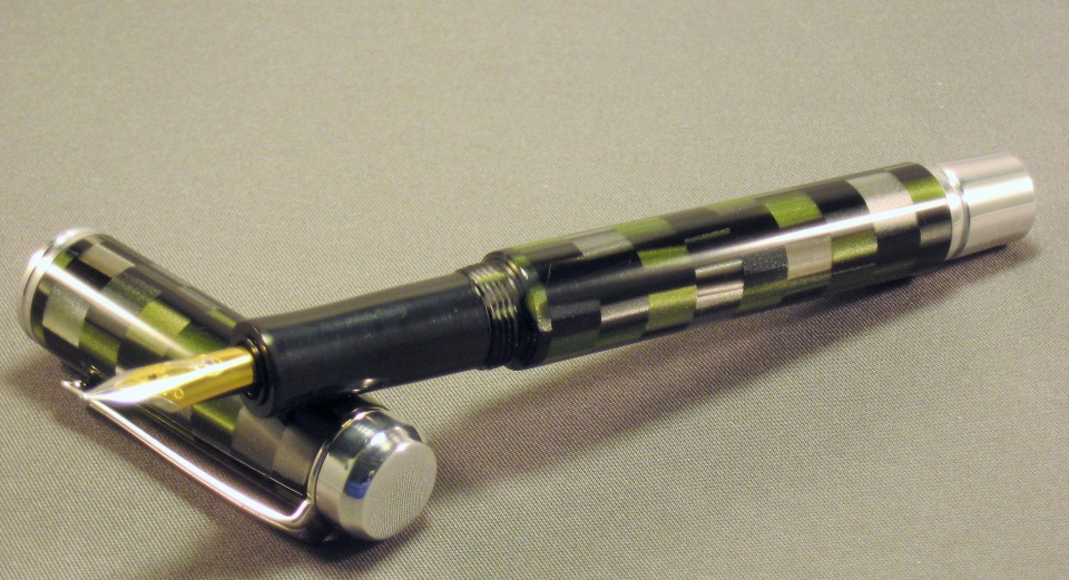

It's been a long time since I posted a pen here. So, I thought I would use up some of this aluminum stock I have. Also, not going to be calling these pens kitless any longer since, the parts pretty much DO make up several COMPONENTS. With the exception of the clip, nib and, feed. The blank is a Green Mosaic, the components are aluminum (except in the UK where, it is Aluminium) :biggrin: Thanks for looking!

I'm sorry, but there are too many flaws in that pen to post it. I suggest you take down the pics and send the pen to me for some extensive repair. It might take a couple of years to fix everything . . . .
That is superb Chuck! Beautifully made too!!:good::good::good:
However, it's only Americans that spell aluminium incorrectly.......:wink::biggrin:

Nice pen Chuck. I like the style of the aluminum parts that you made. Not sure what the definition of kitless is but it seems since you made all the parts?

Great pen! The aluminum components turned out really nice. I was just wondering why I hadn't seen this type of kitless before.

I love this pen!!!! The mosaic with it's understated grey and black tones ties in beautifully with the components you made.
Hmmm...missing something though..usually more prominent in the center area of the pen sort of at the lower end of the cap...lol
Just kidding... Perfect as is...a more prominent center band would distract from the beautiful mosaic. It's truly a gorgeous pen and I wish it were mine!!!

Looks great Chuck! Very nicely executed "components".
How does the aluminum to acrylic threading feel when capping the pen? Any concerns with a cross thread with the aluminum cutting it's own threads in the softer acrylic?
Thank you Carl. So far, there has never been a problem with starting the threads. I'm sure it could happen but, so far the threads start perfectly smooth.

What do you think of a front section made out of aluminum? Serious..no joke!
Doc:smile:
I considered that Doc. When I made a BP pen with aluminum section, I thought it would be nice to make a FP section the same way. Unless it has a coating of some sort, it will turn your fingers black. I don't have a powder coat system and, tried a poly coat but, when I started sanding it, peeled off the section. Haven't tried clear coat yet. So, maybe in the future, I'll try again. Made this section with a PR or alumilite blank that, seems to be pretty soft. Is a bit hazy when polishing. Don't recall where I acquired it from. I am looking to restock with some good ebonite. Thanks Doc!
Chuck! Great looking pen mate, i luv your design and material used,i was wondering the size of the tap/die you used and the length of the pen thankyou in advance.
Thank you John! I use the 12mm triple start tap & die from Mike Redburn for cap & body. The finials are 9x.75 tap & die. The pen measures 5 inches capped. Both finials are drilled out to keep the length minimal.

Anodize the front section no black rubbing off on your fingers.

I used a coating suggested by Caswell called VHT. The coating sprays on and is hard and glossy and doesn't require sanding. Anodizing seems a more practical and permanent solution. I don't know how to anodize but would love to! I want to work with steel (Damascus/Koftgari) and have ordered a foot long rod of Koftgari...ought to be interesting:eek:.
Doc:smile:
Thanks Doc. The VHT would be a simpler way to go. Although anodizing IS fun, there are steps that, require more attention. Time in acid bath, time in the dye (or not if, you want clear) current, conducive connections etc. but, the results are satisfying :biggrin:
