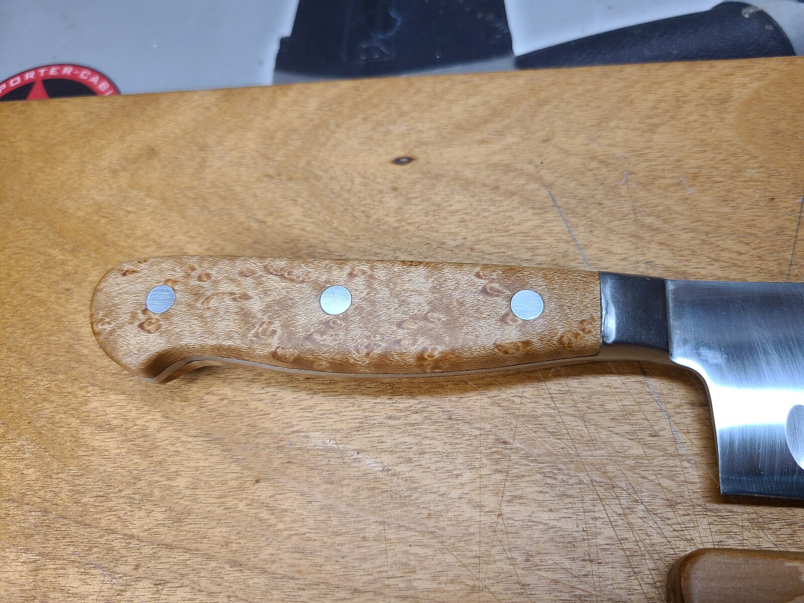

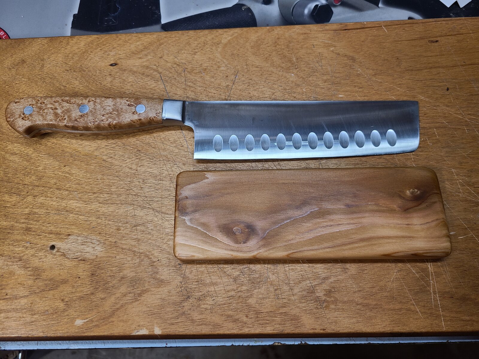

My daughter needed a decent knife to cook with at college but is a little intimidated by large chef's knives. I picked this nikiri style blank from Woodcraft and had this wild piece of bird's eye maple for the scales. Since she has no counter space for a knife block I added a cedar blade guard. Got a little over zealous while sanding and dinged the bolster but not too bad. Thanks for looking. Comments welcome.
The ding on the Bolster I'm assuming came from an electric belt sander? Might try this in the future. Tape off the Bolster with masking tape, take the wood down with a micro plane just shy of the Bolster and then finish off the fit with different grit sand paper until you just "nick" the masking tape. That way in the future if you nick the Bolster it an easy sanding to even everything out.
That is a nice looking piece of wood you used for the scales. Turned out very, very nice.

I can't get over the gorgeous figure in that "wild piece of bird's eye maple for the scales ". !!!
Thanks for showing !!!
The right wood is SOOOOO beautiful, it allows us to contribute our abilities at working that wood, to produce extraordinary items that would otherwise just be everyday functional things. Great job doing just that.

Hi Tom, yes it was from the belt sander. Thanks for the tip, I taped off the blade but didn't think about the bolster. That's a great idea about using the micro plane. I have one, just never considered using it. I really admire your knife and leather work and appreciate the help.
