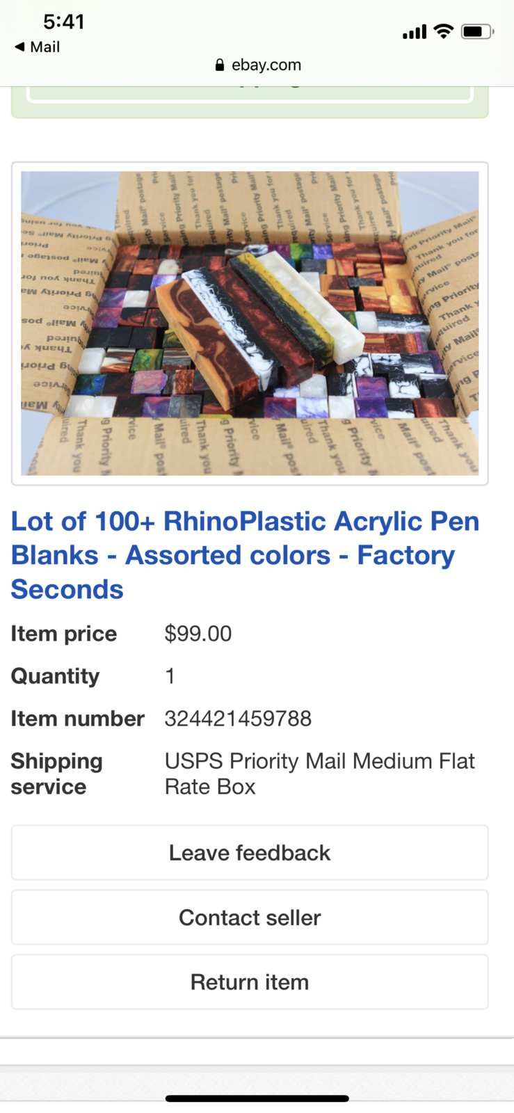

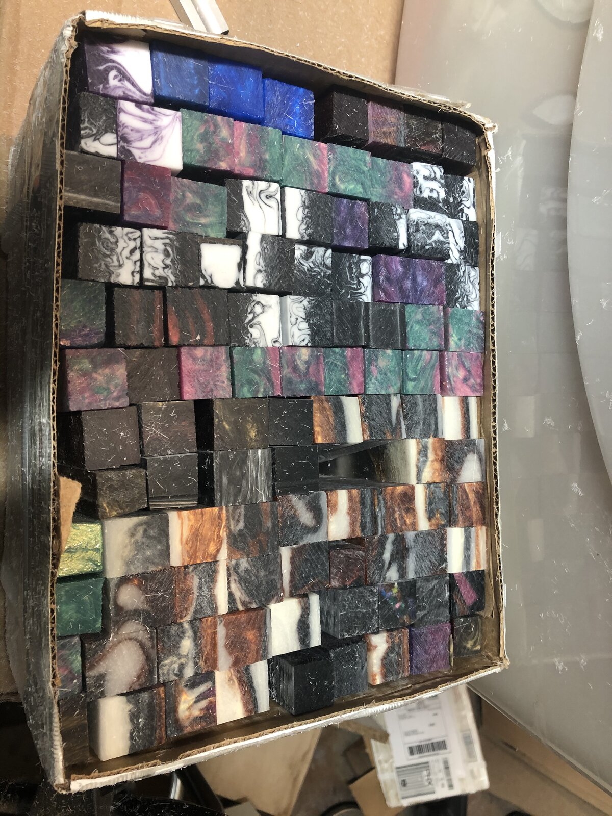

Cheap pen blanks i'm new to this so I'm uncertain if I'm doing this right but just to let everyone know I was on eBay and found some cheap rhino plastics pen blanks for sale. I believe they are seconds or do not meet their quality control standards but look perfectly fine to turn. They come in flat rate postal box with over 100 blanks for $100 Some have to be cut to size all of them seem to be over 3/4 inch by 5 1/4 there is a few doubles and triples but I didn't mind. All together in my box there was 102 full size blanks and (2) 1/4inch slivers at 5 1/4 long. Just thought I'd let everyone know if they're trying to build on a budget I want to stock up

That looks like a nice find !!
Just be careful with Rhino ..... can be quite chippy ..... especially if tools are not kept really sharp.
Take really light cuts.

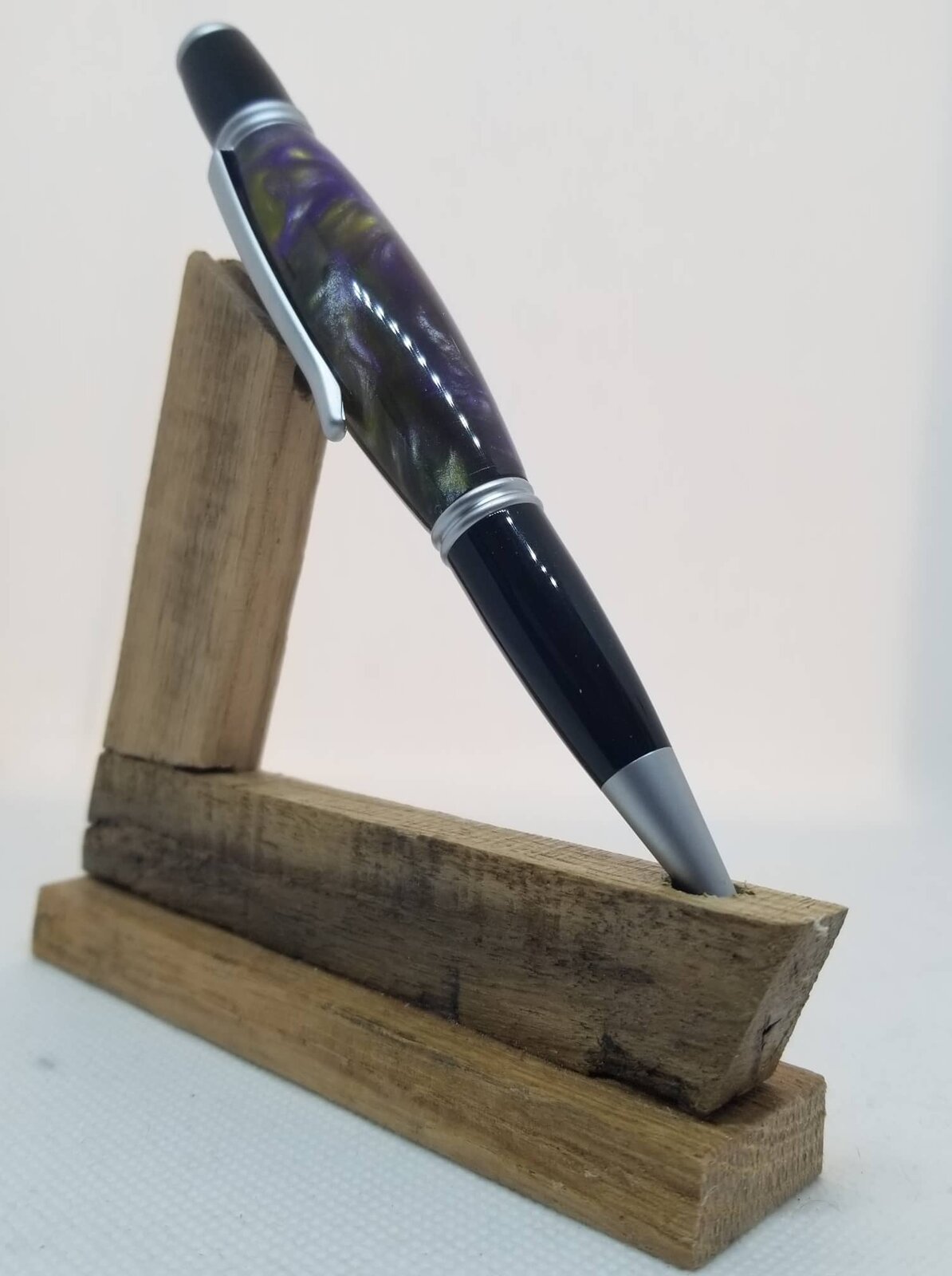

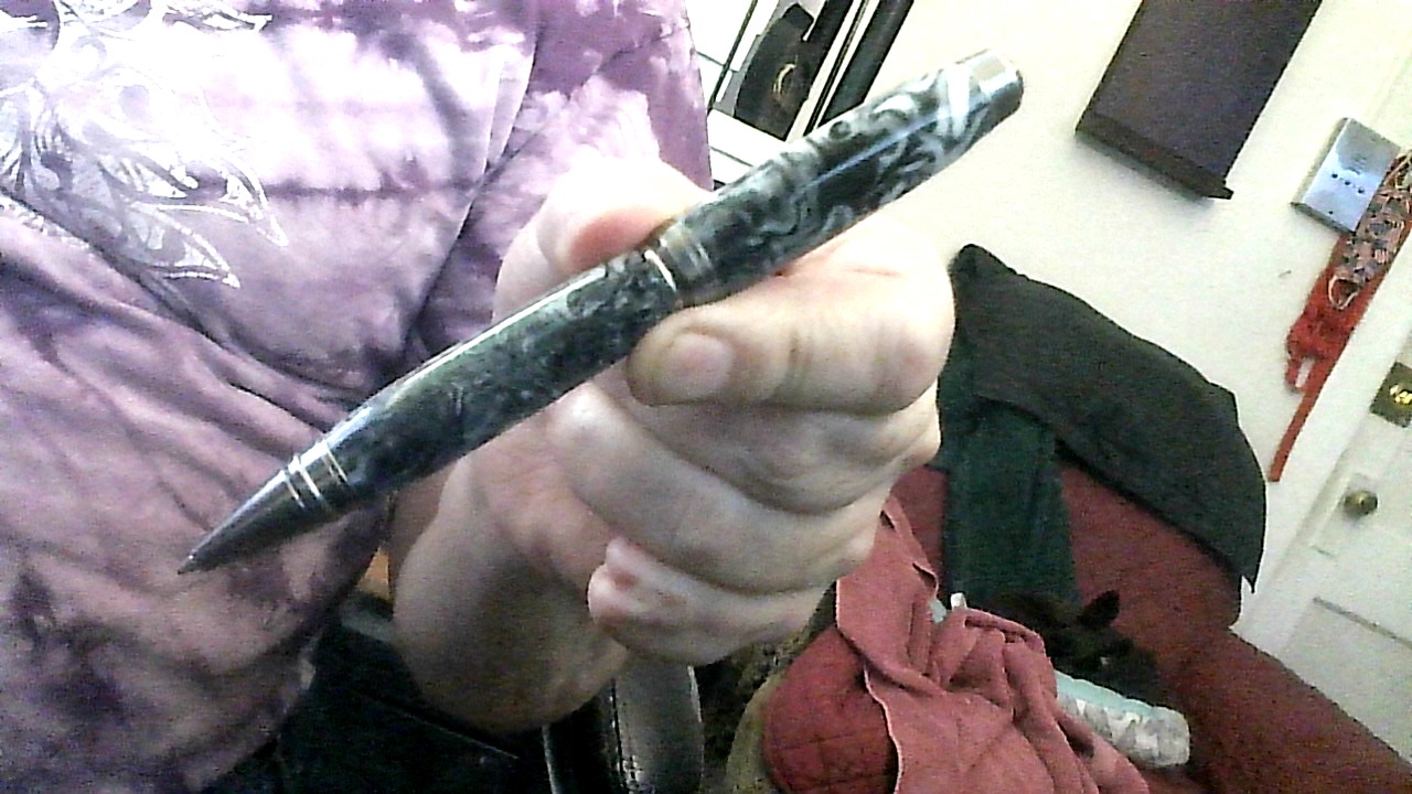

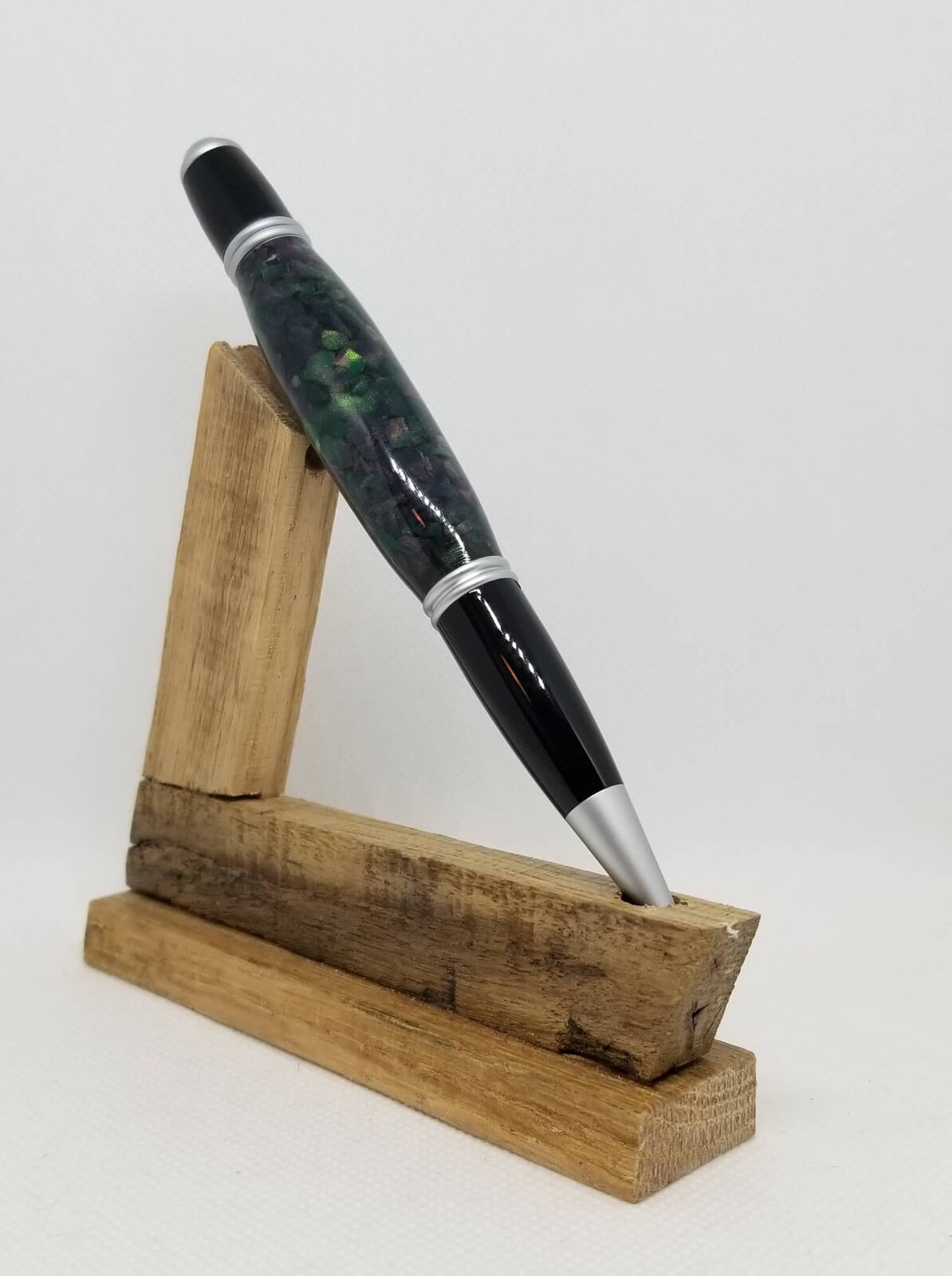

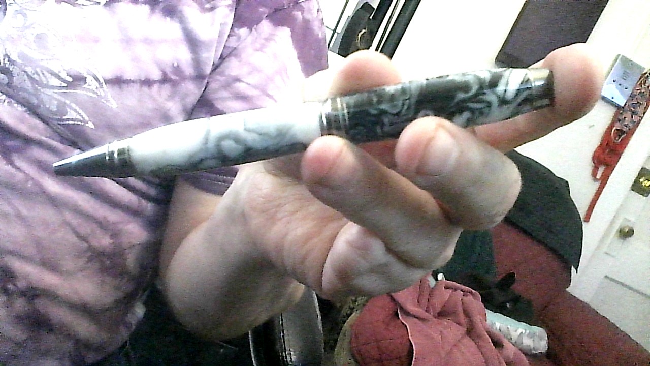

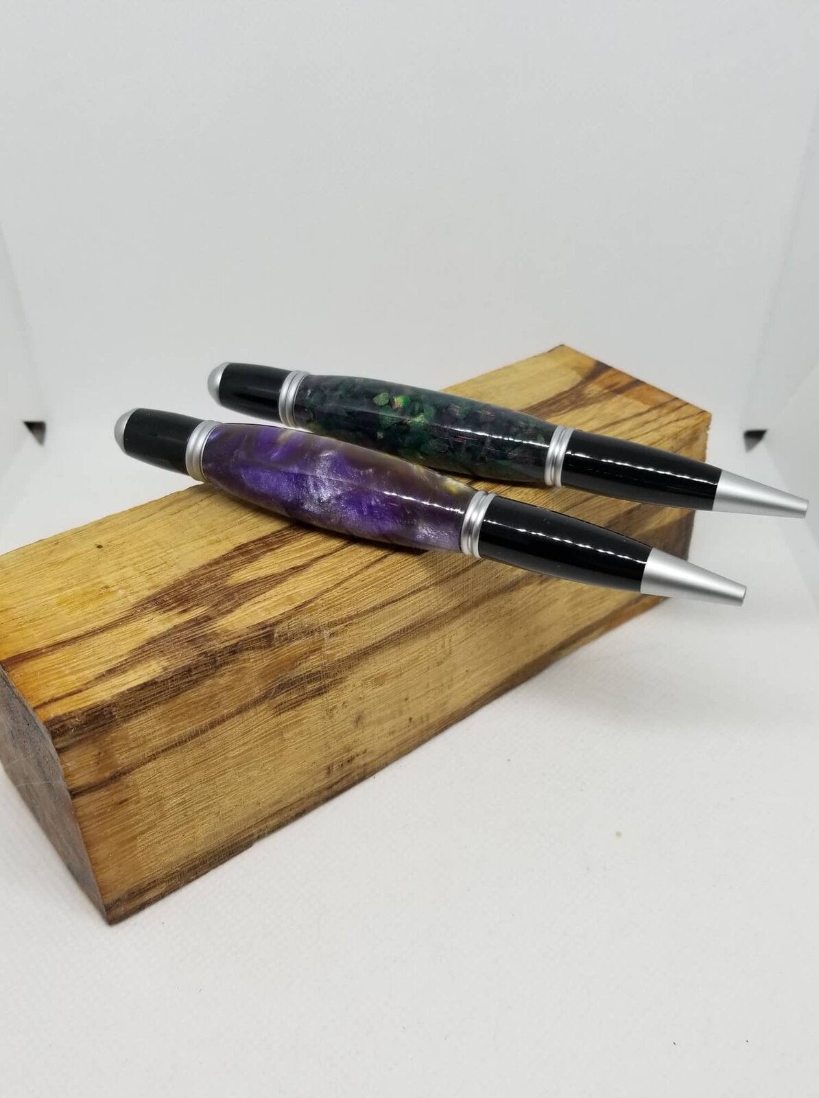

I am having great luck with Rhino Plastic. I used Rhine Plastic on these 2 pens for my daughters. I was able to complete the cigar with a Rhino Plastic blank.
