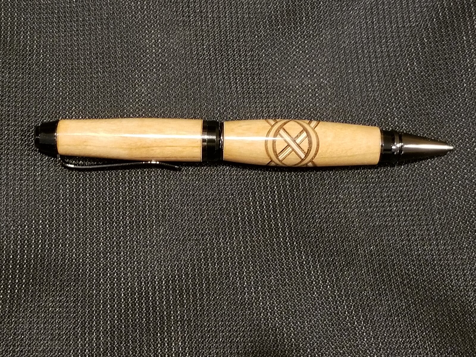

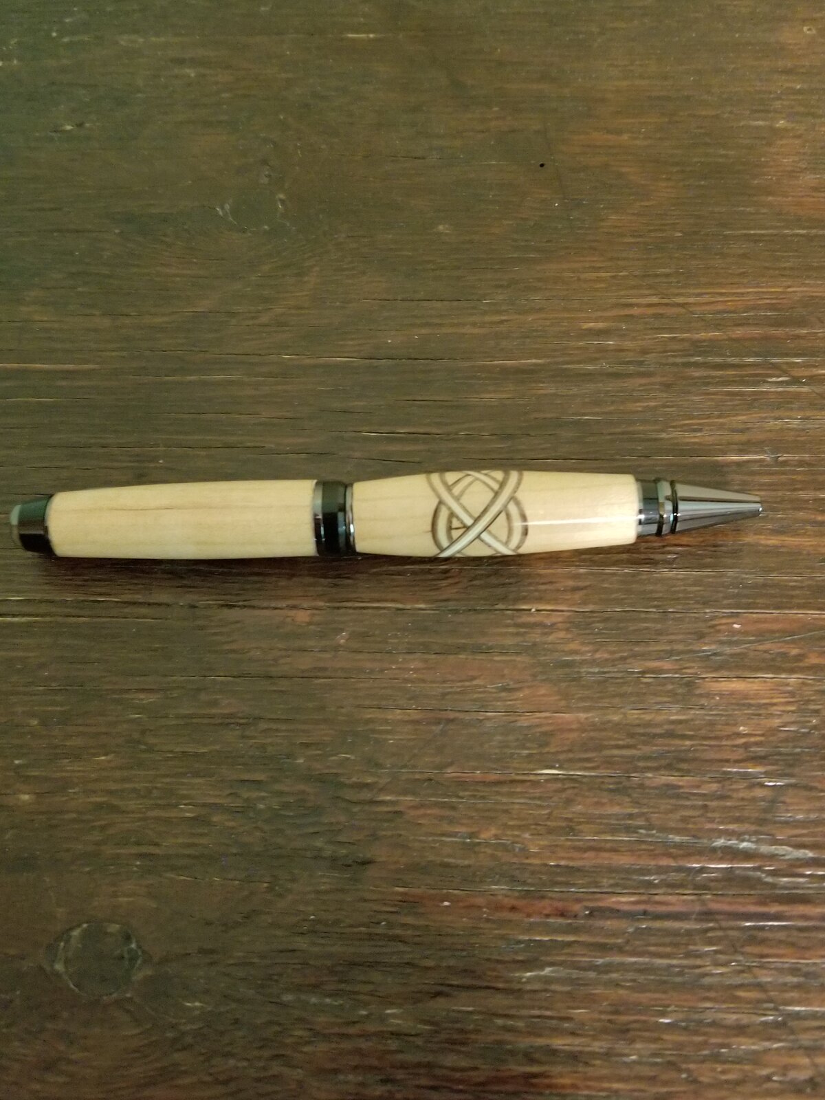

So I lied. Using the guidance I got here (thanks everyone!) I used the cut partway through method. I don't have the patience to make jig or a sled so I used the miter dohickey on my saw. Seems to have worked well. It's straight and even all the way around (good enough for government work). So the only problem with this one was I was so happy the knit was good I was afraid to turn it thinner and it looks a little bottom heavy. Like a fat bottomed Irish girl.
Wood is cherry I think. Veneer still maple and walnut but four pieces was a better fit.

Now that you did them both ways which way do you prefer?? Looks better and you are getting there. A jig will take most of the little errors out so if you plan on this it would be wise to make something quick that has a stop and hold down clamps and you will see even more improvement.
I'm pretty happy with this one. I doubt I'll make many more. It was something I wanted to try. If I was going to make a bunch I'd do a Jig to simplify the process. I have other things I want to do. Inlay is up next I think.
Looking much better, @duderubble !!! . Thanks for showing !
Does this one also have the 5-layer veneer insert like the first one ? . Looks like it does but not completely sure from the picture.
Nice job! Looks like you have mastered the "dohickey". That's kinda what it's all about. What works for you! You'll get great training and advice here, but when someone starts talking "micrometers and microscopes" it starts to lean away from woodworking....in my opinion. There was alot of fine woodworking done 200-300 years ago without the power tools we use today.
Now you can see the bad thing about this method though. Now you have glue lines either because the kerf was too big or the insert wedged the gap open. I think if you get the alignment thing fixed you got better results with your first method because your edges were crisp and you had no
glue lines. I was thinking about trying your method next time if I can get the alignment right.
I tell myself because the walnut is dark no one but a pen geek knows that isn't just darker grain in the walnut. 😂
There is something interesting and rather attractive about this example ....
Looking at the picture presented, there are 4 "cross-unders" ... the 4 "straights" all cross under the 2 "loops".
What do things look like on the other side of the pen ?
Can you remember the order of your cuts/insertions ?
I would be interested to know, please ... if it's not too much trouble ... even just a verbal report would be helpful.

This is what I was talking about when you cut in order or if you cut using the opposite sides order.
Guy, what Mal is asking how did you cut the sides numbered 1-2-3-4 straight around the blank, or did you stagger 1 and 2 is 180 degrees opposite it. 3 and then 4 opposite that??

I did opposite sides. So one side then its opposite. For the final two i just picked one of the remaining sides to do first.

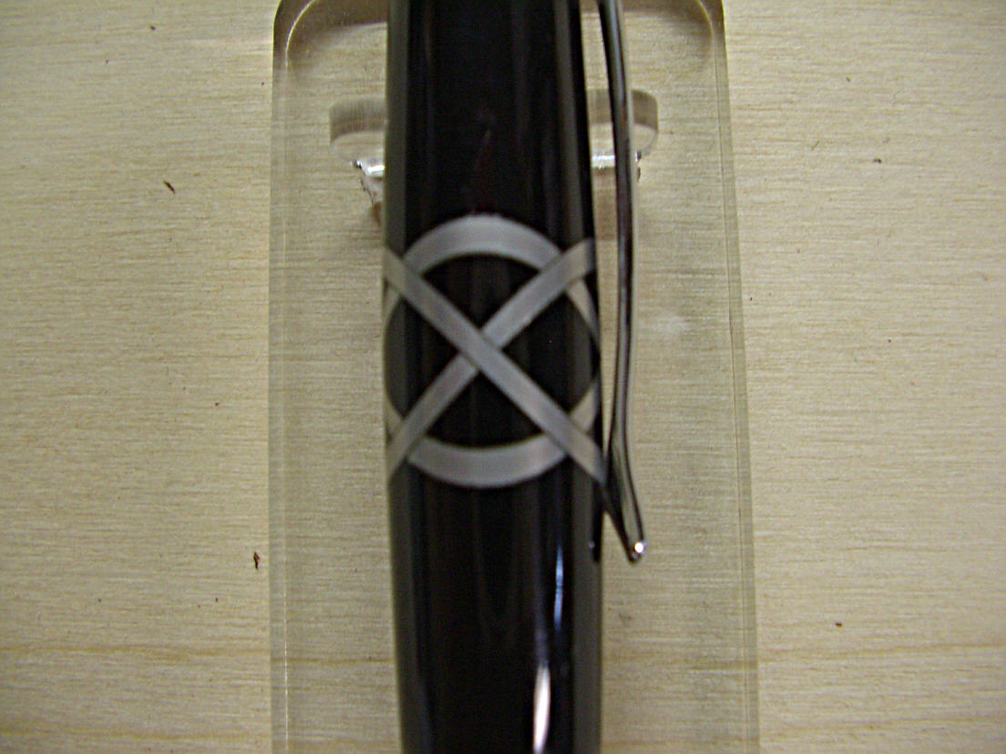

Here's the other side.

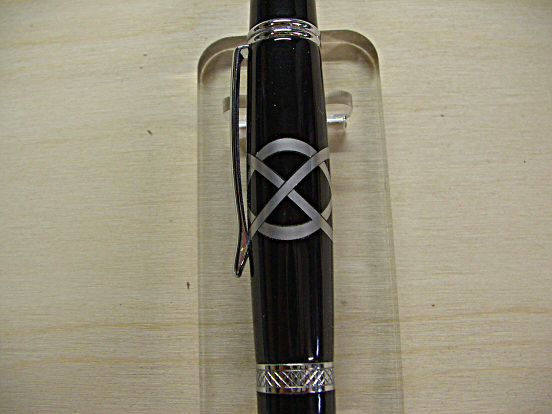

WOW !!! . I think that is fantastic .... on this side we have 4 cross-OVERS, whereas we had 4 cross-UNDERS on the first side you showed.
I VERY MUCH like that result !!!!!
Congratulations !!!! . You have achieved something that I have long wanted to actually see !!!!!

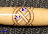

Mal this is what you see when you do that as in the same thing with my 2 I had shown on his first knot thread. the red and yellow sierra and the black and aluminum one. They are done with opposite sides. If you do in order the bands alternate.Sorry I have no example because I do not do them that way but there are examples in segmented forum. Maybe I will borrow one and show it.

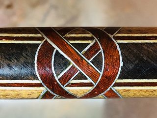

From Dogrunner who makes some beautiful knots. Hope does not mind me borrowing his photo from the segmenting forum

So, then that's not what made your original from the other day be misaligned? (cuz I still think that one turned out better overall)
The original I cut clean through on a compound miter saw. There was one more piece of veneer in the stack. I think that was the primary reason it didn't line up. I think you could go all the way through if you had a correctly sized inset and glued using a 90% straight edge. I may try it some day. More likely I'll use similar techniques to do segmenting other than Celtic knots.
But if all of the stacks were of equal thickness shouldn't they have lined up?
I agree with Andy (ramaroodle) ....
.... if all the stacks (inserts) are of equal thickness ... it doesn't matter what the thickness is ... alignment should be possible.
Yeah. I hate to keep harping on it but his first try with the exception of the alignment was perfect with no glue lines That was my pet peeve using the "don't cut all the way through" method. It's challenging and frustrating because you don't know how it's gonna end up until you're done.

I know I'm being OCD but I'm trying to figure out how to get all 3 things accomplished with some predictability and it seems we are darned close to figuring this out.
1. Alignment (gotta be the way the blanks were oriented?)
2. No glue lines (seems like cutting all the way through fixes that)
3. cross overs and cross unders (I have no idea how to make that happen consistently)
@duderubble has come closer to that than anybody I have seen. I'm just trying to figure out how to reproduce it predictably and consistently. If I'm selling the pen I can't have misalignment or glue lines. I can live with the over/under thing.
Well ... since you have bared your soul on this topic ... I will bare mine, also being OCD . .
I cannot live without understanding the over/under thing and getting it the way I want it ... reproducibly. . Can't stand random over/under.
The alignment should be possible whether or not you cut right through ... by matching grain patterns after each ACCURATE cut .
The glue lines ... important to minimize, I agree on that. .
BUT .... Cutting all the way through .... or not .... should not be a factor for this .... as long as it is done accurately which includes SQUARELY.
Agreed. It's my experience that the glue lines are a result of the inserts not being EXACTLY the width of the kerf, which is almost impossible to do when the inlay is made up of thin veneers which really aren't uniform. Too wide and you get a gap and too narrow you get a glue line because the kerf gets spread and pinched. You can't really change the width of the kerf so it's the width of the insert that varies and is hard to match, which is why I like the look of the "cut through" method.
I also cannot live without knowing what causes the over-under thing and how to repeat it. All would be good with the world if I could figure it out. :cool:
Got it, @ramaroodle !!
Thanks for elaborating !!
Not that the "cut only 90% of the way through method" is going to solve it ... you still must adjust the veneer/whatever thickness as best you can.

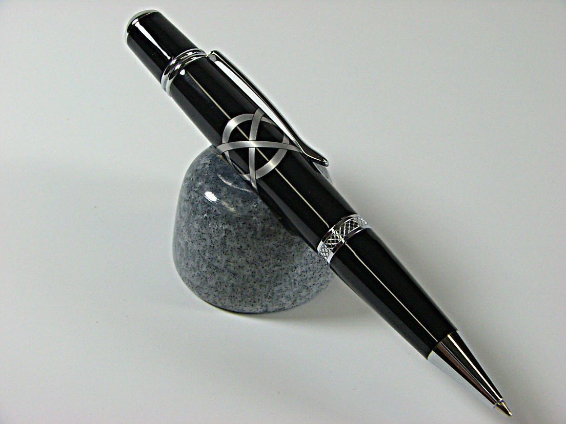

Andy I quickly went in the shop to take a photo of both sides to that black and aluminum pen which I still own so able to do it. Now I did not clean dust off or focus very well because I just held the camera instead of getting tripod. So sorry for the fuzzy photos but my point was to show the layout of the loops. I do all my knots the same way with 1 and 2 opposite each other as well as 3 and 4 opposite each other. So this is the look I think you are after.
