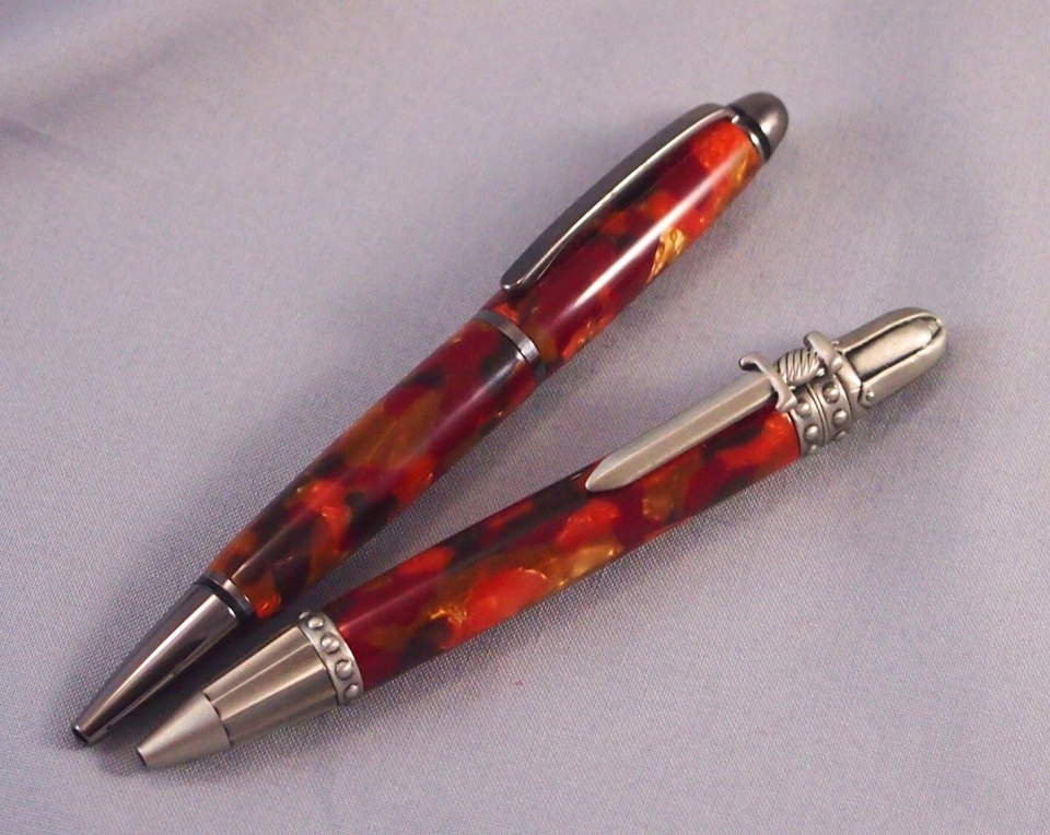

I bought a slab of vintage cebloplast from SteveG a while back and finally make a couple of pens from it. It polishes up very nicely. One was my entry in the Pretty Resin contest.

Very nice! I love the final appearance of cebloplast but it’s not always fun to work with. Found it to be easy to melt it it gets hot while turning. Definitely worth the troubles.

Definitely have to drill very slowly, even with that I had to clear the bit often.

I would spray some Pam on the drill bit, and into the hole being drilled. That was after having a blank of Ceblo literally melt onto the drill bit. I had to break the locked-on blank off the bit. Obviously not a good pen making day. :frown:

Cody,
What kit is the upper pen, please ? . It seems to have a very substantial clip ... I just noticed the clip and I find it very attractive.

I too love working with this material. They make some nice pens. I too wish more of it was available. There are some cool colors out there. Never really had a heat problem with drilling or turning but again I do things a little slower. Just never in a rush. Thanks for showing.

Glorious Pens Cody,
Amazing Cebloplast Blanks, Stunning Colours,
Beautifully Turned, Fitted and Finished.
Love your Choice of Hardware, I have not seen Curvado Twist Pen before, and with the Knights Armour, Both look Terrific with this Spectacular Blank.
Thank you for Posting,
Splendid Pens Cody.
