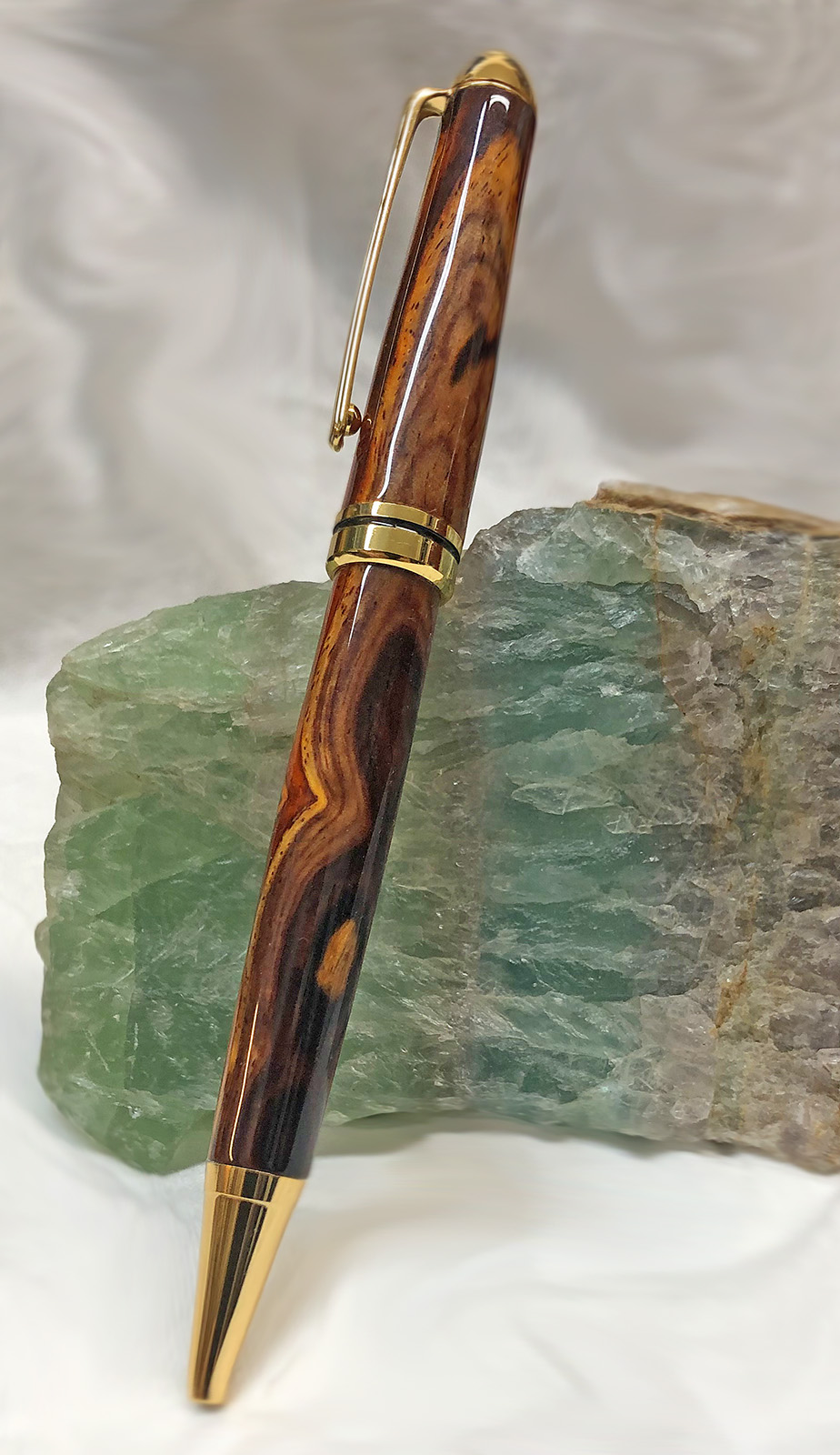

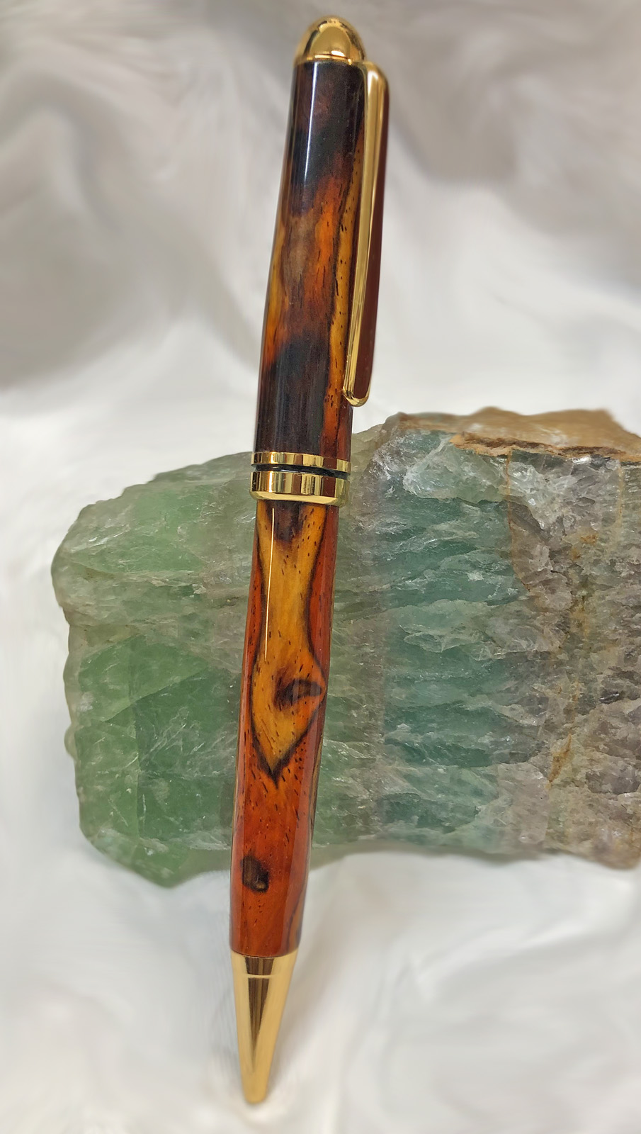

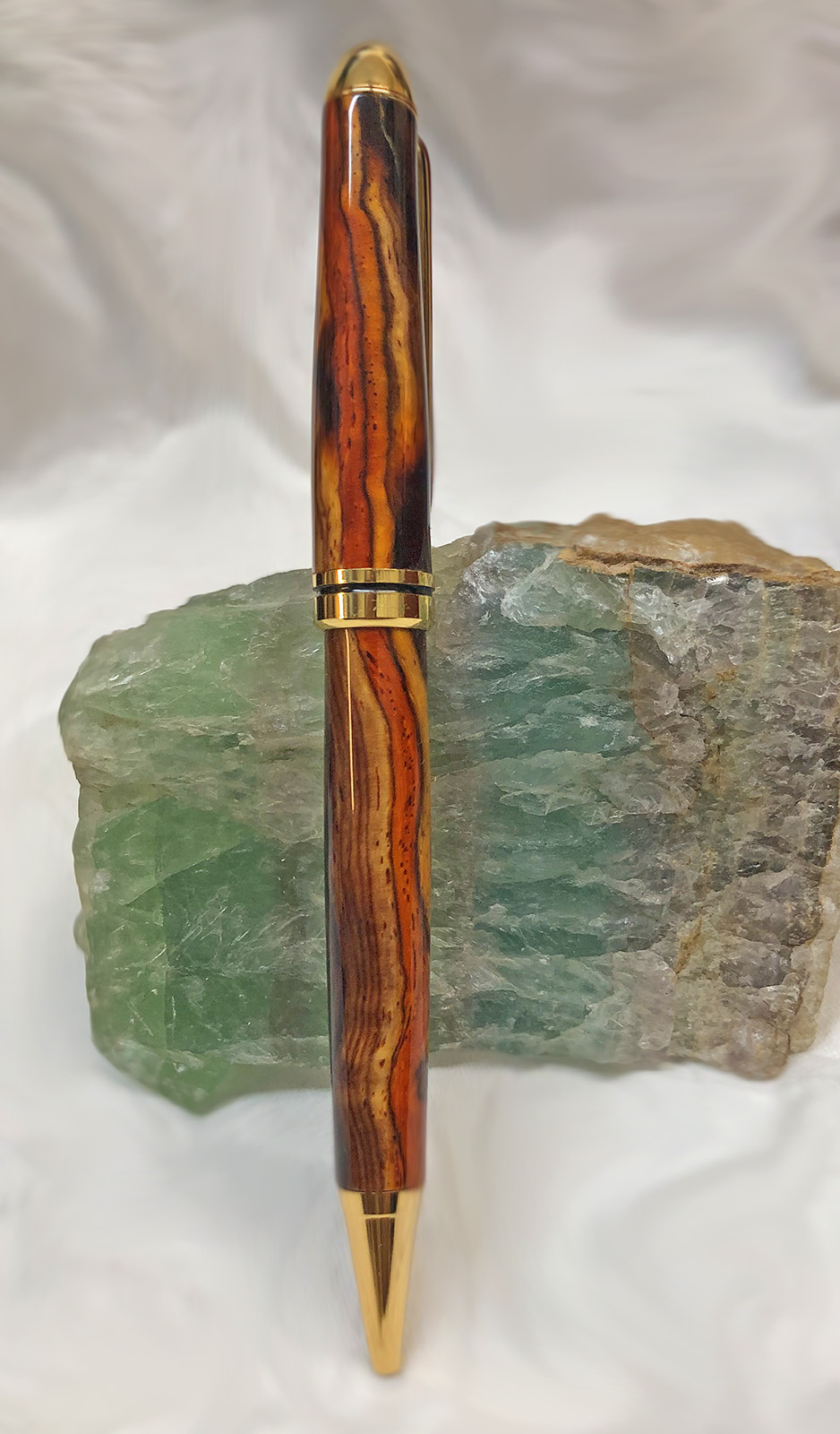

Update: I was successful in turning it this morning; however, after sanding I noticed a couple of spots that definitely look like some kind of bark inclusion or something - very porous looking spots not near the repair area. I have some medium CA on them right now so I will go back and re-sand in a hour or so. It might make a pen yet.
Dave
It did make it into being a pen, but because of the catch I'm afraid it will need to go to my "less than desirable" collection. I still think the wood was quite pretty. - Dave

Very nice. I don't mind inclusions in my blanks. I think they give it character. Many years ago I was in the leather goods business with my brother. We had just visited a customer who had a leather covered counter top for their cash register to sit on. In the middle of it was an "ugly" scar. I suggested that we offer them a new leather cover without any blemishes. For the next hour I got a lecture about design, contrasts, character, and relative perfection. That's a beautiful blank, IMHO.
